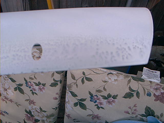

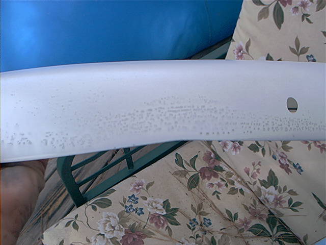

HELP Mike,
I have sanded,cleaned sanded asitone sanded,windened sanded, thinner sanded sanded an cleaned an cleaned an cleaned, An the paint just will not stick to the belly pan in places. The canopy did great,. It looks like what I use to call fish eye.What else can I do?

Try a different batch of paint? Sure looks like surface contamination, though.

Did you use soap and water? The release agent is water based, acetone only removes petroleum based release agent. Denatured alcohol works well too.

This is the bad part about trying to do a build thread, and write instructions when you can't remember every single detail (I'm taking notes though!)
Post 333:
"Trim the scoop as shown. Wash with soap and water and alcohol thoroughly, and rough up the mounting flanges with 80 grit sandpaper. Clean again. "
Not sure why I didn't mention that in the beginning, I plead guilty to assumption. It's sort of standard practice so I didn't make a big issue out of it.
But to clarify on the composites:
Wash ALL parts in hot water and detergent of some kind. Rinse and repeat a few times to be thorough. After it dries rub it down with alcohol. Although I have used acetone before, I prefer a good automotive wax remover and degreaser. If in doubt, wash again and again.
Sand lightly and prime well. leave a thin layer of primer on the composite part before painting.
And just to make clear, right off of the label of the release agent we use (as well as wax): "Wash cast parts with hot water and detergent before attempting to apply surface finish. Several washings may be necessary depending on amount of release agent used".
Just so you'll all know what I'm reading too. I do it automatically and I could have SWORN I wrote that somewhere either here or in the instructions (which are getting revamped by the way).
My apologies.
-Mike

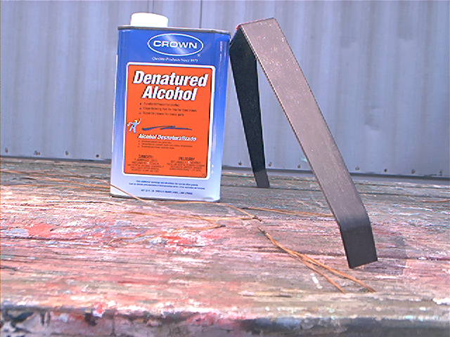

Me ,this belly pan an this Monticote paint are about to start world war 4. Plus Central Hobbies no longer have the y shaped motor mount for the 140RX. It will be as you say Mike the ugly mount with the stright neck, it looks just like that mount but for the O.S.

ORIGINAL: wlcornelius
You're kidding!!!!!!!! You gotta post a pic of that mount. I can tell you right now, I don't like it. Never seen one like that before...
Is that lustrekote you're using? I've seen mixed results with it. I used it once, never again on anything except maybe ARF wheel pants.
So did you clean the part with soap and water, or just acetone?

That is something I most of the time don't do, follow directions. How ever this time I did to the letter an more. My wife asked me what I was fixing to do, told her I was giving this thing a bath in hot water an dfifferent det. NJext step is the gray auto primer, after that I don't know. An on moter mount will post pick in couple days when I get it.

It's definitely a chemical reaction of some sort. Since paint usually doesn't hate epoxy, it has to be a reaction with something else. Could be the mold release was heavier than normal. I'm not sure, I haven't had that problem, and have yet to hear of anyone else having that problem. It's possible the Lustrekote is contaminated. Unlikely, but possible.
Let me know how it comes out. if it comes down to it, I'll send you another belly pan (scrubbed clean before it leaves, then you do it again...)
Also I'd really like you to post a pic of that mount when you can. I still can't believe that...

I had that exact problem once before, but it wasn't a problem with the part or lustrekote. I was spraying primer on a plug and I had water in the system. It did exactly the same thing.
Just troubleshooting...

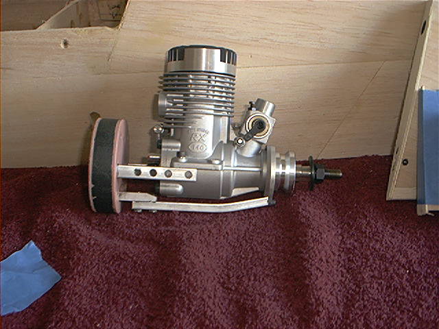

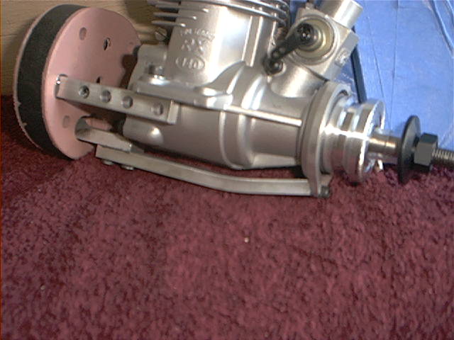

Mike right now I don't care how ugly you say that mount was, This one is a dream come true, Just joking. The nose ring is about a 1/4" shorter an a perfect fit Can grabe engine shaft an no matter how I pull or twist there is no movement to say of.

Well cool, I'm glad you got that worked out. In the papers/package that came with that mount, what is the exact model number? That's just bizarre. And if you feel like weighing it, that would be great too.
-Mike

The scales I have are used for weighing 100lb. feed sacks with, That # is HCMO140ARIA.

How about a picture of the front of the mount? I have an ARIA and it doesn't look much like yours.
Thanks.

It dos'nt. Acording to Central Hobbies they dont make the folked type anymore

Thanks,but how is the Nose Ring attached to the aluminum support? Your picture seems to show only one bolt.
And if two bolts do secure the nose ring,the nose ring must be configured differently.
A frontal picture sure wouldbe nice.

Would you believe JB weld?
