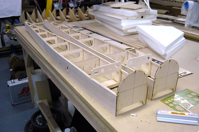

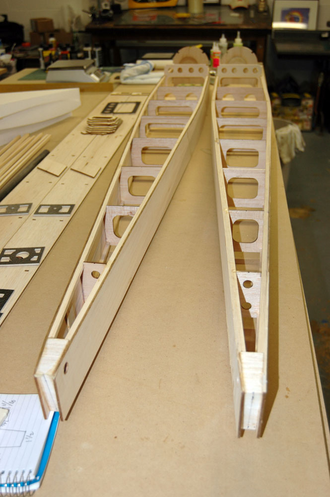

Hey Pete,
here are your two matched fuse boxes!
I'll get the flooring in and get some weights, but they are looking good. It took me about 5 hours so far to build the two fuse boxes from the kit parts. Pete's Custom RC Jig is really great to use and along with any laser set up it's easy to get it straight.
The VF3-X is starting flight testing down in Ocala, FL this weekend, I am on pins and needles.... can't wait to hear the flight reports. I've got my VF3 build ready to go.
cheers all!
Dean

Pete's fuses came in at 10.2 oz and 10.5 oz - a matched set....

Dean,
Just got back from Disney....WOW those not only look great but the weights are FANTASIC. Thanks for the nice words about my jigs.
Now I just need to pull my vacuum bagging gear out and get all the foam sheeted. I can't wait have a pattern plane back since I sold my Focus to get my Black Magics.
I always wanted a matched air of planes.
