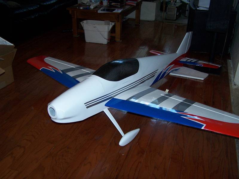

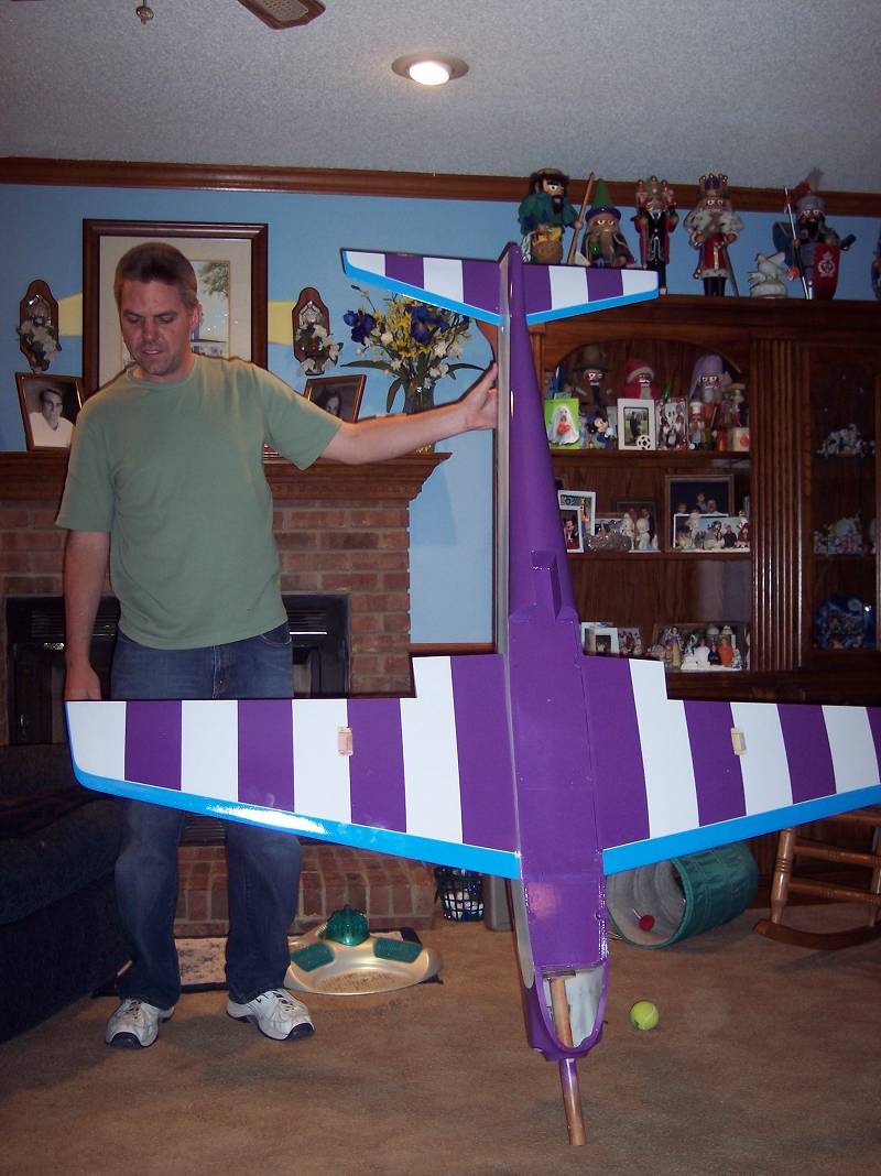

Well after 7 months I finished building the BM. All that is left is to install the radio gear and motor. Well what do you guys think?

Old 04-03-2007 | 03:36 PM
  #1057
MHester's Avatar
Posts: 2,707
From: Woodstock, GA
Default RE: Black Magic v2 builder's thread! *Updated*
Awesome!!!!!!!!
For somebody who had never built a plane before, how did you find the build?
-Mike

Man, that is sweet!!! How much does it weigh? So far mine is amazing the heck out of me. It looks BIG but it's so light! I should be able to post some more details in a day or so. Real busy now. I have a cool wing retention method that seems to work really well. I'll post some pic's of that too.

Looks great Tony!

The build was very easy. I had it built months ago but not painted or covered. I have only built arfs. The plane looks way better than any ARF I have bought. I used a one of a kind of jig for the build. The jig is only set up to make BM fuses. I would have to make another jig to build a different plane. The hardest part of the build was trying to make a decision on the scheme. You have one easy building kit Mike. I have not weighed the plane as of yet, but I am sure with radio and engine it will be way below 11 pounds. I did not use contest balsa, but I went to the hobby store here in town with a scale in hand. I used mike reccomendations on the weight of the woods. I then selected the lightest. Some of it was less weight than Mikes reccomendation.
A lot of the wood was contest balsa weight but a lot less price. so For those who have a hobby shop that sells balsa, take your scale with you and select the lightest woods based on Mikes recommendation. I can not believe I have 9 hours in covering both stabs and 11 in covering the wings. Painting the fuse took a lot less time

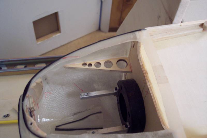

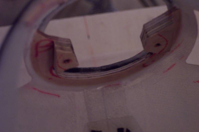

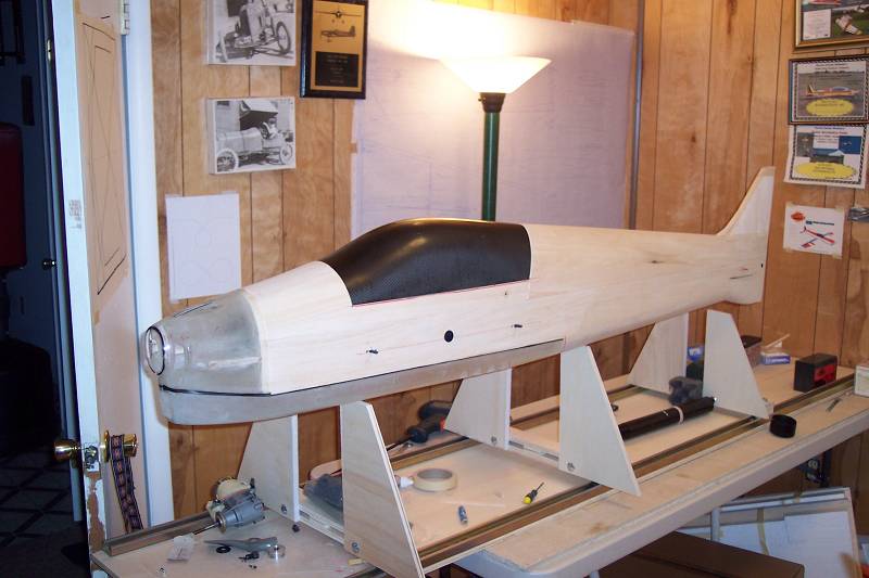

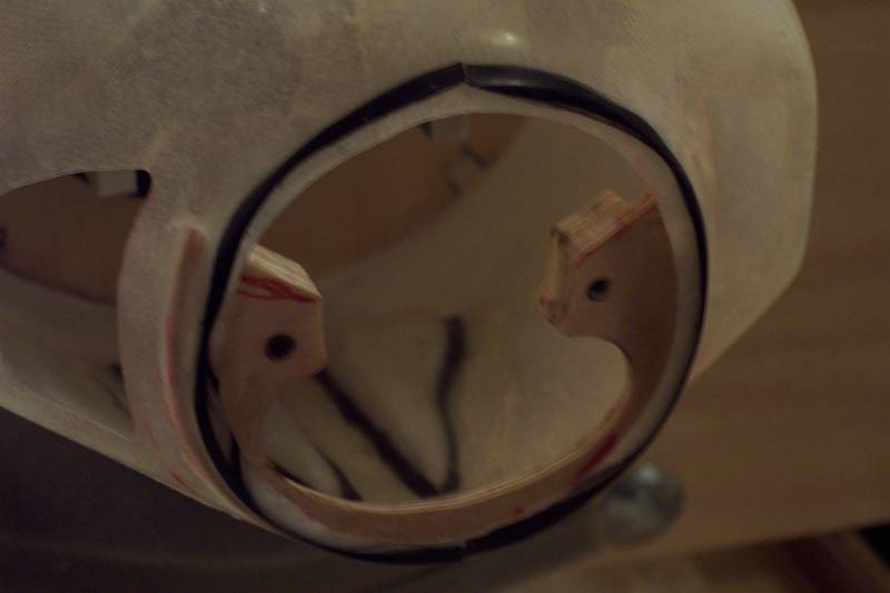

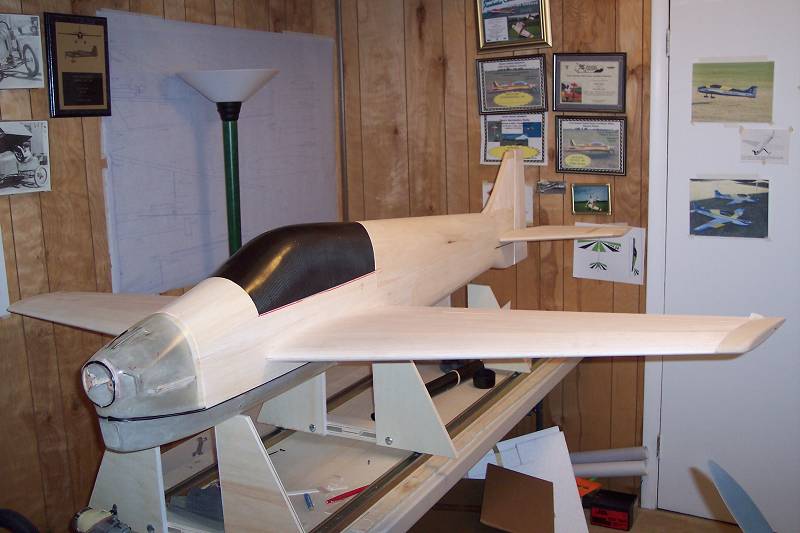

Ok, I am well behind my goal but the big stuff is finally done. Finished mounting the canopy to the frame on Friday and all that is left is everything else.
Also, have some cowl details showing the bracing and nose ring mount. Jon had a great point a few posts back install the nose ring before you make the holes in the cowl.

Looks cool Anthony, great job!!
Make sure and glass that nose ring former in with 4-6 oz cloth, or carbon. Looking good!

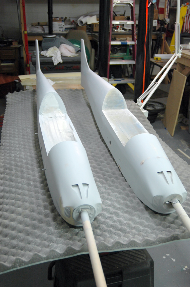

dang this weather...
all ready to paint a couple black magics and it's raining !!!!

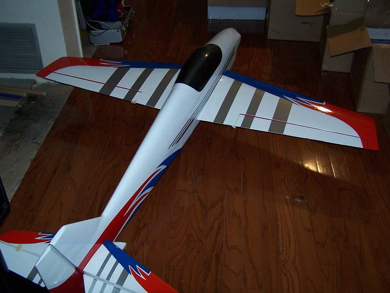

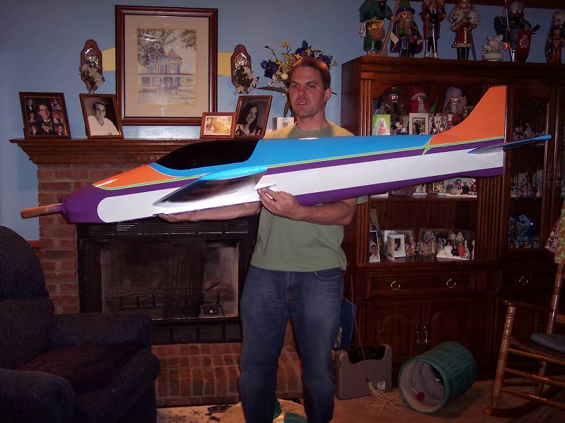

Just thought I'd share my finished Black Magic V2. Well almost finished, I couldn't wait to put the ailerons, elevators, and rudder before sharing!!
Rick

Nice Rick, send me a PM with your mailing address and I send you some graphics for the fuse...
