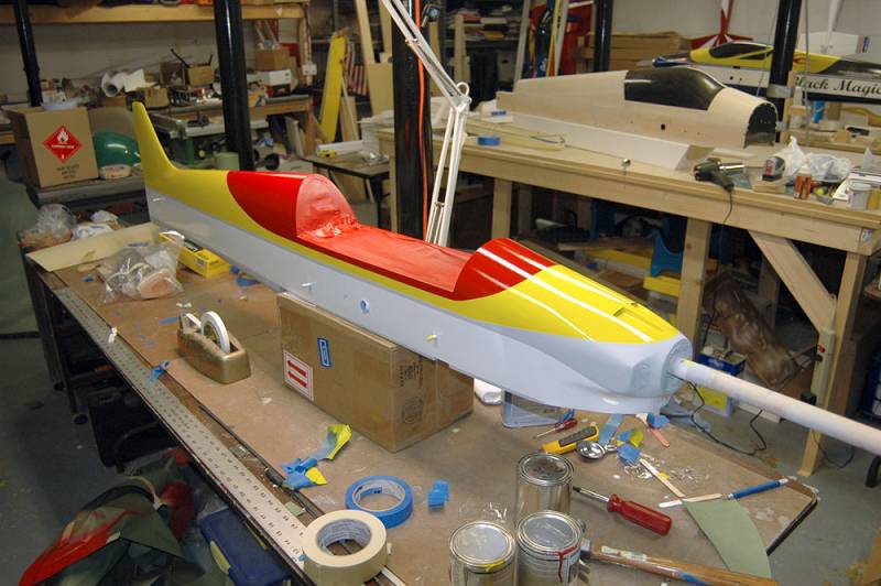

Default RE: Black Magic v2 builder's thread! *Updated*

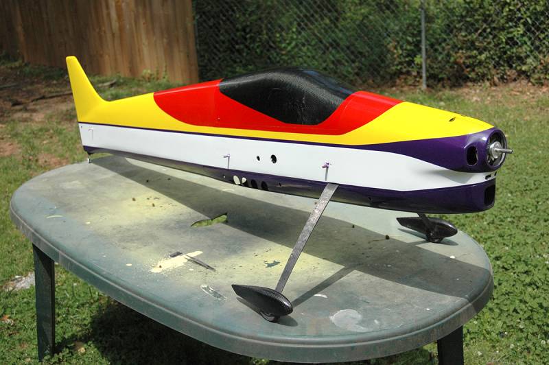

Hi all,
the weather has improved this week and I've been busy painting the last couple of days and nights...
Looks like some lucky bloke will be picking up his new electric V2.2 this weekend !!!
I am shooting the purple nose stripe tonight and buffing this baby tomorrow night. Love that DCC...
the only downside here is my VF3 build is sitting on the sidelines this week. I have the fin/rudder ready to install. And I am waiting on a AR-80 to come from Merle so it's in a slight pause. I am also waiting on one elevator servo.
A note on the Vinyl Graphics offer...
I am indefinitely extending my offer for free fuse side "Black Magic" graphics, What I have in stock is in Black Carbon Fiber vinyl and is 2 1/4 inches tall and about 22 inches long. I am sending this out first class mail and I am only asking for you to return the postage. Just send me PM at deanfunk1(at)yahoo.com.
I am also offering full graphics packages with all the stuff you need, ama numbers, pilot name, dragons.... etc etc.... at super reasonable prices. Just let me know what you need and I'll cut it !!!
cheers all,
Dean

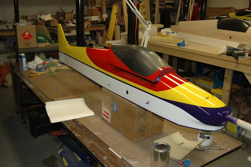

Old 04-19-2007 | 09:26 AM
  #1083
handglider's Avatar
My Feedback: (23)
Joined: Mar 2005
Posts: 1,097
From: ,
shot the purple last night...
will be wet sanding and buffing tonight
all up weight of paint is 1.35 oz
Old 04-19-2007 | 09:59 AM
  #1084
Joined: Apr 2005
Posts: 2,428
From: Calgary, AB, CANADA
Dean,
That looks fantastic! Gorgeous combination of colors and the weight is superb. Did you mention somewhere in the thread what you are using finishing and paint?
Mark
Old 04-19-2007 | 10:54 AM
  #1085
handglider's Avatar
My Feedback: (23)
Joined: Mar 2005
Posts: 1,097
From: ,
HI Mark,
I am using DCC concept. I am shooting with a Sata Minijet 4. I laid down 4 coats of each color, tonight I'll be wet sanding with 2000 grit paper and using the 3m perfect it and finness it buffing/polishing componds.
I am wanting to get to that super wet look.
I am impressed as well, with the primer coat I should end up at around 3 1/2 oz total with primer. All the color is only at 1.35 oz. The purple belly and nose strip only added .25 oz.
I almost don't believe it myself, I do have a great digital scale and carefully checked weights all along the way. I can't wait to get home tonight and start the wetsanding and buffing process. I still have to shot another coat of red on the canopy and purple on the belly pan.
I'll post some finished pics with graphics friday...
thanks,
dean
Old 04-19-2007 | 11:47 AM
  #1086
petec's Avatar
My Feedback: (58)
Posts: 2,078
From: Beaver Falls, PA
So that is 1.35 oz for the paint. Does that include the glass, resin and primer? Just trying to get a bead on the weight difference between glass and paint and monokote.
Old 04-19-2007 | 12:10 PM
  #1087
Joined: Apr 2005
Posts: 2,428
ORIGINAL: handglider
Thanks, Dean. I just did a quick search and that looks like 2 part auto paint, right?
Because I'm lazy and can't recall your glassing details, did you use epoxy for your glass or water based paint?
Thanks again,
Mark
Old 04-19-2007 | 01:37 PM
  #1088
handglider's Avatar
My Feedback: (23)
Joined: Mar 2005
Posts: 1,097
From: ,
HI Pete and Mark,
It's the 2 part automotive paint that Radio South sells and you can also get it at your local PPG Automotive paint stores. If your not familiar with it- it is really great stuff. It part of a full line of finishing products including primers, and clear coats. Tony does mono/ultrakote matching and it is easy to work with.
This is actually a plane that Mike Hester built for a customer, and the plane is set up for electric. Mike went way out and put together probably the lightest electric v2.2 built to date. Mike did the fiberglass work with epoxy, I think he used west systems and .5oz cloth. He also brushed on the first coat of K-36 primer. What he told me is he brushed on 3 oz of primer.
I took the plane from there and sanded off about half the primer using 220 and 280 grit paper. I shot a second coat of primer and sanded that smooth with 400.
It's been challenging for me to do this super light paint job, the next part of this is wet sanding with 2000 grit, buffing and polishing. There is 4 light coats of color on this plane so I am hoping I can wet sand it just smooth enough to take out the texture and then buff and polish it to a smooth high gloss....
Yes Pete there is only 1.35 of color on the plane after about 2.5 oz of primer. It's got solid coverage and is fairly thick looking at the taped edges.
I am anxious to finish things tonight, if this plane polishes out at this weight, wow -

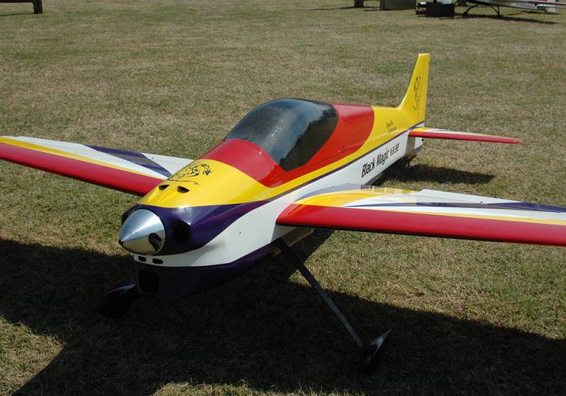

Old 04-20-2007 | 10:32 AM
  #1092
My Feedback: (45)
Joined: Oct 2003
Posts: 2,861
From: Great Mills, MD
Pete,
The Focus isnt built with the same quality of wood as the V2's. They can handle some dings as the one in my garage proves...This airplane was designed with these woods for the purpose of painting. I think even the designer will chime in here recommending glassing and painting.
Arch
Old 04-20-2007 | 01:24 PM
  #1093
handglider's Avatar
My Feedback: (23)
Joined: Mar 2005
Posts: 1,097
From: ,

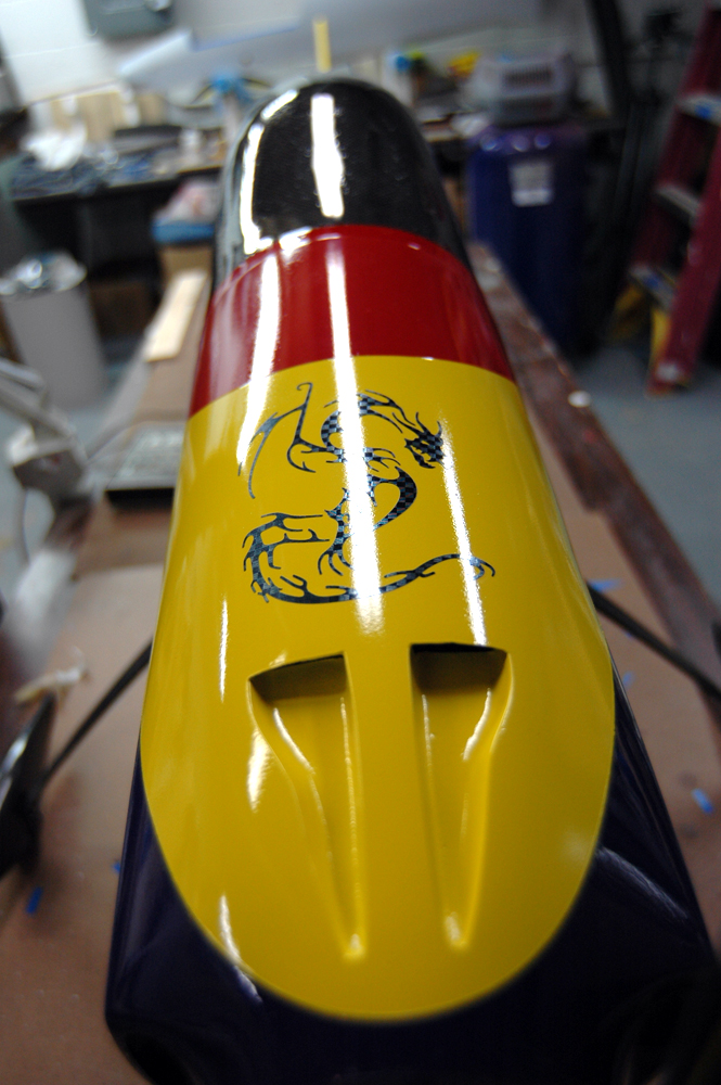

DONE....
well except for the graphics....
She is one sweet machine, I reshot the yellow to get it a bit deeper. only added another .3 oz.
Mike and I where talking that this is the best electric Black Magic to date. very light weitght.
Man 0 man did I learn a lot finishing this beast in something like 4 nights. wow, my brain is swelling... And I get to paint my build next week. I used a lot of really cool product the 3m buffing and polishing compounds are awesome. And I've gotten close and personal with my minijet now, I can flow this paint like glass now.
I am heading to my PPG store to see my paint babes next monday... need more colors !!!!!
you guys are getting to know me now, I am amped to the max here. we have a big meet tommorrow, I haven't flown or been outa my shop in a month, but I am happy as hell! It looks I can slip out this evening to get a little airtime.. I am just glad this baby is OUTTA HERE !!!!

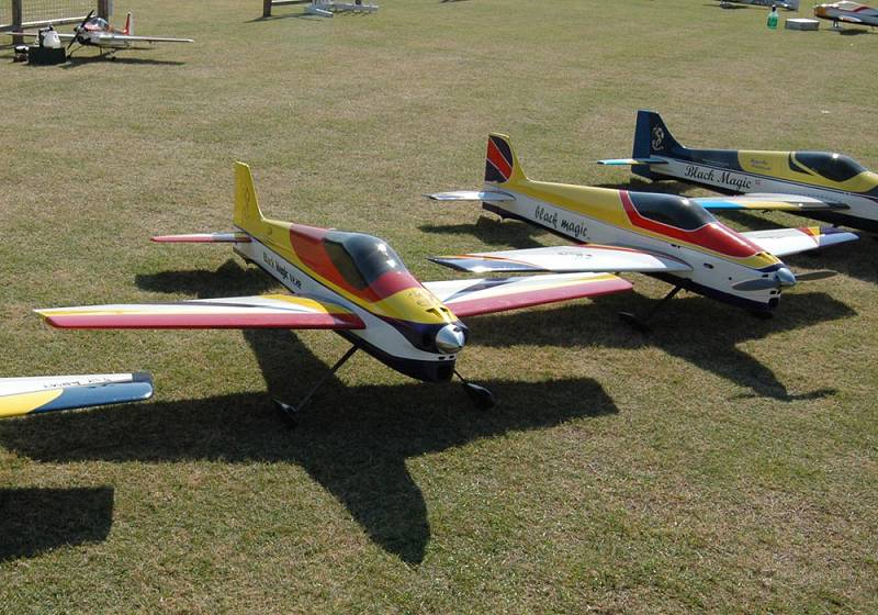

Thanks to Mike and Mellissa for a great GMA Meet this year. You guys are awesome and we all lucked out with the best weather ever at a local meet herein D3. I finished painting the red plane friday afternnon and Mike finish the final work for John, he is happy.
It was a "Gathering of Dragons"
enjoy the pics ya'll
