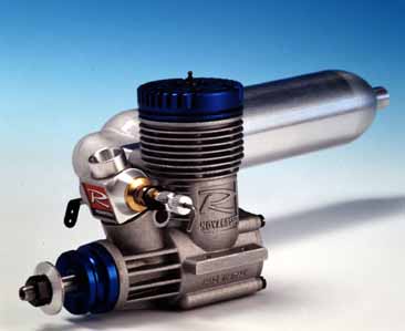

The Novarossi looks as sexy as an engine could look. Would like to hear from someone with one of these motors. I think the Supertiger rear exhaust is still available also. [/B]

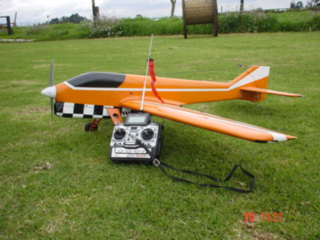

Pics of my tiporare: 56 in wingspan + o.s. .46fx + macs header and tuned pipe + eclipse 7, taildragger, rudder kevlar pull-pull, very fast, no bad habits, very accuracy.

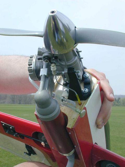

Jim....that is a sweet setup! How much does the head stick out of the cowl? The novarossi is a little taller than the OS. Did you just have to cut that notch in the firewall? What else did you do? I may go for it! More pics would be great.....

The head sticks out one inch.
Unfortunately I don't have more close up pictures of the muffler installation.
I did have to cut the notch out of the firewall, and make the tank compartment cover. I didn't find it too difficult, just a bit of ply as a sort of frame, and 1/32 inch ply to form the channel. There is enough space to put in a 10 ounce dubro tank. The tank center ends up aligned properly with the carb.
The extension is 1/2 inch. 3/4 would make things a bit less tight. The extension has the added benefit of lowering the tuning rpm of the exhuast a bit - which I view as more suitable for this type of plane. (The Jett is tuned at 15000 rpm)
Note, it is *not* tilted at a 45 degree angle. It is something less than 45. I just placed the engine over the firewall and estimated the position so that I could get the blind nuts in place before gluing the firewall to the fuse. Use a compass to draw a circle centered on the indicated engine center, and passing though the indicated (i.e. the punches on the die cut peice) blind nut holes. The location of the blind nuts for the rotated mount should fall on that circle to ensure the center does not move - if that makes any sense.

I really like it.....but the ole .50 is just too big to make it work and the ultrathrust will be too deep into the fuel tank area. Checked with the plans and didn't really like what I saw. Guess I'll just stick with the standard mounting. Maybe the idea will come in handy for a future project though.
