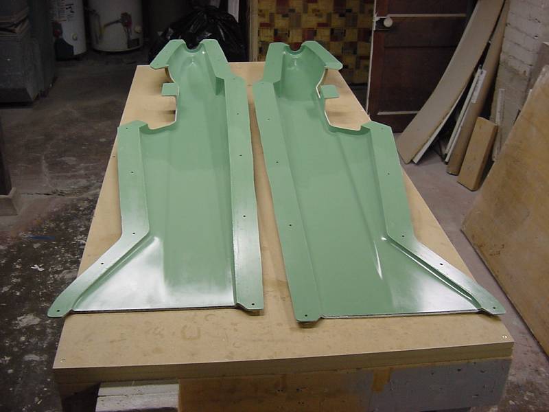

A few pics of the first half of mold construction.
1. A surface coat was put down first, which is a thick epoxy based paste I tinted green. Dark colors help you see air pockets when making parts. The surface coat provides a inside mold surface that is slick, shinny, and almost ceramic like.
2&3. First half of the mold removed from the parting plate. Now its time to wax and polish the flange in preparation of making the second half.
Todd

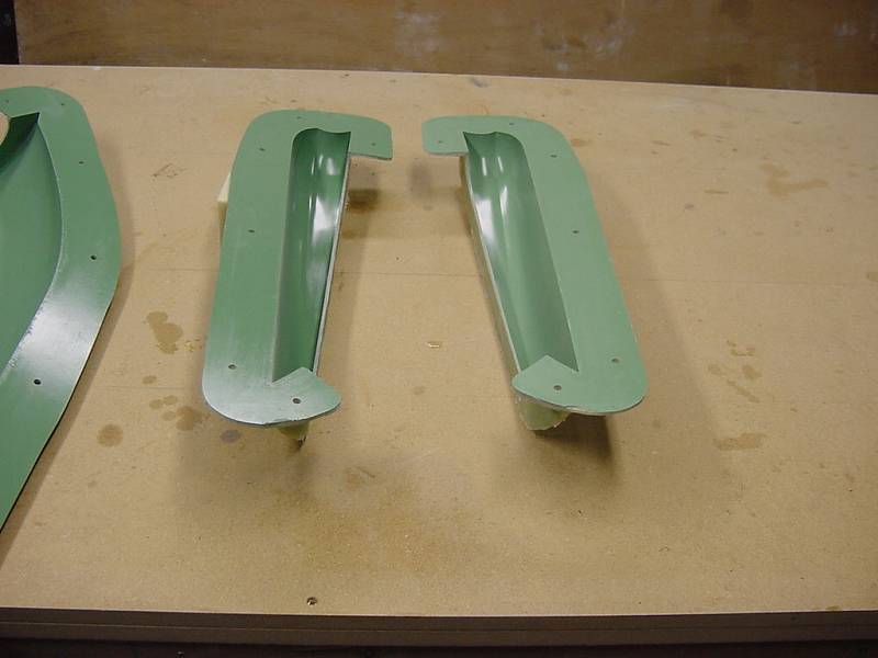

The plug is made from balsa and polyurathane foam. The plug started as a main box framed from balsa (front end of the canopy hatch to the tail post) The nose, fin, canopy, chin, top and bottom decks were shaped from poylurathane foam. All was glassed then primed with a catalyzed polyester primer.
I've completed first half molds on all three parts, hopefully be done building molds by next weekend. I'll keep the pics coming as the project progresses.
Todd

Well, after about 30 hours and 3 gallon of epoxy the molds are finally done!! They came out really good. It's time to wax these puppies up and make an airplane!!
Todd Schmidt
