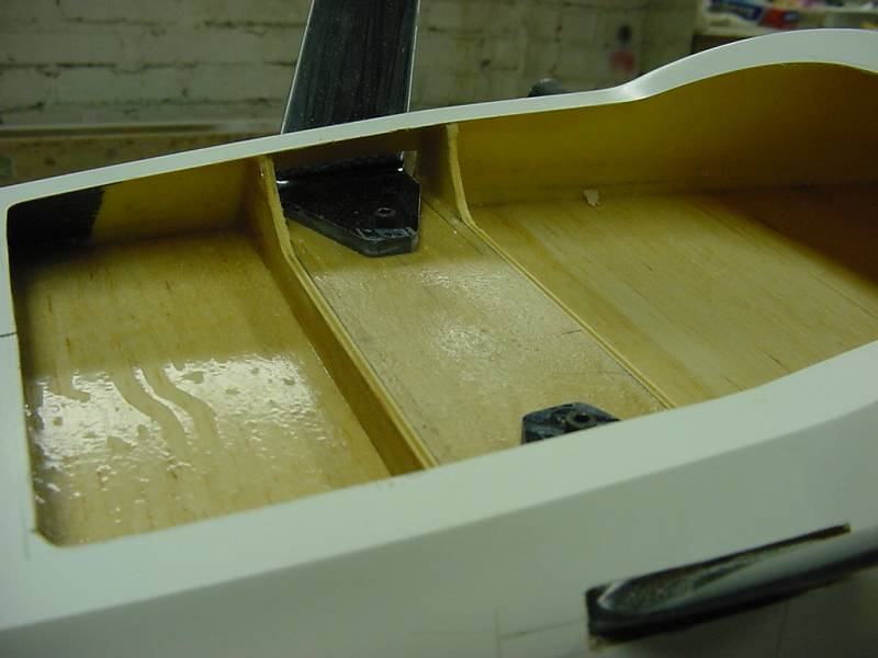

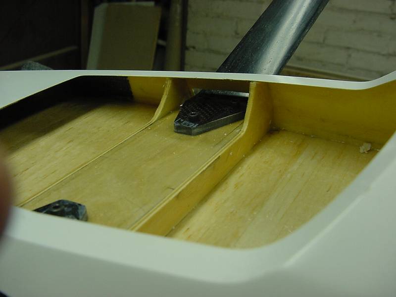

Hello Todd
Perfect job.
I know you are very busy. But is it possible to get somes pictures of the fixation of the gear and how is reinforced the frame which support the gear.

Hello Papaone, glad to give you a closer view of the landing gear plate. The plate is (2) 1/8 ply pieces with unidirectional carbon fiber laminated in between. The fuselage is reinforced with carbon tow underneath where the plate is glued in. The reinforcement boxing is 1/8" liteply.
