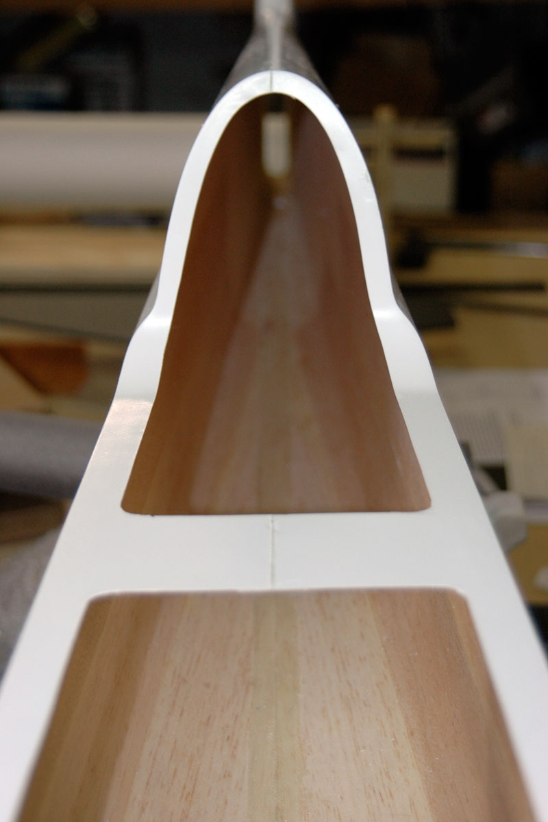

Just picked up my Defiant kit... WOW !
Amazing craftsmanship and beauty, the complete fuse with chin and cowl - 856g - strong and super light. I just love the aggressive looks and style of the defiant. Awesome fit and finish. The included wheel pants are super nice only 6 g heavier in primer than the small bolly carbon pants.

Hi Todd
Fanstatic job as you are use to do or like European do (it's a joke !!!)
How do you do to round (I don't know if it is the good word !) the balsa in the fuse ?
Do you glue every sheet of balsa before putting in the mold ??
Claude

Hi Claude!!!
Hope you'e doing well!! Yes, I glue all fuselage balsa together then cut to shape using a template. Then wet good with ammonia water and bag in the mold for at least 24 hours until good and dry. In order to have balsa go to the seam edge I had to make a .25 inch thick tooling that attaches to the complete parameter of the mold flange. After the fuse is layed up and out of the bag, the tooling is removed and the fuselage sides are trimed to the mold flange. A lot more work involved in a balsa laminate fuselage. Id say additional 7 hours compared to the other way.
