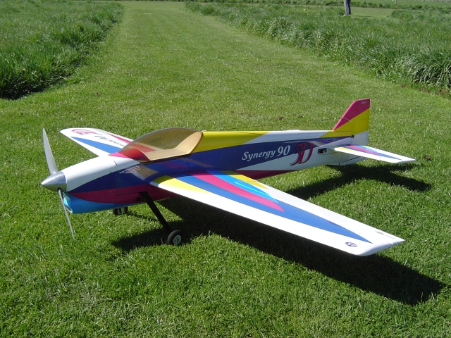

I have had a few problems with my Synergy 90 3D lately regarding Tail Flutter...
I completed my Synergy that I brought back from Germany a few weeks ago, On the first test flight I had a serious case of tail flutter when flying straight and level at just over half throttle (OS 91 FX) I slowed down immediatly but one elevator clevis came off and the left elevator settled in the full down position.. I had to switch to full rates to get enough elevator to keep it from flying straight into the dirt, I managed to put it down in the next paddock but unfortunatly the long grass ripped the undercarriage clean out. (I had added tri stock reinforcing as Mark Novack suggested)
On closer inspection the brass pin in the elevator clevis fell out when the tail flutter occured. I had used all the supplied hardware except for the aileron linkages..
I repaired the dammaged undercarriage block and replaced the elevator clevises with du-bro locking clevises.
Next flight had a similar problem. After flying aroung a few circuits at low throttle I decided to push the stick foward to about half throttle, as soon as I did this the tail started fluttering violently and after a quick change of underpants I managed to land safely without damage. I noticed the violent shaking had broken one of my tail struts I had made from aluminium airfoil tube. It was back to the drawing board...
I have since replaced ALL the clevises and control horns with Du-Bro, and replaced both tail struts. I also straightened out a slight warp in one stabiliser side...
The next day I went out for another attempt - SUCCESS!! It flew much better with no sign of tail flutter even at full throttle.
I am still not really sure what the problem was, and if it is going to happen again when I am flying low inverted across the strip? I assume the light control horns were too flexible and allowed enough play in the linkages to cause the flutter...
Has anyone else had this problem?? The last thing I want is to loose my model because of something stupid like tail flutter...
Attached is a pic of my synergy right before the first flight (Note the long grass that is good for ripping wheels out..)

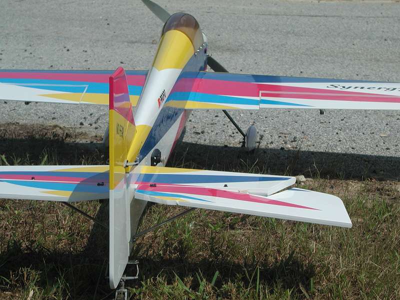

Matirx, Hope your friend gets his Synergy sorted out...
I got a reply from Alvin Braeckman in Germany just before with some very usefull information regarding the Synergy 90 3D Tail Flutter issue, I have copied it here fo all to see:
Patrick
Hello - hope your fine and your Synergy is still living.
I have read about your problems reg. the tail flutter. It took me a very long time to understand what was happening on a few kits.
Here as the modifications we introduced since you bought your plane
1) full, plain Balsa stab - this to avoid the problem with Balsa quality (I have seen that a few stabs were up to 30% lighter than the other ones - this could be one reason for flutter
2) introduction of 2mm carbon bracing for the stab (even if the stab is plain, we feel that there is a need for bracing as we do not want the fuselage to break)
3) introduction of carbon rods to slide over the elevator linkages
4) we now build into the fuselage some light ply reinforcments into the fuselage (we have seen that the 3x3 mm Balsa reinforcments are not enough to resist modelers abuses
5) servo recommendation - do not use cheap standard servos as the quality of the plastic case is very soft.
to resume : it is VERY important that the linkage to the elevator is very stiff - so please slip some carbon tubing on the 2 mm steel linkage - brace the elevator with carbon rod - and install if yet not done good quality servos. (if you do not have carbon tubes or rods or even want a plain stab - just tell me I send you everything by letter)
The basi problem is that Cristophe decided to have very efficient elevators. Therefor he decided to keep the surface straigt with a very thick trailing edge. This configuration is very prone to flutter (especially with the size of the movable parts) - therefor we must insist on extremely stiff linkage (replacing the horns and other parts of the kit is NOT the issue)
Best regards
Alvin
I agree with Alvin that the tail linkages must have NO play and particular attention should be paid to ensure this. I feel this is the number one reason for tail flutter on this design.
I also agree that the problem is not with the supplied linkages, but I still feel happier knowing I have some slightly stronger horns with bigger bases.
I am running JR DS-811 Servos on the elevators which have a small ammount of movement in the gear train, I am guessing this will get worse in time so I am looking at upgrading to a better servo.
Thanks again Alvin for the ongoing support.
I had another successful day of flying my synergy without incident today so hopefully this will be the start of a trend.
Happy Flying
Patrick

My Synergy, purchased July this year, also had massive elevator flutter. Both elevators were snapped completely across the chord, and the flutter went on to snap both sides of the tailplane. Only the covering held it together long enough to land safely. I made a new tail and elevators from solid 1/2 inch balsa with holes cut out to lighten them but th holes are unecessary since even with a YS90 up front and 3 servos in the tail I am still adding lead to the tail.
All my pushrods were c/f tube epoxied over the steel rod and there is no slop at all in the linkage.
The elevators and tail supplied were totally inadequate for the job, the balsa was so thin that it was suitable for a free flight model. Both elevators snapped at the junction with the forward aerodynamic balance which is clearly the main stress point. I am not impressed by that on such an expensive model, the resulting flutter might have led to a crash causing a death in which case I would have pointed the finger of blame straight at ZN Line.

I've also witnessed the weakness of the Synergy's elevator... here's a buddy of mine's (Hammbone's). He managed to get it down safely. He was using the quality servos (8411's) with very stong and stiff linkages. We think it broke during a snapping maneuver.
Mine hasn't shown any signs of wear yet. However, I did get an up close look at the rudder structure and beefed that up a bit as I thought the balsa was a little weak in some spots.
