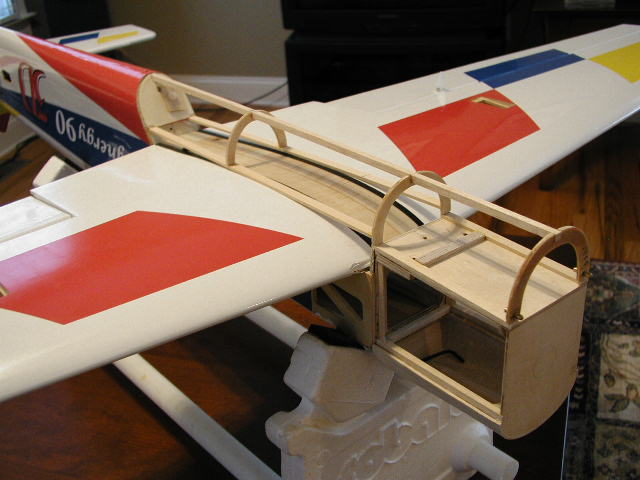

This is a great thread for a great plane!
Question:
Would anyone happen to know the proper distance from the front of the firewall to the engine drive washer?
I picked up a slightly smashed Synergy and rebuilt the nose and bellypan better than new! About to mount the cowl again and I dont have the instructions. Looking forward to getting it back in the air soon.
The thin canopy was torn so I dry fitted the old canopy on my G-Trick, almost an exact fit. So I have a G-Trick replacement canopy on the way for this Syergy - a little Rit dye and you'll never know the difference.
Thanks for all your help in advance,
Scott
PS - here's a shot of the rebuild process
Question:
Scott

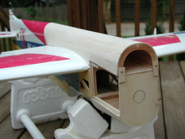

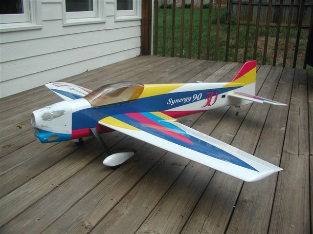

and covered...
I have the paint for the cowl coming - I added some reinforcing fiberglass on the inside and filled some holes for a previous motor installation. Canopy 'tear' is on the other side...
Sorry for all the pics but I'm quite proud of the reconstruction given the fact that I had no plans to work from (just the old formers).

There are no instructions for these planes. You just use the cowl as a guide for the engine thrust washer to firewall measurement.
Mine seems to be right about 6". There are shims used for down thrust and right thrust. I don't know how much down or right thrust is used, I just glued on the shims.
Jim

Try a little less than 145mm, thats what I have, and it could be about .5-1 cm or so closer. Nice job by the way. Mine looks worse than that already and it has yet to fly!
