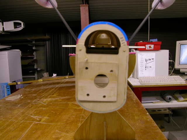

Default The front
The square piece glued to the firewall is actually two tapered pieces that set the right and down thrust. Centering the motor mount on this piece and then aligning the big hole perfectly centers the motor on the thrust line easily.

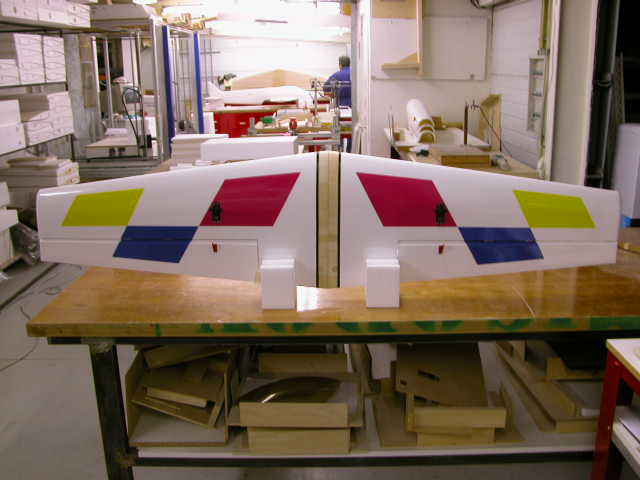

Default Wing bottom
Here is a bottom shot

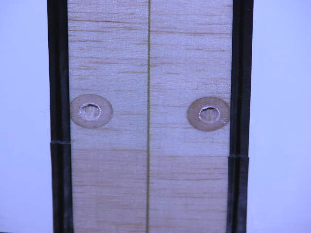

Default Bolt seats
End cut hard balsa. Very solid, very clean. I like the details put into this airplane.
