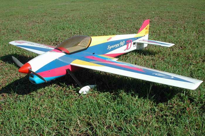

Would you tell me how the wing is mounted?
4-wing bolts? (easier to chage incidence?)
2-teflon dowel in front w/ 2 wing bolts in the back? (my Pilot BeatOn90 have this setup. Probably most used setup.)
Based on the first picture, the plane doesn't take a pipe that we use on pattern plane.
Is the plane setup for standard stock muffler or is there a belly pan or something?

Ihncheol: The wing is held on with 2 dowels in front, and 2 bolts at the back. All the holes are already pre-drilled.
The setup is meant for a internal pipe. It works like any other ZN pattern kit actually, with the pipe being enclosed with a Balsa belly pan. It would work fine with a Hatori pipe, or even a Carbon Pipe. Christophe uses an Asano pipe on his, and some modification on the fuselage is required due to long pipe.

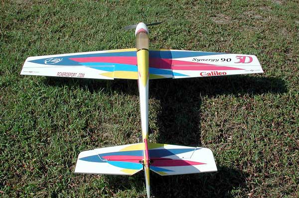

The control surfaces looks huge
! I wonder if you can get a smooth pattern flight out of it! And I noticed the stab is not airfoiled - wonder why? Also What's the covering scheme on the bottom? I hope they put out an ARC verson soon - I don't like the covering scheme, or it is just me?
