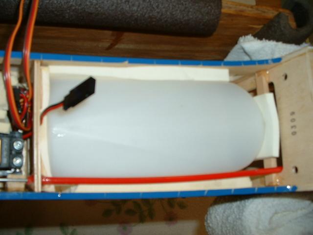

I had my timer switch set at 12' with the 140 and the 16Oz tank. That would give me the time for a couple turn around on idle if the runway was taken.
The 16Oz is actually 473.17ml, which is oversized for the 110 I think. The 400cc tettra would be perfect but hey, I can always put less fuel in there if I want to !!!

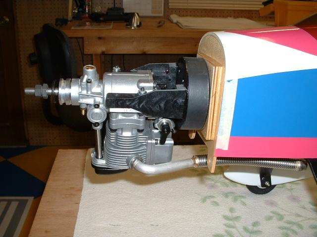

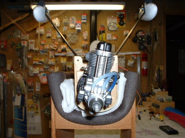

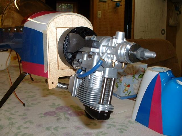

Jim, nice pictures, thanks.
Looks like it moves the engine forward quite a bit (the thickness of the rubber really). Did you have enough cowling length?
I'd like to move the engine back as much as possible to minimize the nose heavy factor. I'm still scratching my head on this one. I don't plan to use a pipe, just the standard muffler. I might want to use some beam engine mount so there will be no interference with the engine chamber. I've got work to do before getting there though, I'll do the engine towards the end!

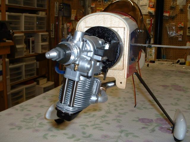

Jim,
Only two screws with lock nuts for engine mounting?
Are you using Hyde mount type A that does not require nose ring?
Also, which pipe are you going to use with that Hatori header?
I wish somebody try with 91SX or 91ST heli engines.

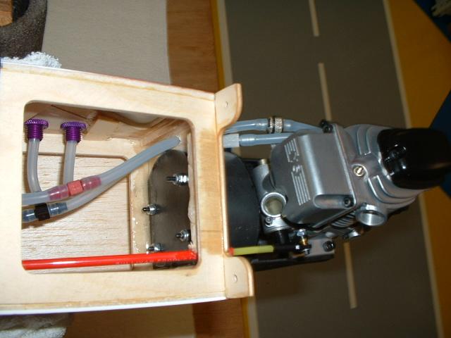

Hi Ihncheol,
I will use 4 screws to mount the engine. I just have two in for now during set-up. It is a Hyde type "A" mount that does not require a nose ring.
I am using the Hatori #580 header with the Hatori #675 pipe.
Here is a pic of my set-up inside the fuse.
Jim
