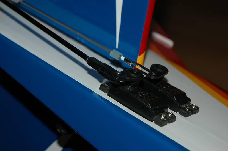

I used a CF tube with 4-40 threaded rods JB welded at boh ends to build a push-rod for rudder. Saved some weight. see Pic 1.
