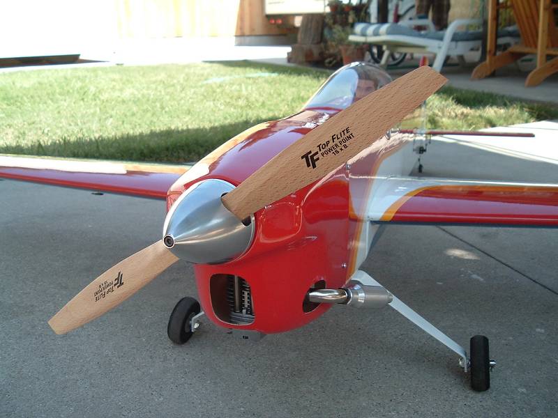

I was planning to use the Saito 125 on the stock mount on my Venus, but in order to get the 6 1/4" spacing, the engine will mount almost at the very end of the mount. I'm concerned about this and would like to know if any other 125 users went with this setup, or what was done to correct this situation? I've seen the pictures of the Hyde mount, but I'm gong to mount the engine at an angle to let the stock exhaust point down the bottom channel.
Any help/pics would be greatly appreciated.
TIA
RFan
TIA
RFan

Just for everyones information the Saito 1.25 fits the same engine mount as
the YS 1.10 , the Saito is just a hair longer at the prop hub. I sold my YS 1.10
out of my Excelleron and the Saito 1.25 was almost a drop in replacement except
for the throttle cable and the spinner gap was just a hair wider.
tommy s

Mine ended up weighing 7.95 Lbs. with a Saito 125 and Du Bro soft mount. Flies like an angel. Turning a 15 X 10 APC @ 8900. not unlimited vertical but with only 3 gallons of fuel through the engine.
