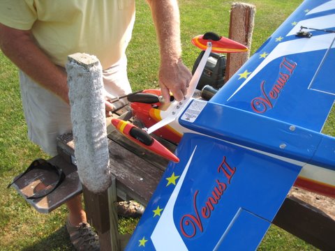

I bought my OS 120AX without the muffler and bought a MAC muffler. I also bought the exhaust extender and cut it in half. Next i filed the new mating surface flat. This setup allows the muffler to be only half exposed beneath the Venus II cowling. This setup looks really nice and has been in use for over a year.

With the rubber band you won't need foam. After a few flights and having to re-trim several times, I moved the tank back to the CG and mounted a pump. I mounted it wth a single bolt and nut to the unused hole in the mount that was intended for a nose gear. My Perry pump works perfect and the Venus now stays in trim throughout the flight.

I used the rubber band method with no foam for the first season. As I was doing my winter maintenance, I noticed the vibration had started to wear on the tank. In my case, it was only a matter of time before the tank would have failed. Iam now in the process of moving my tank back (as well as a slightly larger tank, going from the stock 14oz to the Dubro 16oz tank) closer to the CG. There are many photos in this thread on mounting the fuel tank on the CG.
Here is a photo of the stock tank after 11 contest flights and 72 other flights plus 1 engine break-in on the ground. This was a very short season for me without a lot of practice or contests.
If you are set on mounting the tank in that former, I would suggest using wing saddle tape to cushion it a bit, or maybe 1/4 inch foam. Just know that it will probably wear away due to vibration.
