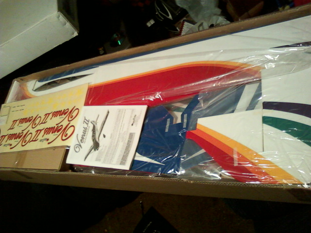

Well after two years of searching and searching my good friend CJ found me a bran new in the box Venus II in Henderson NC http://www.hendersonvillehobbyhouse.com/. After a few days of waiting the box showed up at my front door unhurt and the plane contents inside the box was unhurt and in excellent condition. I just wish i could find a way when the plane was built from the factory so i can date the inside when it was made and when i assembled it and flown it. Mine is powered with a Saito 1.15 and i added no extra weight what so ever i just moved the battery from the former that was next to the tank to more closer to the throttle servo and the servos are in the tail. I may have to get me a cowling from Tower and get me a OS 120ax just to see what the hype is all about with that motor and a pitts muffler so if i get a wild hair I can change motors lol. But needless to say i am very pleased with the power and handling with the plane and motor combo that i currently have. I now have two of the venus 40's one built as it comes out of the box the other 40 size i retrofitted it with pneumatic retracts and OS 50 sx power. One big venus family!

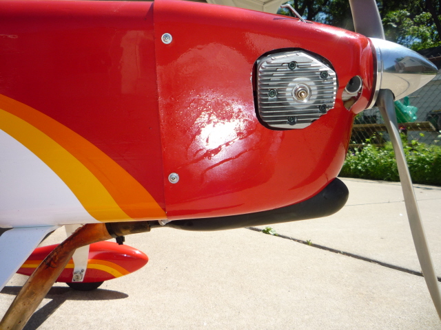

If you want to use an OS120AX, look at my MAC muffler setup. This fits the cowling much better than a pitts. I used an OS exhaust extension then sawed it in half to get the muffler in the right place. I flat filed the edge and bought the correct length screws. Check the photos. I have been running that engine in the Venus for 2 years with no problems. I did move the tank back to the CG and installed a Perry pump. This package runs flawlessly and the power is awesome. I replaced that plastic tube in the photo with an aluminum angled tube tha MAC sells to fit that muffler.

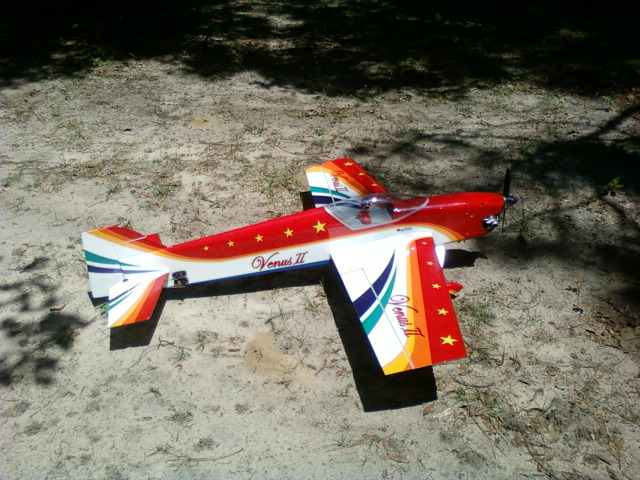

Well after working all winter recovering my Venus I am getting close to being done, and I was ready to be done a long time ago. It turned really well, I did the exact scheme I posted earlier minus the tail feather colors. I may just leave it white. Tired of it. I used Serif drawing program. Starting first with a picture of the pieces then drawing an overlay over the top. It works great on the flat surfaces like the main wing. A 3d rendering of the fuse would have been better. It took many draws, tile prints, and trial fits to get the 3 colors around the fuse. A real pain in the .....I am curious how it's done at the factory. I post some Pics soon.

The New Venus is almost finished.

Bravo, Patrick!
Beautiful refurb job!!

That's lovely. Moving the canopy forward really improves the look. Do you have any photos of how you did it?

That is a very nice looking Venus. It makes you wonder why Great Planes does not continue tweaking their designs after they have been in production to make them look more current. It would seem to me that minor changes such as these would allow them to keep producing the plane without having to introduce a completely new design as a replacement (which as far as I know, they have not done...).

That looks great, like a completely different airplane.
Good job!

It looks like the Jekyl series of models........ I think it will fly better than the original if not too much weight was added

If you want to use an OS120AX, look at my MAC muffler setup. This fits the cowling much better than a pitts. I used an OS exhaust extension then sawed it in half to get the muffler in the right place. I flat filed the edge and bought the correct length screws. I replaced that plastic tube in the photo with an aluminum angled tube tha MAC sells to fit that muffler.
Do you think it would be possible that you can take me a bunch of pictures of this set up with the cowling off? Is this the same muffler that is on tower part number 6990? or Tower stock number LXSXF2? What about the exhaust ext? If you can find time take me some pictures and post them here if you would please.

I don't have time right now to take the airplane apart for photos. The muffler is MAC #6990 and Tower LXSXF2. The extension was ordered from a local HS and is OS # E5020. I hack sawed it in half and filed the sawn edge smooth. It does not leak. You also need 2 Dubro allen screws for the correct thread of the muffler and a length for the new extension. Now assemble the engine with the mounted muffler and the engine mount. Hold that assembly on the firewall and center the muffler in the exhaust opening on the airplane. Mark and drill your mounting holes. The cylinder comes out a bit below horisontal. I am including three photos thst should help. The firewall photo also shows the pump I installed when I moved the tank to the CG. This cured the constantly changing elevator trim problem. Good luck. I should also mention that I used the exhaust deflector that MAC makes for their mufflers. This is a short curved tube that fits over the end of the muffler and is secured in place by a worm gear hose clamp.

Well I finally finished my Venus and got it flight worthy. Still needs a Venus III logo on the side of the fuse. With the canopy forward their is little coupling during knife edge. The Syssa wasn't pulling like it was last year thou it was 95 out today and really humid. But plenty of pull for sportsman practice. Canopy forward added some weight to the nose. I am running a A123 right over the cg and their is plenty of room to move the battery back. The Saito 125 was a better engine for this plane. They seems to have the same power as the Syssa with more weight so verticals are not as strong. Fun to fly and much less work on the stick than my Extra of course.
