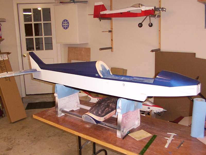

Update on Titan progress. . . .
Started glassing the fuselage, got the canopy and bottom of fuse done.

Old 10-09-2003 | 05:54 PM
  #280
Posts: 540
From: Guntersville, AL
Default RE: 2 meter plans
Looking great Keith.

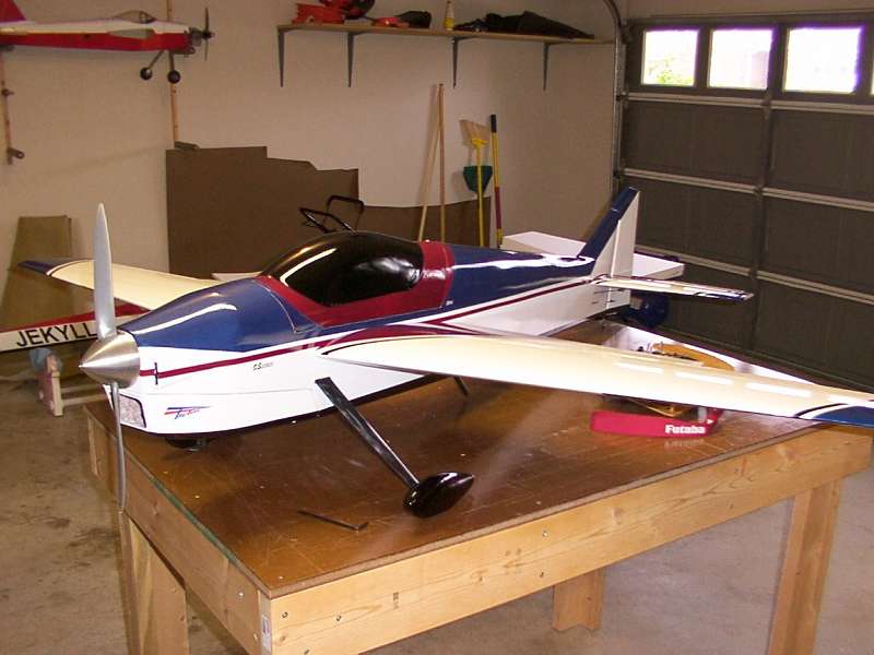

Guys,
It's finally ready to fly (won't say finished - no plane is ever "finished"). Went out for the maiden flight last week, but had a bum aileron servo. The servo should be back from Hitec tomorrow, hope to get some inflight photos on here soon.

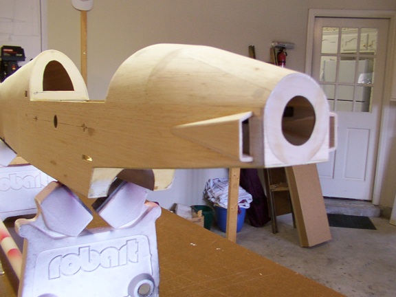

I happened to be doing just that this morning...for me, it was because of the fiberglass cowl and belly pan. I just couldn't see getting a good blend if I filmed up to the glass parts. (Not to mention trying to film all those fillets!)

I chose to Monocote the fuse. Reasons: ease and economy. I also thought I could do this adding less weight than if I had glassed and painted, especially since I have very little experience with this method. Yes, for the number of colors I used I could have bought paint, but I've got quite a bit of Monocote left for future jobs. I realize I increase the risk of dings to the very fragile contest balsa I used!
I finished the cowl with matching Monocote paint which was shined by sanding and compounding. The transition between the Monocote and the cowl/paint is visible, but, for me, acceptable. Many of the ARF pattern planes have bolt-on cowls where there is no attempt at all to blend them with the fuse.
I'll try glassing and painting my next one!
