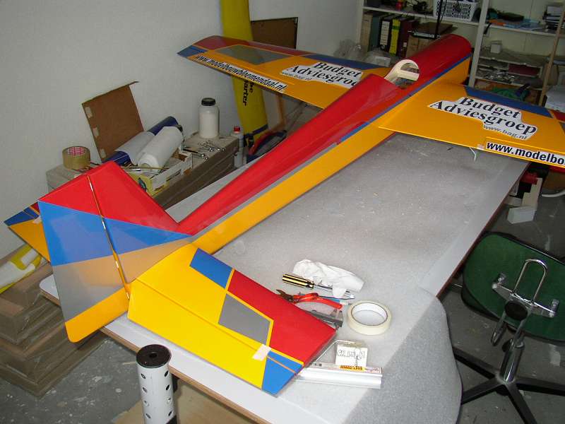

Default Xtra-2000 (all wood)
Hi
Attached are some pictures from my almost finished Xtra-2000, a disign of Dennis van der Tooren, formal multiple times Dutch champion F3A. It's an all wood disign, and with the CNC-cut parts, very easy to build.... but it always takes more time then you want .
First flight in about two weeks....
Winfried

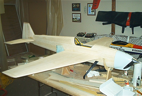

Here's a few updates, as promised. It started out as a Typhoon 2000, but after building 4 of them and changing things on every one, I realized that this one is so different I can't call it a Typhoon 2000. So, this one is called the "Tempest", and I'm using it as a test platform for my own wing/tail/moment arrangement to iron out a few kinks. And get rid of some nasty habits the T2K had (like not snapping/spinning worth a darn).
Assuming all goes well, I'm going to make the next one totally new....and it will be something to basically replace the Typhoons, with a very attractive, aggressive, and most of all COMPETETIVE design. So hopefully I'll have some plans and fiberglass parts etc. But that's down the road a bit.
So here is a few pics, just to stir the pot.

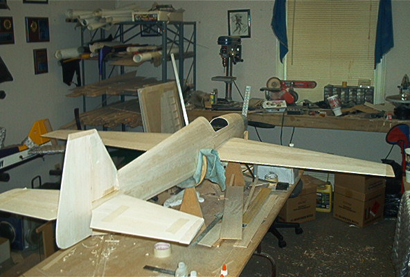

And a couple of the cowl being lined up, and the BEAUTIFUL power plant
So tonight I'm working on the nose ring assy and lining up the cowl. This part is always a headache.
-Mike

That motor is too pretty to fly. Is that all carbon fiber in your fuse? It looks well done.

Yep, it's C/F accent panel bonded to 1/8" 5 lb balsa. It's as stiff as plywood, and weighs half as much. Plus it's pretty. The cockpit area is done the same way, and I'll smoke the canopy. It should look really unique. Not a lot of wood planes out there with this much detail.
I'll go the extra mile this time around, and post step-by-step the glassing/painting phase, since there's some confusion about that part of it all.
-Mike
