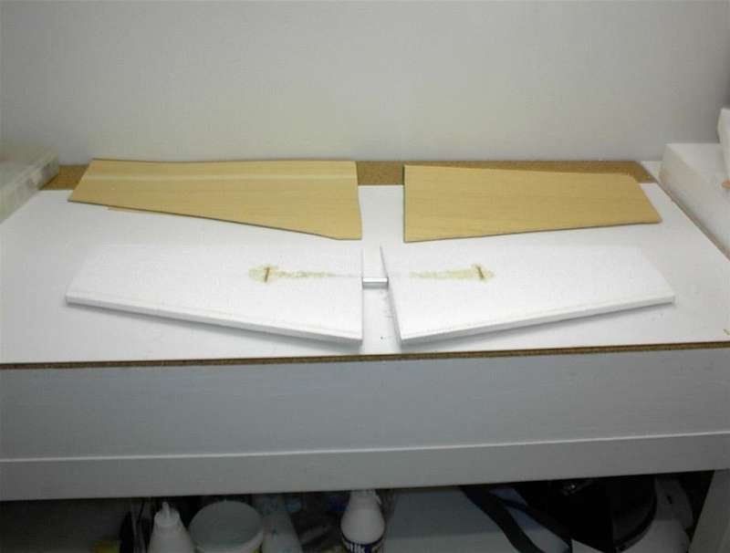

The good thing about building from plans is always learning something new.
I almost got myself in trouble here when pressing the skin to the wing because of the huge difference between the root and the wingtip, the clamps really should be calibrated for best result.
This wing doesn't look like anything I have done before.
I have never before pressed a skin to a wing that tapers so much towards the wingtip. Also the ply rib for the tube really made things interesting, creating a hard spot in the foam. Using springs on the clamps should help even out the pressure.

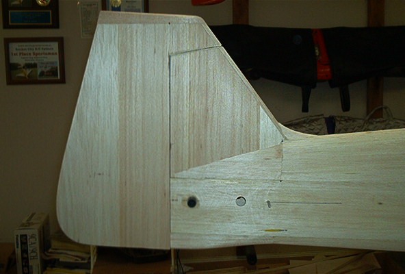

#334
Posts: 2,707
From: Woodstock, GA
Well I didn't get 2nd at the nats, my friend did [8D] (I didn't go) But soon....
Yes I added about 1/2" to the elevator all the way across, and used about a 10 deg throw with 80% expo. That made for a SUPER stable plane.
The trouble is now it's TOO stable, it just won't handle the snaps and spins cleanly. Oh it'll do them, but exits are always a guessing game which way it'll be pointed. You really have to dig deep to get that thing to snap.
So with the new wings and tail, it should resolve that problem. I clipped 2" off the wings of my first 3, then the one that burned had an additional 1" clipped as well. It was getting there, but by then the stab was too big, and needed to be downsized. Which brings me to my current arrangement......
This isn't really a new thing, I've seen T2Ks with patriot wings, prophecy wings, all kinds of crazy stuff. Thing is that fuse and rudder are almost perfect. it also has the added benefit of stealthing the wings if they're off a little, allowing you to slip slightly in a crosswind without getting busted. I can't tell you how many rounds I took doing that
That plane just puts the judges to sleep.
Okie dokie, I'm off to build a chin cowl.....
-Mike

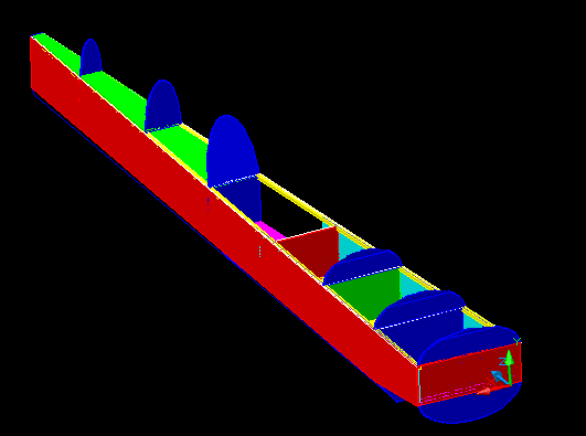

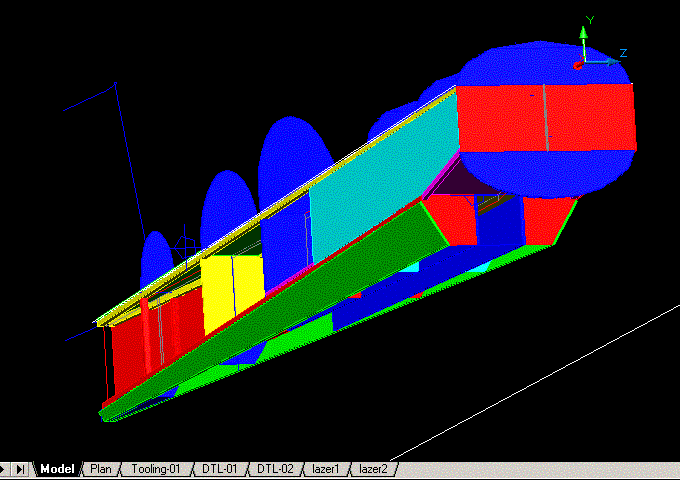

#336
WHAT A GREAT THREAD!

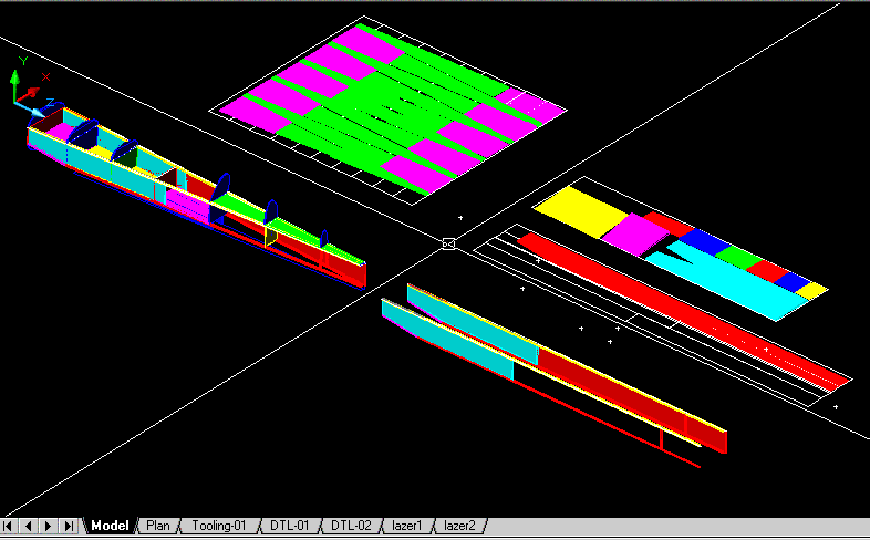

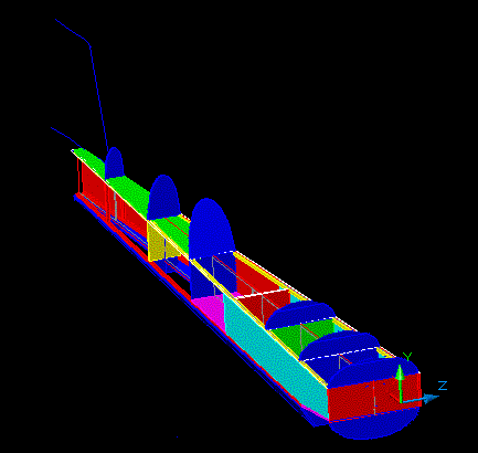

I am preparing to start a plan built 2m plane, and think I will jump in here. I have had the plans for a couple of years, but work pressure has kept me from flying, let alone building anything. Now I'm ready.
I ordered the plans for the Typhoon from Gator R/C. They arrived and I hung them from my shop wall to flatten out. It took me several minutes to realize that something was wrong. A couple more minutes to realize that I was looking at the plans for the Giles 202.[:-]. I guess the person that took the order, one of Chris Lakins teenage boys, mis-packed it, or maybe even I screwed up.
Well the thing started looking pretty good so I decided to keep it. Besides, I can't go off on a kid making some after school money.
About a month ago I started doing some R&D on the plans. (Rip off and develop as mentioned earlier in this thread)
I am drawing up a set of plans based on the basic plan form and moments of the Giles. It will have a double tapered foam wing, and I am reducing the root chord by 1 1/2 inches. The engine will be a Webra 1.45 and the radio will be my brand new 10x.
I am posting the plans (note, they are work in progress) and hope to be ordering the wood from Superior Balsa in a week or two.

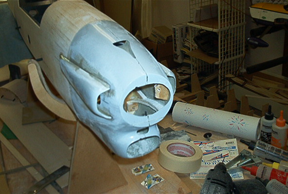

#340
Posts: 2,707
From: Woodstock, GA

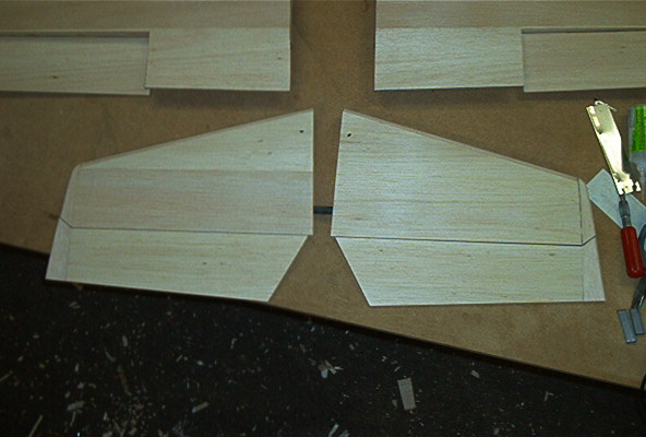

Allright, quick update. It's all built now. Here's a pic of the finished cowl and the modified vertical/rudder (before a LOT of filling and sanding).
So all I have to do now is a couple weeks of sanding and filling. Yay me. I hate this part. But this is where you make or break the plane. And since I'm going to be waiting a minimum of 3 weeks for the paint and servos, it gives me NO excuse to cut any corners. I'm not really planning a complicated paint job, but colorful. Sort of like my old ones, but with some new twists.
So, this is the last update from me until I begin glassing, at which time I'll do a step-by-step through the painting for all you who want to try a painted wood fuse.
Make some dust fellas!
-Mike

The leading and trailing edge have been glued on to the wing and the wing is being aligned to the fuselage. After the bottom was glued on to the fuselage it is stiff enough to be handled.

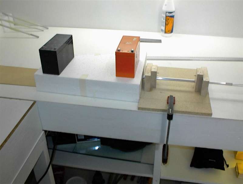

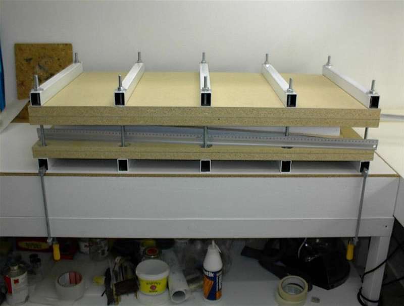

Joined: Jul 2003
Posts: 166
From: Reykjavik, ICELAND
Hi tph1
No there is really no need for such a fancy tool. A simple bathroom scale is quite adequate if you want to calibrate the press, it isn't that critical, then you just have to remember how many turns you did.
You can also, before gluing put the cores in the press and start pressing down on it at the root and count the turns, notice when it starts to crush, then go no further. Do the same with the wingtip. Then you will notice you can probable only do half as many turns before crushing the tip. Then you will have to even out the pressure on the other clamps.
The trick is to gradually and evenly reduce the pressure to the wingtip. It will also help using a straight edge to see if the clamps are all in line.
The Typhoon wing is the only wing that was a little bit tricky because how much the wing tapers towards the tip. All other wings I have done, I have just calibrated the press for even pressure and that has worked just fine.
I use this press because I got so bored stacking weight on the cores, besides, when the press is taken apart it doesn't take up much space.
But the best idea for a wing press I have heard came from a friend from my club, who owns a huge air compressor. His idea was to use air jacks to press on the cores. Then you would not need to be stacking weight or tightening clamps, just push a button. How expensive the jacks would have been, well that's another story
But it sure sounded good.
