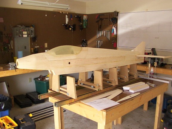

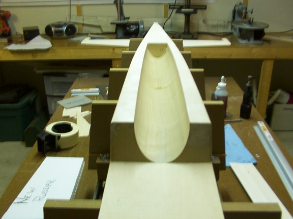

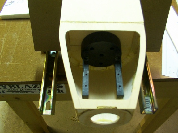

OK guys, I know I've been promising these for a while. My digital camera departed back in March with 135 lbs. of dead weight. . . . now I gotta borrow one (camera, that is)!!
I started building this back in April but took a couple months off this summer due to flying and heat in the garage. <knock on wood> I'll have this bad boy ready to fly for the 2004 season.
