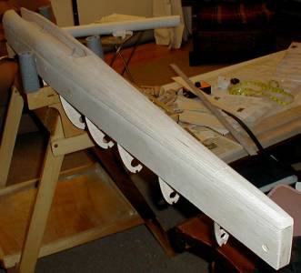

I'm committing myself here, but I'm hoping this will keep me motivated to complete this project for spring. I've been in r/c for 30+ years and have built many planes from kits and plans. This is my first attempt at an all out 2 meter pattern plane. I plan to post progress reports and comments as I build this plane. I'm hoping my comments will help other newbie pattern builders.
I'm building an all wood T2K. I obtained the fuse formers through Gerald (patternjunkie) Williams. They are of great quality. I found that former F-2 was missing, but it is also missing on the shop drawings that come with the plans. I'm sure whoever scanned the plans to do the laser cutting missed it. It's no big deal; it's a very easy part to make. I made the ribs and all other parts from the plans.
I'm using the book "Building a Pattern Airplane" by Bruce Thompson and Don Atwood as a guide. The Typhoon 2+2 is used in the book as an example of an all-wood plane. There are some differences from the T2K, but the overall sequence and some of the tips are helpful. I'm also using tips/photo's from Gerald's website, NSRCA web site and others as guides.
I'm going to use Troy Newman's elevator set-up which is on Gerald's website. I think it will lend itself well to a built-up fuse with the bulkheads to support it.
One part that I would change in the construction sequence (from the book) is to add the top formers later in construction. At least until after the bottom formers are attached. The top formers are tall and rather fragile and are susceptible to damage while working on the bottom of the fuse.
Attached is a photo of my progress so far. Not shown is the verical stab and rudder which are framed up and sheeted. The horizontal stab is partially framed up, as far as I can go before the fuse is further along. I'll post a photo of them next time.
I have about 4-5 evenings and one full day of time invested so far. So far no big problems.
Dave

#86
Posts: 540
From: Guntersville, AL
Dave,
Nice to see some progress on the T2K.
Framing looks great. I think the idea of posting pics of your progress is a great idea. Might motivate a few newcomers.
Glad you like the former sets.
You are right about F2
The first few sets we had cut were missing this former. Later sets do include this former. For those that have the former set, F2 is just a rectangle piece easily made from1/8" balsa. I think there are only 3 sets without this former in the cuts.
Keep us posted on your progress.

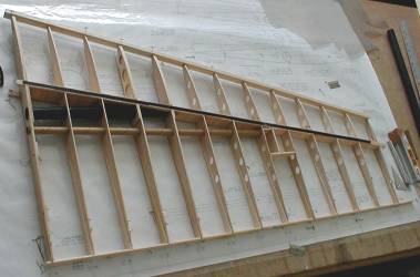

Today I got one wing panel nearly ready to sheet. I just have to complete the shear webs around the wing tube and build the servo box.
I started on the wings because I ran into a problem with the fuse. I was trying to use the home-brew Piedmont mount for the Webra 1.45 I'm going to install.
http://piedmontmodels.com/dave_brown..._made_soft.htm
I found that the overall length of the set-up is 1/2" shorter than the plans show. I'm reluctant to shorten the cowl and moment that much. So I need to decide what to do; either build an engine mount box or use standoffs of some type. Or spring for a Hyde mount. I've asked for help with this on NSRCA mail list and have several suggestions. Among them is advice not to use the Piedmont homemade mount. Some people have said it works fine, though.
No problems with framing the wing. It's a little tedious trying to get everything perfect, but it will pay off in the end. Especially time consuming was getting the wing tube holes just right so the tube would not bind when installed. Any binding meant the tube was distorted and would not accept the inner tube. It takes a little patience.
Attached is a photo taken just before starting the wing showing the jig set up. I'm building on a luan door in my living room! My workshop is in the cellar, but it's cold down there. Living alone has its advantages.
I'll also post a photo of the wing as I left it for today. If I can figure out how to post two photos I'll attach it here. If not I'll repost.
Dave

#90
My Feedback: (7)
The plans do not call for the carbon fiber strip to run the full span. The wing joiner tube should be more than adequate to support inboard section. There are light ply doublers on the ribs through which it passes. I'm also using a carbon fiber wing joiner which is far stronger than the cf strip.
Actually, the strip I put on is longer that the plans call for. They show ten inches from where you see it start in the photo. It overlaps the joiner tube by about 3 inches. I just used the length of the strip I have which is 24." Practically no weight to this stuff anyway. There will be a strip on the bottom spar too.
These together with the shear webbing should make the wing plenty strong!
Dave
Dave

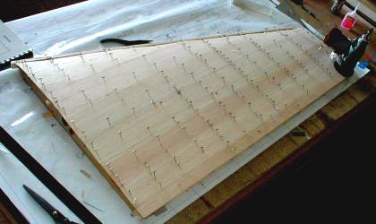

#91
My Feedback: (7)
This is where I left off yesterday. I didn't get much done as I wasn't feeling well. Installed aileron extention tube and built the servo box. After reading my last post, I decided to extend the carbon fiber strip all the way inboard. Why not?! I'll start the bottom strip inboard.
At this point the panel is ready to be sheeted on the upper surface. I also prepared the sheeting for this step. Then went to bed!

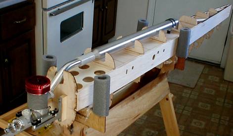

Finally made a little more progress. It took a while to decide how to handle mounting the Webra. I considered many options suggested by several helpful people. As can be seen, I opted for the Dave Brown Vibradamp mount with hardwood stand-offs. The area between the stand-offs will be filled with light balsa.
Mounting the engine was the most difficult part so far. Getting it in the right position so that the drive shaft would center in the cowl was a little difficult to handle by myself, but I got it done.
With the engine mounted, I was able to mount the pipe and build the pipe tunnel. I also began sheeting the bottom of the fuse. Because of all the compound curves, I'm doing it in sections. What is done so far was done with one piece sheets. The rear will be done using strips.
This photo shows the engine mounted and the pipe in the process of being mounted. I'm using two Dave Brown pipe mounts to secure the pipe in the tunnel. I don't know if this is the proper way to do this or not, but it seems secure enough.
#98
Posts: 540
Nice Work. You are gonna love that plane when you get it built.
I like the way you built the pipe tunnel around the pipe instead of just making the tunnel the same width from front to back. Very neat...
