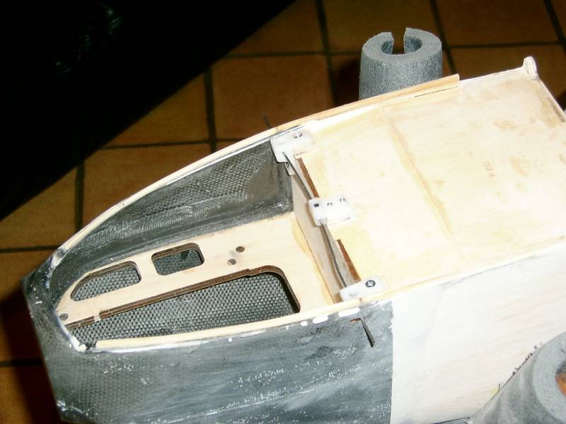

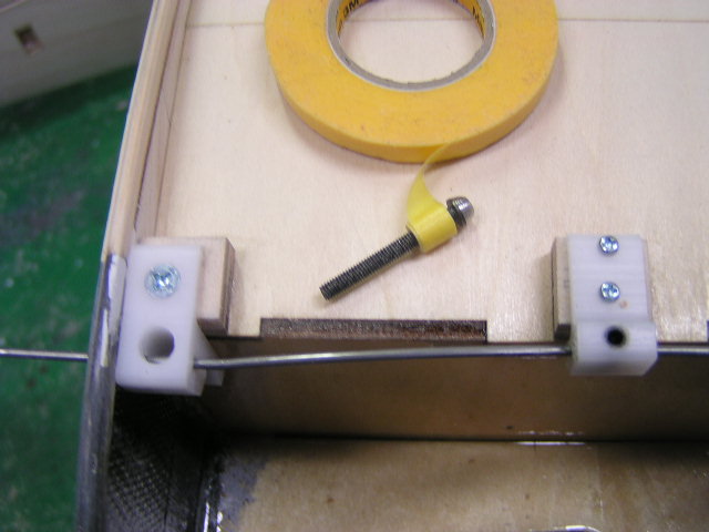

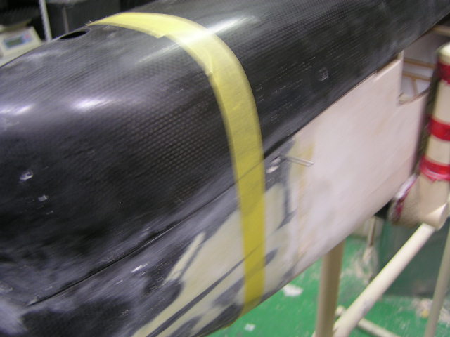

To fix underbelly on our plane Addiction, Hiro (nice guy) sent me theses pictures to help me.

You have to buy tank, fixed gear (see pic), system to fix underbelly (see pic), quick links, horns, pilot to glue in the canopy. Glass cloth is not in the kit.
Claude

Jerome's father will finish Addiction with glass cloth (25 g/m2) and epoxy resin.

I aggre with you, carbon is not necessary and expensive, it's just for the look !

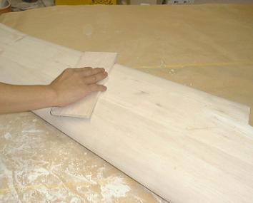

It's not difficult to build wooden kit if you're meticulous. So it's longer to do than a composite kit.
There are pics on differents forum to help you and also Hiro who 'll send pics and advices to you for that.

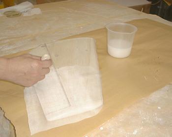

Fuselage is well to do with 25 g/m2 glass cloth and epoxy resin. After sanding, you have just to paint it as a composite fuse. For wings, stab and rudder I prefer to cover with plastic film like Oracover.
I did prévious pattern as Silent and Wild Beat with that.
Claude

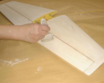

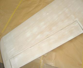

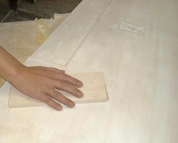

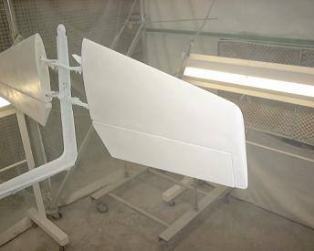

To put silk on balsa, I used nitrocellulosic liquid. I fix also silk in different points like leading edge, tips of wings, with glue. I don't have ratio, you mix the talc with nitrocellulosic until it's good to put it with a painbrush (like a gelcoat). You have to put paste and sand it several times to obtain a good finish.
Link with pics how to put silk and talc
http://f3a.sakura.ne.jp/radiocontrol...uster0628.html
http://f3a.sakura.ne.jp/radiocontrol...uster0823.html
link to translate japanese language to english language
http://www.excite.co.jp/world/englis...=JAEN&wb_dis=2
somes pics for example (he's not me)

These sites are incredible. The quality of the builds are amazing and I would actually love to sit down with one of these guys and ask a ton of questions.
Right now I have one big one. Why use silk? instead of GF cloth and epoxy and what is he using to stick the cloth down with.
Mike

Hi Papaone, and fellow addicts of PATTERN
Thanks alot for your inputs,you really us alot, one more question -nitrocellulosic is it the same as dope?
so here we go - first sand the fuse to near perfection
-fill all obvious holes...and sand again
-REMOVE ALL THE DUST
-wrap all the main components in silk and trim roughly
-apply the babypowder and dope to the componts
- let it dry and trim surplus cloth
- sand and check for imperfections ,fill with...sand again
-ready for basecoat white,let it dry and inspect carefully is this basecoat acryllic paint or epoxy paint?
lets say I want a duplicate scheme of ADDICTION -IS there a stensil available or how do they get all those lines
so perfect? Again what type of paint do thy use.
Acryllic..
Lets just fly Hiro in for a holiday trip to come and teach us.
Okay men come on in and fill in all the things I missed, when my kit arrives I want to be completly prepared to do the job meticuosly
Just want to get this paint thing on the Oxai standard , wish I was in the position to buy a finishe model ,but my submarine with the dollars does not want to survice.
