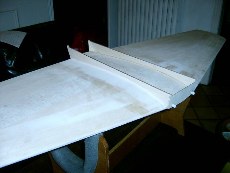

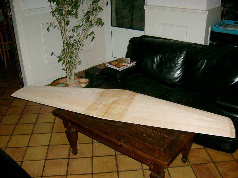

Hello

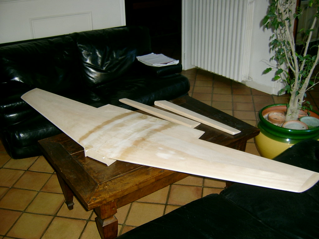

I glued balsa sheets on structure (aliphatic glue) and assembled the 2 wings in the middle with fiber glass 160 g/m2 on 18 cm wide on each side.

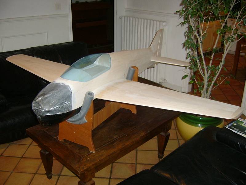

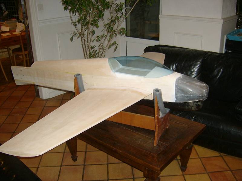

Hello Flywilly
Did you started building your Addiction ?
See pics of the wing installed on fuse.
Claude

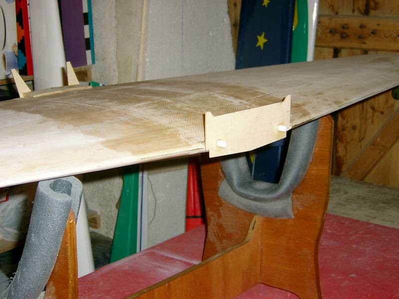

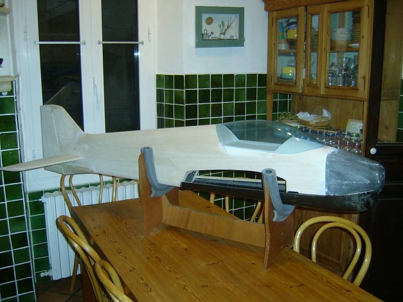

Hello Will
Thank you for theses good news.
Wing is almost finished. I have to cut the ailerons. But it's very easy, leading edges of ailerons are sandpapered in bevel.
Some pics with wing installed on the fuse to see how Addiction is beautifull.
the connection between fuselage, wing, underbelly is very accurate.
Thank to Hiro to have sent me a new canopy.

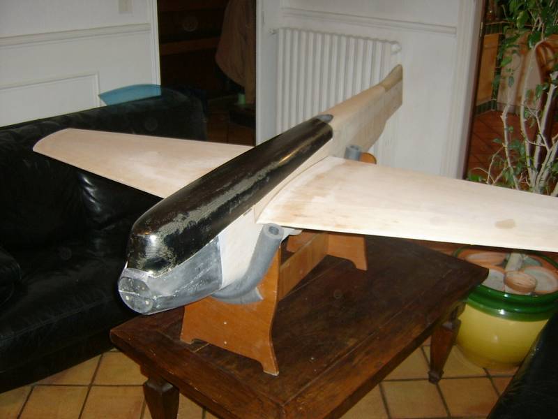

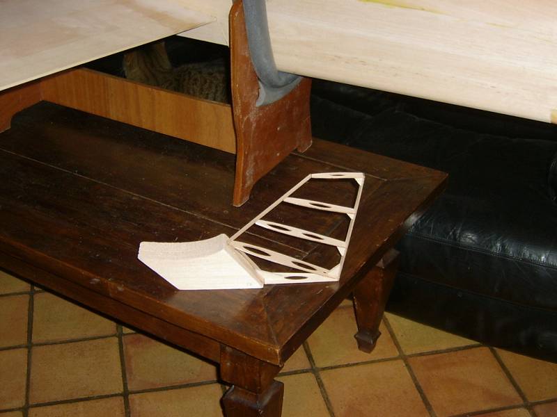

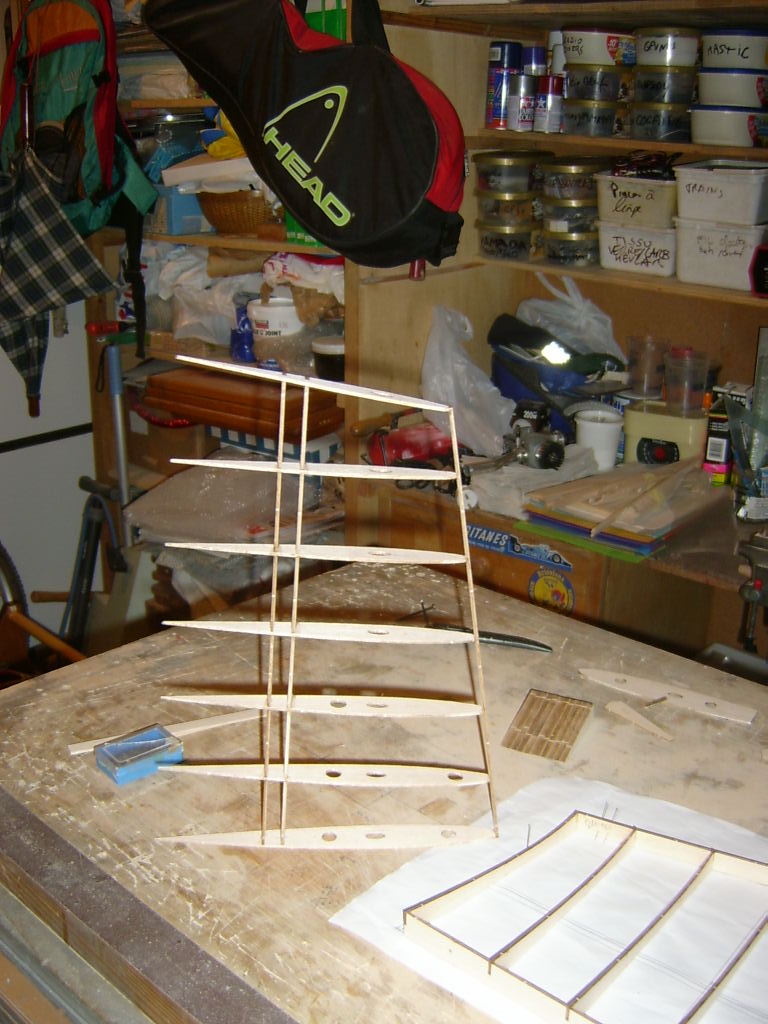

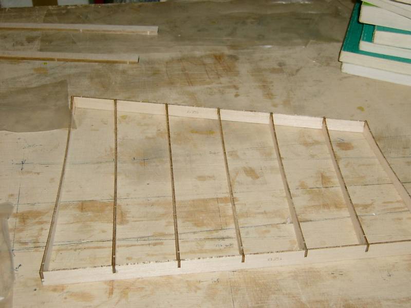

Hello

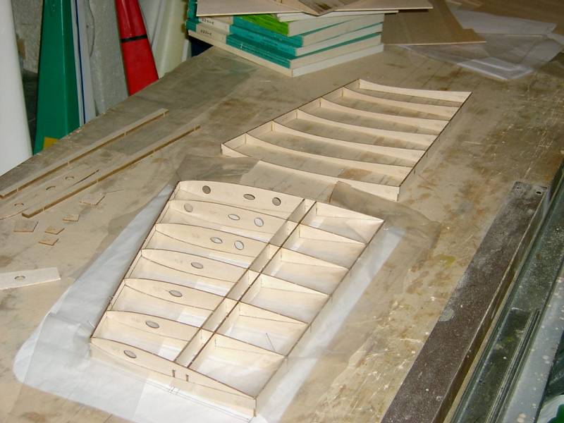

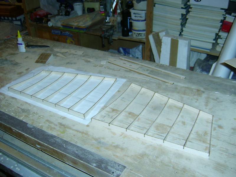

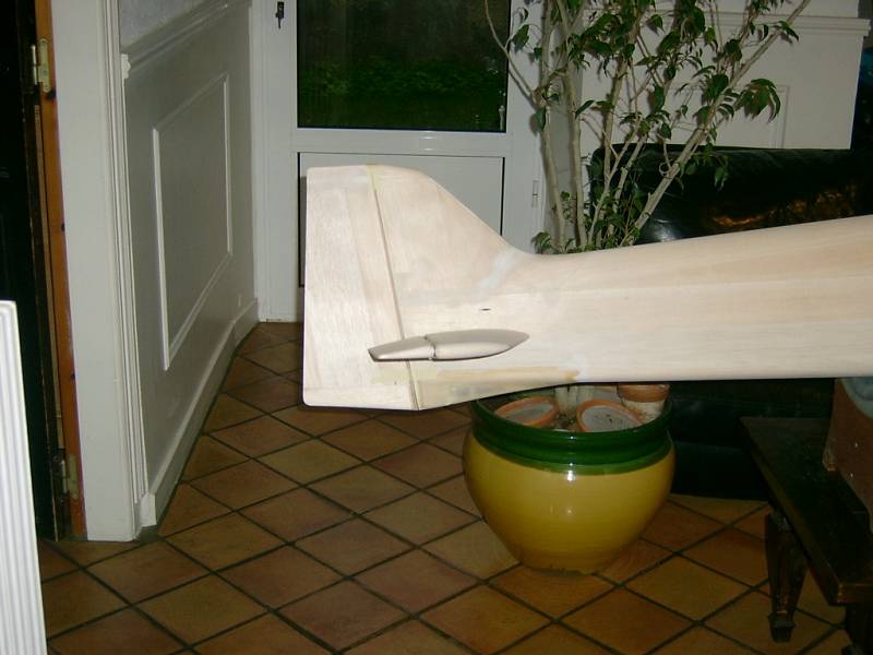

Building of stab is very easy. We have to build the supports then structure.

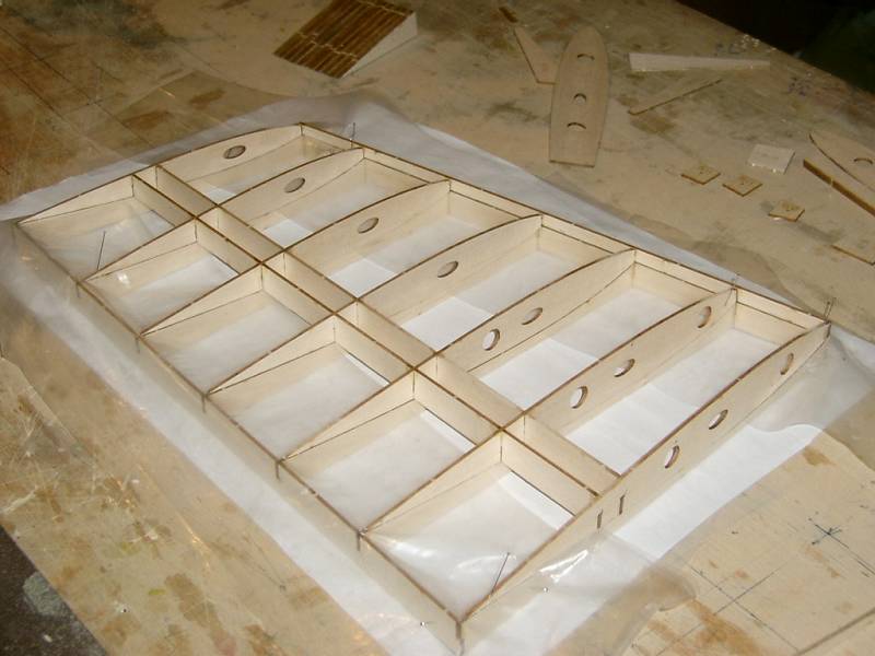

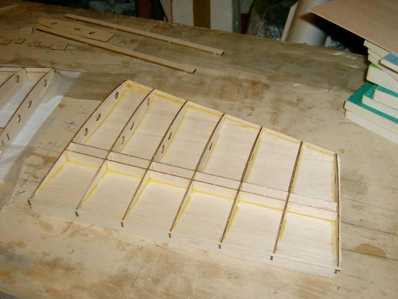

Hello
Building of Addiction continue with the stab. Soon it wil be finished for me. Painting will be done by Jerome.

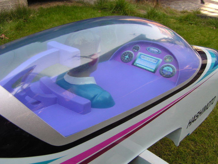

I examined in détail design of Addiction 110. This plane is larger than others planes of her categorie.
So I think even 4200 / 4300 g is good for this plane because with design of wing (large area), wing area weighty is moderate. Quality of wooden parts are the same as version 160. So it will be easy to build it.
I love design of Addiction and as we can get wooden kit no built, it'll be cheaper to built himself.
Pictures of the 110 version :

Hello
Wooden building of Addiction 160 is finished.
I hope the owner will paint her as showned on theses pictures !

Hi Roger
Addiction finished somes weeks ago. I did only wooden building.
My friend will do painting.
Plane is still at home, but difficulty is to find a box to send plane to my friend.
See pic of finished wing.
