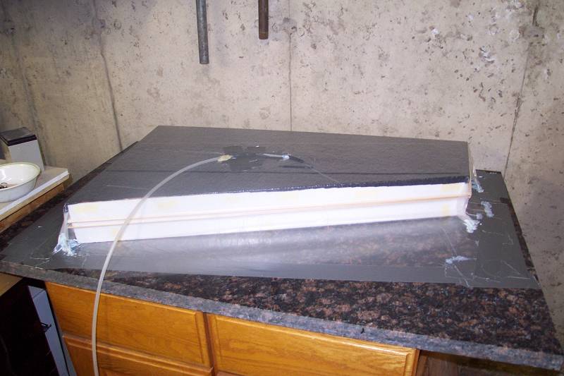

Great info Matt, thanks! (Did you notice I incorporated your vertical webs on the wing socket? Haven't given up entirely on the false rib though!)
My experiment didn't go so well. The cores absorbed the resin like a sponge! I never had time to remove excess. The toilet paper did not pull any resin from the core. 54 grams of glue on one panel [:@] This puts me at 10 oz before LE and caps; workable, but disappointing.
This time around, I pinned the wing to the shuck through the root and tip once everything was lined up. This made it easy to get the vacuum setup and not worry about anything shifting.
For bagging material, I used 4mil plastic. At one point, I let the vacuum get a little excessive and pop! The bag failed at the wing socket. Nice safety valve! A piece of duct tape and I was back in business. 6 in Hg is where I left it to cure.
When bagging "to the table", make sure you have plenty of bagging material draping the assembly. If not, the excess sheeting overhanging the core will get folded over. I knew this from prior experiences and so I tape the perimeter of the sheeting to reinforce. I still had a few spots where the L/E skin folded, but it trimmed up fine.
This was the first and last time I'll use epoxy for sheeting...poly just works better (at least for me!)
Scott,
The 6 mil thick stock of nylon film they offer in the kit is superior for this type of work. Nylon is several times stronger and stiffer than polyethylene bag material and conforms better on flat surfaces such as wings. However, the polyethylene is better when laminating fuselages since it conforms to the shape better. You should be able to buy nylon film from various sources
I like the granite table top you show. For wing lamination where the husks are doing the laminating, it's the best arrangement you can have. I use plate glass....same difference
If epoxy (or other adhesive) is applied to the foam first, the foam will soak it up like a sponge. I don't do it that way. The balsa is first sealed with plain jane hairspray and after a couple hours drying time, I apply epoxy directly to the balsa. A typical 500 sq in panel (top and bottom sheets) will take around 1 oz total. A cheapie sponge roller works well to distribute evenly but lightly. You should barely feel the epoxy after you are done...practically dry but its there. Bagging really puts the load on it so the epoxy comes back out. Must treat the foam with a tack rag to remove any dust
Did you remember to install the tube in the socket when forming the wing mount with subspars? The tube serves as mold to the socket. Subspars extended a couple inches past the end of the socket? Also, did you add 4" square 1 oz glass cloth top and bottom where the socket ends? That's to redistribute the stress riser at the end of the socket.
The aileron cutout facing in the wing, should be extended in a couple inches towards the root. Again to eliminate the stress riser at the inboard side of the cutout. I've seen panels crack over time at the aileron cutout.
I started using 1/4"x1/8" carbon tubing as the aileron horn mount several years ago and have been very pleased with the result. The hole for the horn is already there and perfectly aligned. I use 6-32 bolts for horns (normally not the hardened variety); never use all-thread in this critical application. Vibration will fatigue all thread. If electric power, then not a problem.

I applied the glue the cores because of the perforation job. My thinking was less surface area, less glue. Didn't work out...live and learn.
I got most of your other points covered. I did use a 1/2" wide .070 CF laminate 'spar' top and bottom to carry the load beyond the end wing tube rib.
Next wing I'll stop playing and do it right! Thanks for sharing your ideas.
Edit: That should be .007 CF laminate.

Scott, did you mean .070" thick carbon or .007"? The latter is plenty strong
I like the idea of screen material as a mask of sort to reduce epoxy amount. I think I'll try it next time, except on the balsa. Thanks for the tip
Matt
Matt
ORIGINAL: Scott Smith
Mark, prepare the hole in the aileron as though it were to accept dowel stock. Substitute the carbon tubing for the wood dowel. BTW, carbon tubing sands a bit easier than wooden dowels, to smoother overall surface.
I typically will countesink the top side of the carbon to accept a flat head 6-32. Threading the carbon tube is straight forward, except the threads have relatively little strength. Or you may just drill out the hole a bit and simply glue the bolt in. I prefer threading and gluing but it's a minor issue. Screw the bolt in from the top until head is bottomed and flush with the top surface.
After the epoxy cures, I bend the bolt forward such that the clevis axis is on the hinge line. I have a bunch of short horns that don't get the hole anywhere near the hinge line so this is necessary for my set-up.
Bolt bending should be done very carefully as to not overstress the threads. I use a 1" long piece of aluminum threaded coupling stock from ACE hardware, thread that onto the bolt nearly all the way, and use the coupler as handle to start the bend. Just a little here, then move the coupler up a little and bend a bit more, and so on, until I am satisfied with the curve in the bolt and things align correctly.
I prefer using coupling stock as the handle rather than pliers. Much easier to control the bend with finger pressure, and doesn't bugger the threads
Hopefully thats clear. If not, let me know
Matt
Matt

I see you hollowed out the foam on your wing before sheeting it. Did it leave "dents" on the wing after vaccum bagging it due to the pressure applied where there's no foam under the skins ?
Albert
Albert
Posts: 379
From: Agawam,
MA
The sheeting looks perfect. There is no indication that there is anything other than a solid core underneath. I don't know if the results would be the same bagging just the wing.
All those holes added up to over 250 sq in that wouldn’t be getting glue...that was the purpose in theory anyway. But since I couldn't control how much resin got applied to the core (I rolled it on with a lightly loaded 1/4 in foam roller), I ended up using more than double the amount of glue had I applied it to the entire sealed skin as Matt suggested. All those holes only removed 18 grams per core.
My panel weight (in grams) during construction were as follows:
Core 132
Slots and socket cut 124
3/32 Ribs 132
Socket/Root rib 160
Holes 142
Sheeting 280
The sheeting weighed a total of 88 grams and the CF laminate and a couple pieces of FG cloth were about 5 grams, leaving 45 grams added from glue.
I believe my foam may have been on the heavy side as well. A friend has some Black Magic cores that weighed in less than 100 grams out of the box. I’m guessing Lazslo Horvath mentioned above supplies Mike??? Anyone have a contact?
Core 132
3/32 Ribs 132
Socket/Root rib 160
Holes 142
Sheeting 280
Scott,
Les Horvath's email is [email protected]. He will use whatever foam density you want from around 3/4 pound up. He always recommends about 1 1/2 pound density for our use and that works well.
I found a very short supply of 0.4 pound density a couple years ago and he cut several sets of cores (wings and stabs) per my design airfoil and planform. He is extremely well informed and does work for the full scale crowd as well. Also does special work for airfoil investigators like Selig. He is the real deal. A little cantakerous sometimes but will work with you.
On honeycombing a core, the way you laminated the cores by pressing the husks, you shouldn't have seen any evidence of the holes. Had you applied pressure directly to the cores, there would have been indents at the holes, giving the wing a golf ball look. That isn't a bad thing necessarily.... a little more drag but just as much additional lift. Would have been tougher to cover tho. It's an idea I have played with some and should pursue further in this age of constant speed. I don't believe I will see enough negatives to worry about... it will just look a bit different.
The few times I honeycombed, I reduced the core weight by about 45%. I leave behind about 5/16" ribs in geodesic pattern and in general leave the root area alone especially around the socket and the servo cutout. It's a good technique to master. If there's interest I can explain how I do it.
Matt
Matt
