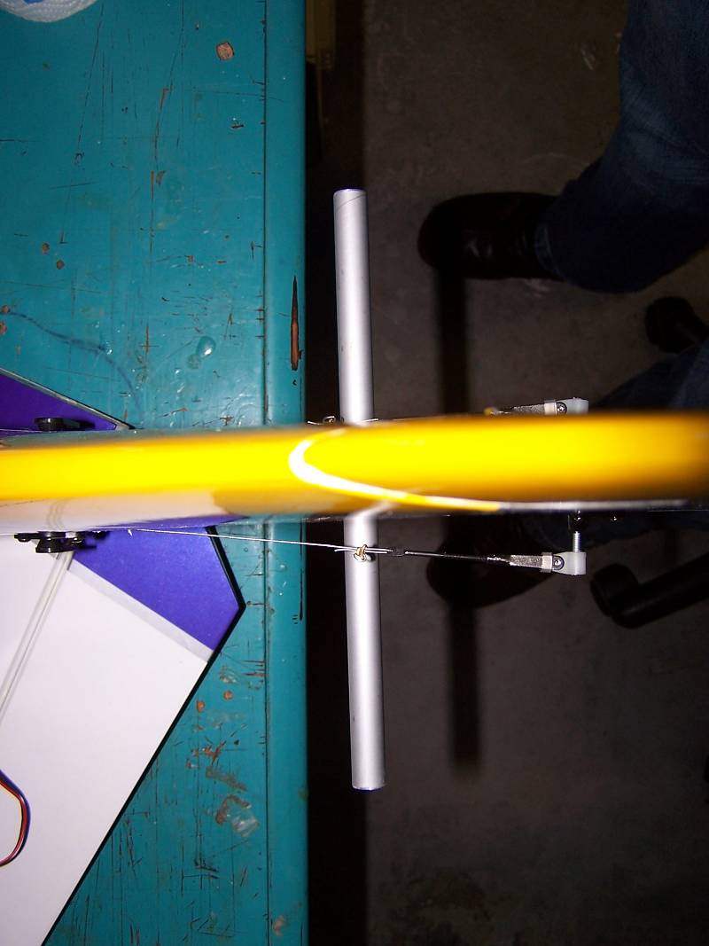

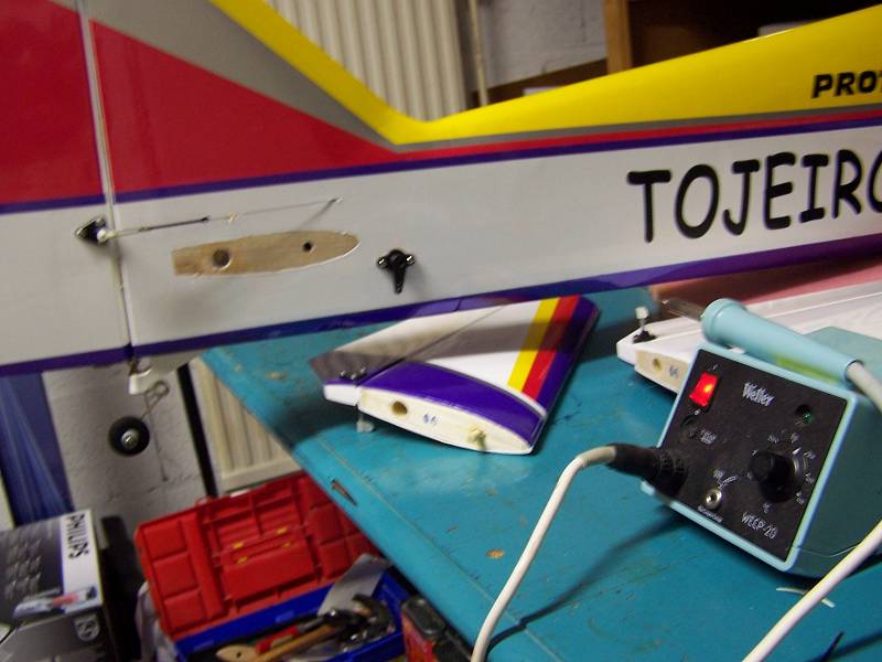

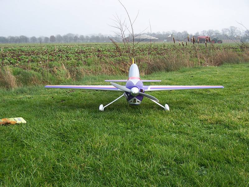

So, this night I glued with epoxy the stabilizer halves to the fuselage. There was a nasty surprise here, since the alignment of the outer tube was not good!!! []. I used a file to widen the outer tube (which is already glued into the fuse), so I could change the angle of the tube, to make it perpendicular to the fuse. Of course, the whole thing then sits quite loose. I aligned it as good as I could, and measures the distance between stabilizer tips and wing tips. Luckily, the stabilizer halves themselves are straight, so if you press them against the fuselage, they come out straight (both the distance to the wingtips, as the angle to the fuse vertically.
I tried to make this visible in picture #1
I removed the oracover of both fuse and stabilizer halves (picture #2, I always use a soldering iron to remove covering), epoxied everything and then hold it 10 minutes. Seems to work out fine.
The flying buddy I mentioned above, who bought the Tojeiro-140 had EXACTLY THE SAME PROBLEM. So, if you are thinking about buying the 90 or the 140, make sure you check this alignment before you buy (just put the tube in, and press the stabilizer halves against the fuse. If there is a gap, it is not aligned correctly). If you order it by the internet, let the shop check this and assure to you it is OK.

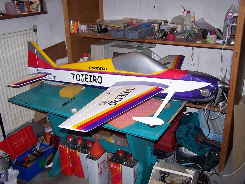

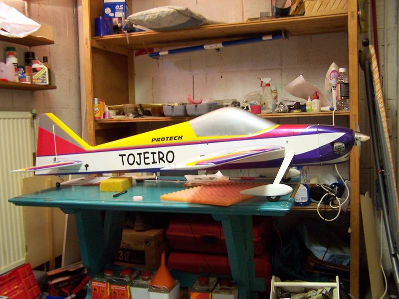

DONE!!! Here is the complete plane!! I will put the engine cover on once the perry/engine is setup correctly.
Murdoc, could you add a picture as well of your Tojeiro with the black canopy?

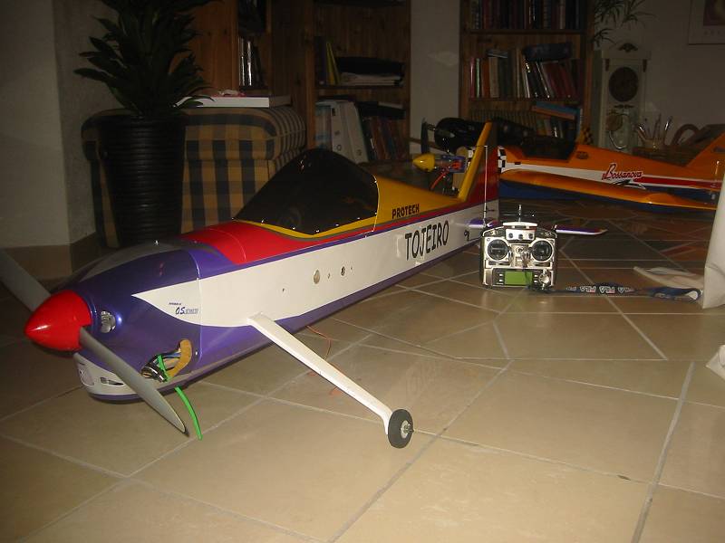

OK, this afternoon had some time to get the engine running. I did not have to touch the Perry pump, so that was easy enough.
I could also finalise the mounting of the engine cover. I also used a Tru-turn spinner (another extra 40 grams, but what the heck!).
So, here it is!
Total weight: 4190 grams. Center of Gravity at 16 cms behind the leading edge. That is one cm more then recommended by Protech, but I will fly it anyway as it is. Hopefully next weekend, since after that I will be travelling for two weeks []

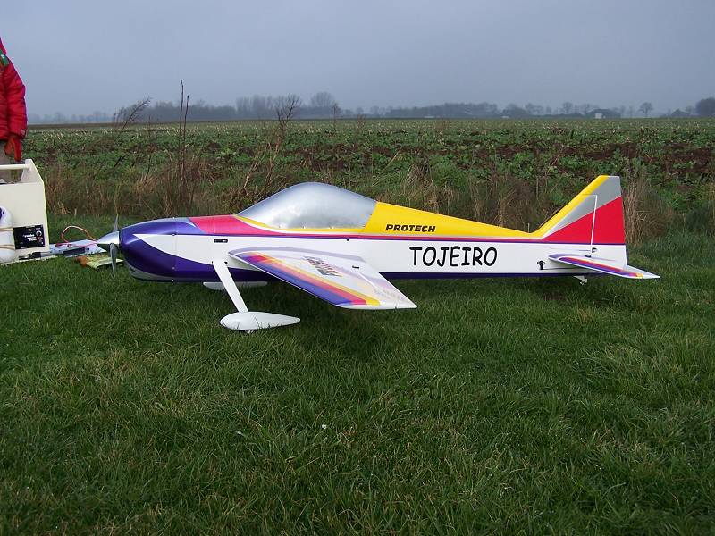

OK, time for a first FLIGHT REPORT!!
Today was a cold and a very damp day. 2 degrees C and low hanging cloud/fog.
After starting the engine I checked the rpm and it is at 9400 rpm with an APC14x10. This is much better then the previous setup, with a slightly longer pipe.
After a final check of direction of all flight surfaces, it was time to fly! After lift off, it needed quite a bit of down trim. The ailerons I did not touch, no trim needed there. The plane flies very fast, and also due to the low clouds I needed to keep the airplane close to me.
The engine is more then capable for this plane. Loops and square loops are flow with authority. You are also able to fly through these figures with more or less the same speed.
Thrust of engine I checked by flying at full speed and then go to idle. It flies on straight. I checked CG by checking the vertical down line with idle. CG (at 16 cm) seems to be right, the plane does not veer to the canopy or belly.
Knife edge needs very little adjustment with elevator to fly straight. With full throttle, I limit rudder to about 30 degrees, but if I pushed it full, it would also go up in knife edge.
Landing was easy, the plane slows down very well, but keeps flying (much better then the Tojeiro-50) well until it hits the ground. I was afraid on landing that the propellor would hit the ground (it sits very low, and the gear seems to flex a bit), but this was OK, despite the long grass now.
I think this is a very capable airplane, which will give me a lot of fun flying! Today, when I flew loops, it would disappear in the clouds, but I am sure you can fly veeery big loops with this plane.
For the next two weeks I have no time to fly (that's why I took now the afternoon off to get at least some airtime!!), but once I get some more time on it, I will let you know. For now, I am very happy with this plane.

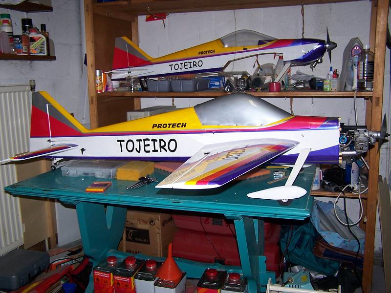

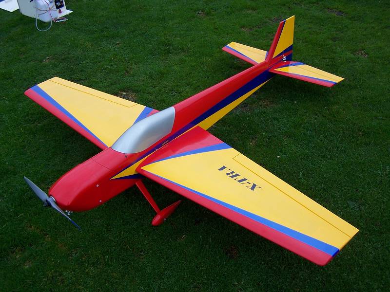

Here is what I have now (off-topic, but what the....)
