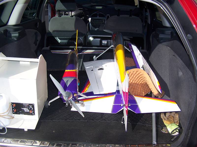

Oh yeah, this one will fly again!
Fortunately,it didn"t hit the ground on its nose.
It ripped out the landing gear and damaged the belly.
The wings are as good as new!
Guess it will take me a few hours to get it up again.
Will fix it now, then go fly tomorrow.
So it is not as bad as I said above, but what can you expect, I was in shock

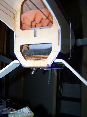

to get a proper tank position, I had already lowered the landing gear on my Tojeiro-50, so on this one it works fine. On my 90, I will just leave it as it is for now.

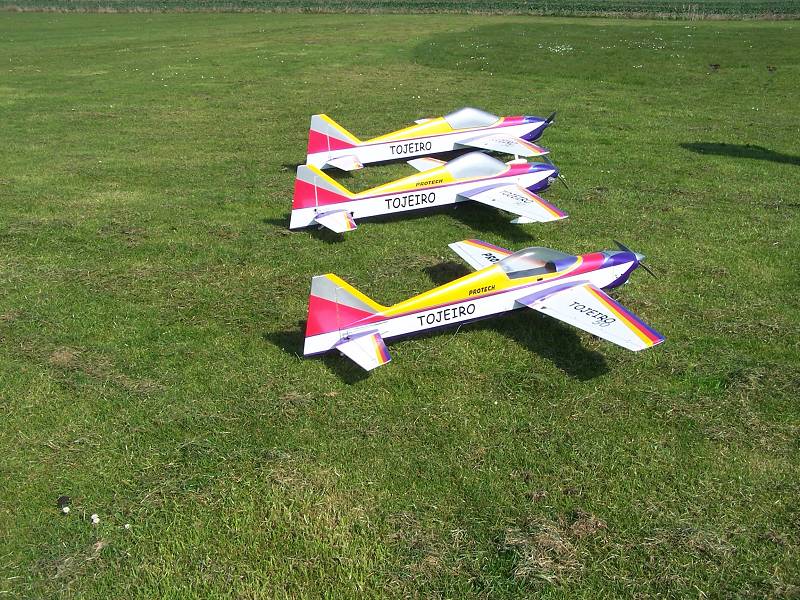

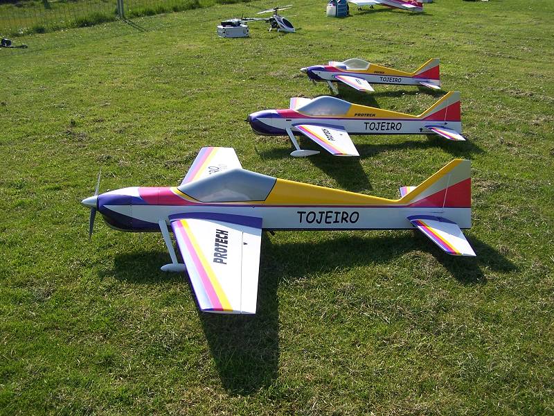

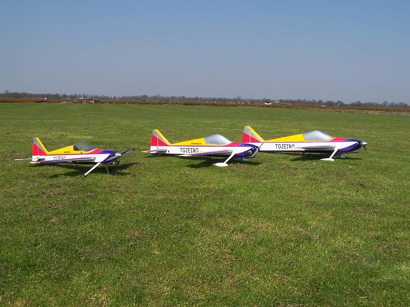

OK guys, proud to present.......three Tojeiro's!
So today was the first oppertunity to have all three models on the field. Unfortunately we could not fly together since on the 140 the engine failed (Irvine 25, crankshaft went thru the housing after 10 years of service!!).
Here are the pictures:

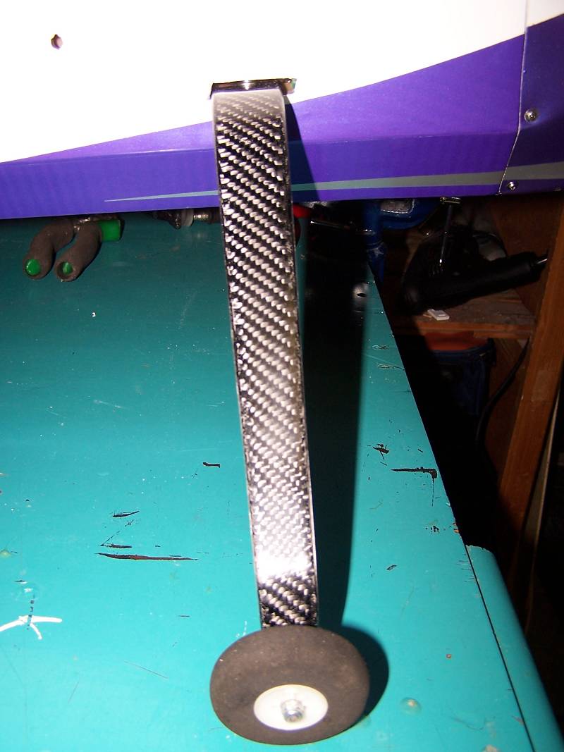

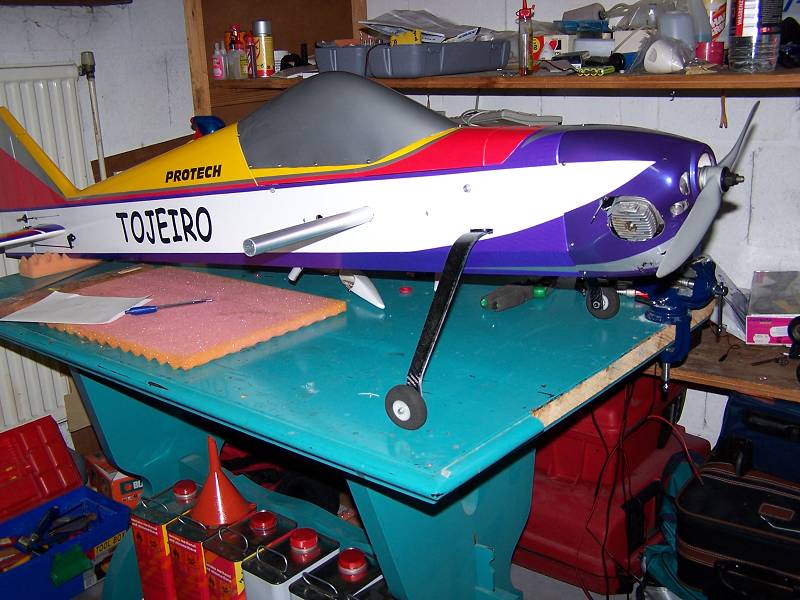

Today I picked up a carbon landing gear. I also decided for now to go without wheelpants. I damaged in an early attempt to go flying on a wet field with long grass also the Tru-turn spinner, so that has been off already for a while!
Main reason for changing gear was weight, and the fact that with the current gear and a 14 inch prop there is basicly NO ground clearance. Also the plane doesn't rotate when taking off, since it simply sits too low.
Weight saving: 150 grams.
Total weight now: 4040 grams.
I will let you guys know if this actually gives better flight performance.
Here two pictures:
Here two pictures:

Who sells this carbon fiber gear you have? I need to modify my gear. Lost a glow plug on takeoff and it hit pretty hard and crack my gear. As far as flying characteristics go, when you roll your Tojeiro inverted does it pitch toward the ground real hard or does it keep tracking level when inverted?

I bought them here at the LHS, which happens to be owned by the Dutch F3A champion, so he has a good stack of materials! It is a carbon gear locally made for a model he designed (it is the same I showed a few pages earlier). They cost 14,95€ a piece.
I am sure they can mail a set, but I assume you can find them cheaper at your side of the ocean.
CG with the old setup was very good, it almost tracked level when rolling inverted (needs just a hint of down elevator). I will let you know how she handles with the new (and lighter) gear.
Volkert

Today flew two flights. No notable difference! I had hoped it would have less of a tendency to stall when going with a relatively slow speed up in a square loop. Oh well, at least taking off is easier now!
