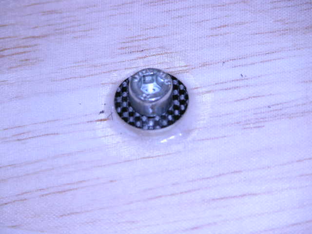

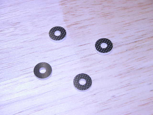

Default The washers
Carbon and light ply. Strong, light, pretty.
Old 02-16-2003 | 12:14 PM
  #104
MarkNovack's Avatar
Posts: 1,552
From: Nameche, BELGIUM
Default Glue them in
We put the thick mixture around the bolt hole, and using a 6mm bolt as the guide, drop it on in. We use a metal bolt here that will easily break free of any stray epoxy that that got into the threads.
Let the epoxy form a nice fillet. I will go back tomorrow with epoxy and fillet any washers that do not have a nice fillet already. The 24 hour epoxy really soaks in, so sometimes the beautiful fillet such as is this photo disappears overnight.

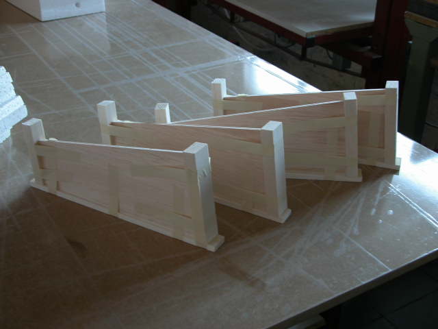

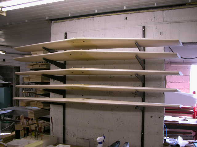

Default Ready for shaping and aileron cutting.
Here sits our five wings all ready to have the tips shaped, ailerons cut free, faced, hinged, beveled, and horn plate mounted. Then final sanding and boom, off the the coverer. Not to much longer and we will be working on the forward fuselage internals!!!

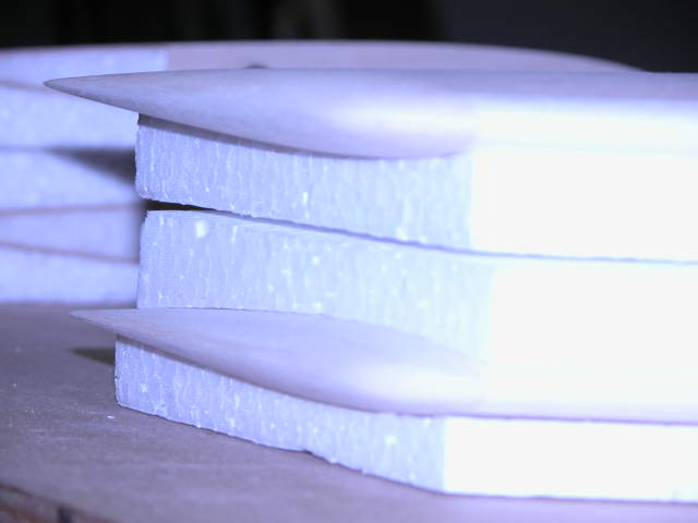

Default We are keeping busy!
There was some space in the day so I started getting some of the sanding out of the way.
We have no special trick for tips. I scribe the center line on the tip, razor plane them until they have a nice basic form and then smooth the planing flats into a nice curved surface. It's a combination of sanding and looking and sanding and looking and, you get the idea. Anyway, nicely rounded tips that are even between the two stab halves. Some people prefer a larger radius, some more narrow radius. I'm not sure if it makes a difference aerodynamically.
Here is a photo of the finished tip. Now when I chop off the elevator, the tip will flow smoothly from front to rear.

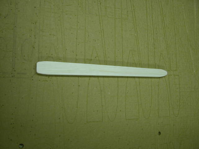

Mark Novack
US Army
ZNLine

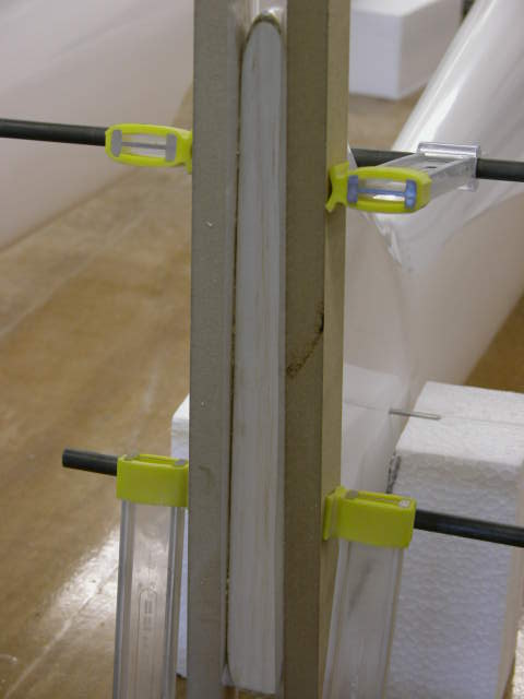

Default Back to work
Yesterday was more of the same. Sanding, stab mounting, and now the airplanes are almost at the same stage. So, continuing on, today we faced some rudders and closed the tail. I like the tail closing step. It's really easy and is a landmark in the building procedure after all of the little things done inside of the fin.
Here is a shot of the fin post. It's about 5-6 grams and is a perfect fit out of the box.

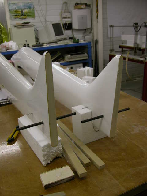

Old 02-18-2003 | 04:32 PM
  #111
MarkNovack's Avatar
Posts: 1,552

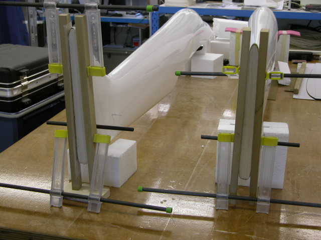

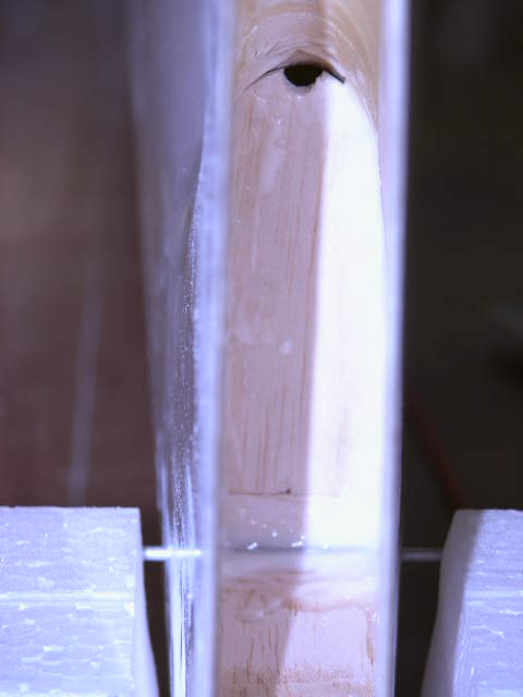

Default And here it is installed.
I could not think of anything else that needed to be photographed here. A little epoxy/microballoon mixture and the post is inserted flush with the rear edge of the fin. A small notch at the bottom of the post is made to key it to the tail wheel block.
The most important part here is that the fin is clamped flat to the post. Our clamping blocks are very straight pieces of high density particle board that are longer than the fin post. The Burna clamps provide nice gentle, but firm pressure.
This will sit for twenty four hours now. In the mean time we will start elevators and the rudders, keep sanding more tips, and get to the ailerons too.

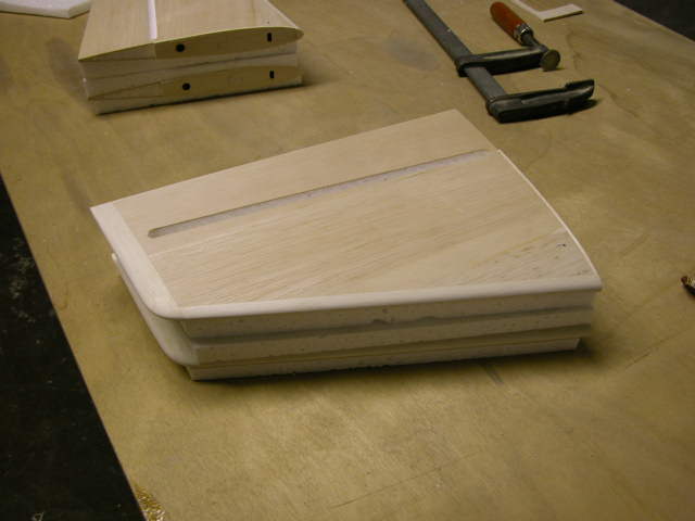

Default Elevators
Well, beofre we make our hole for the MK elevator device, we shall cut and face, hinge and bevel our elevators, inlay the ply horn mount and attach our horn. This way we can establish the perfect relationship between the horn and the MK device arms.
The first thing we do it mark the stabs and elevators as to not get them confused.

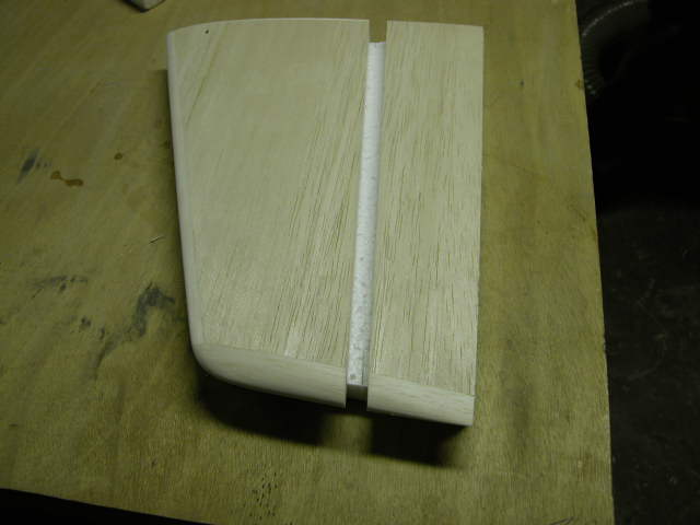

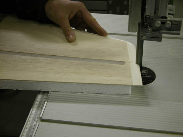

Old 02-18-2003 | 07:38 PM
  #115
MarkNovack's Avatar
Posts: 1,552

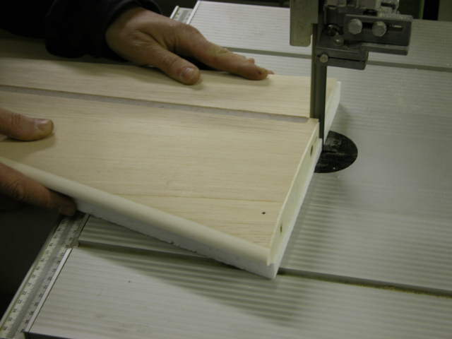

Default Now we cut away the elvator.
We have a fully equiped factory, so we are taking the easy way, but this step is just as easy with a hobby knife and sanding block. When doing five stab sets, this is easier.
Old 02-18-2003 | 07:39 PM
  #116
MarkNovack's Avatar
Posts: 1,552
Default Turn it around
We pull back, turn it around and cut the tip.
Old 02-18-2003 | 07:43 PM
  #117
MarkNovack's Avatar
Posts: 1,552
Default The cut portion
Don't risk slicing too much. Cut it reasonably close and let your sanding block do the rest.

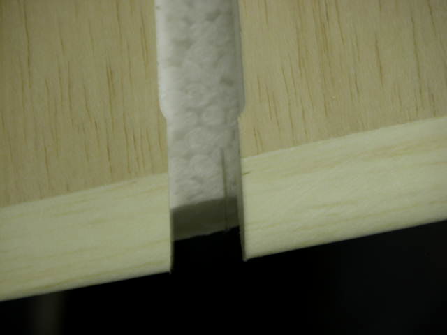

Old 02-18-2003 | 07:48 PM
  #118
MarkNovack's Avatar
Posts: 1,552
Default Sand the face even.
Do not cut away any of the face. Only the extra tab. The stabs and wings are perfectly routed to accept 7mm facings. Most people will do very well with a sanding block. It takes expert hands to use the belt on on such soft wood.

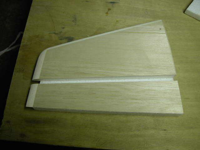

Default Face the pieces.
We use 7mm facing on both elevator and stabs. We will use wood glue. There is no danger of warping the piece with the wood glue due to the over width of the facing. We have a bit more to cut away when it is dry, but it keep everything in line and straight. Here are a few stabs and their elevators drying away.
Next I will reduce the faces and ends on the rudders, then return to the stabs to plane down the faces.
That's it for tonight. We will return tomorrow for more Enigma building.
Mark

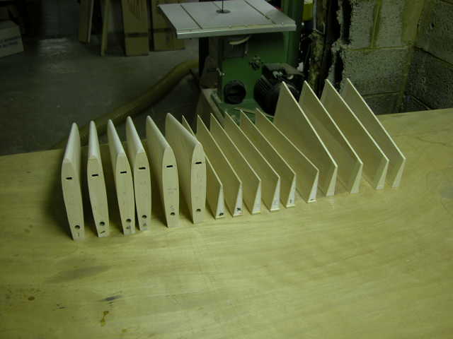

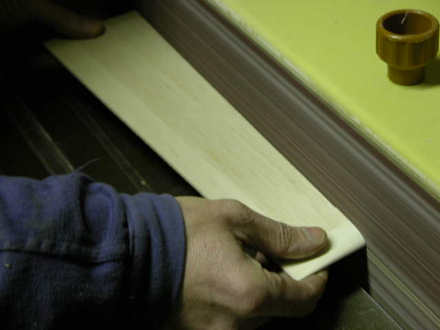

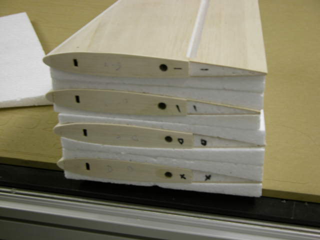

Default Then I sanded.
First, I very carefully fed the elevators through the band saw to cut away the excess. The stabs would not fit under the band saw feeder guide, so I sanded it down to about 2mm or 3mm on the belt sander. Same with the rudder.
After cutting them down I started in with the razor plane and then finished by hand with my big sanding block.
The tips I shall round down tomorrow when I am feeling refreshed.

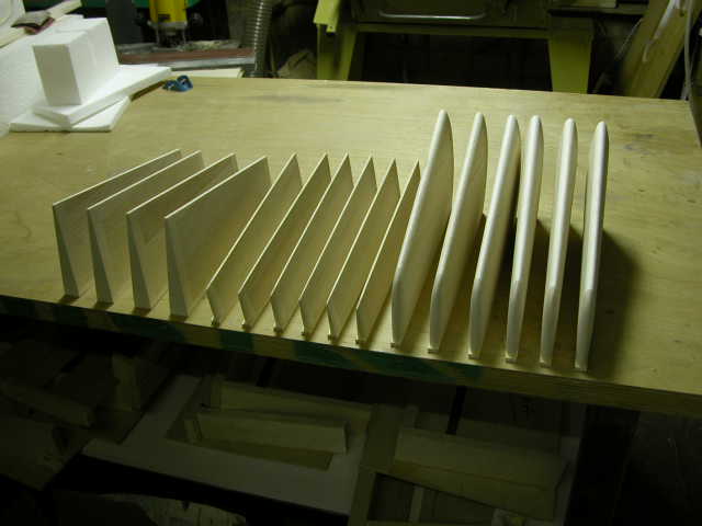

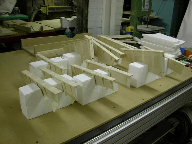

Default ANd the tip view before rounding of the tips
The pieces are not simply on display. I think that it is necessary for them to sit like this so that the air circulates evenly around the control surfaces. This will prevent any tendencies to warp from uneven climate exposure.
Another couple of stabs, then I can move on the ailerons. Same procedure, just a little bit longer.
