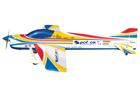

Anyone have done a review on this yet ?

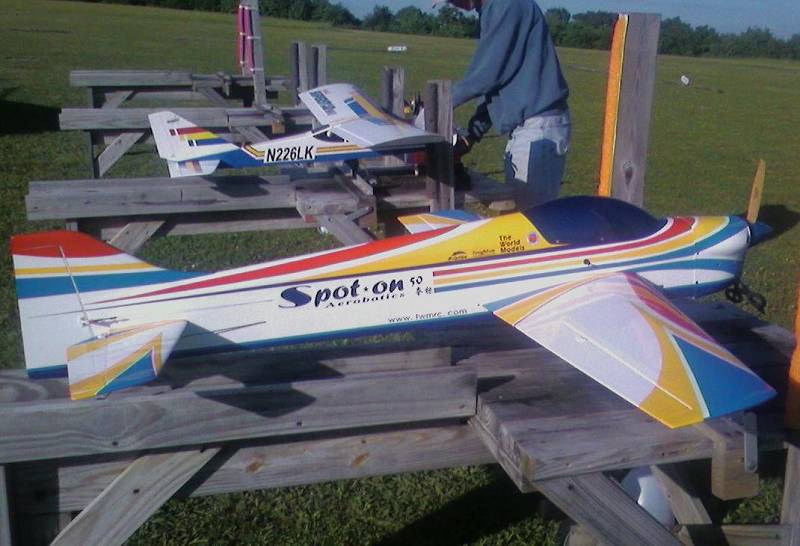

Here is aPicture of the Spot-On 50 at the Airfield today. The quality of the Picture is low becauese I took it with my cell

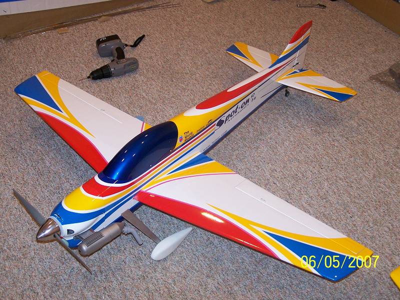

Made by: The World Models, distributed by www.airborne-models.com. Very un-expensive.
