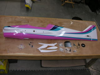

Old 05-28-2007 | 11:39 AM
My Feedback: (19)
Posts: 371
From: Rayne, LA

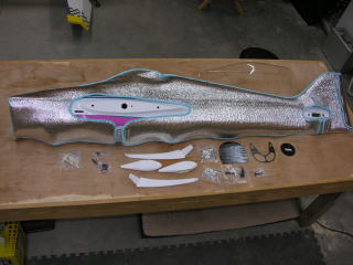

Default Shinden Build
All of the parts came in perfect. Everything looks great !
ID:	692919   Click image for larger version

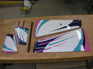

Old 05-28-2007 | 11:40 AM
My Feedback: (19)
Posts: 371
From: Rayne, LA
Default RE: Shinden Build
More parts
ID:	692922   Click image for larger version

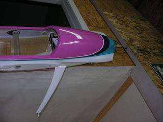

Old 05-28-2007 | 11:50 AM
My Feedback: (19)
Posts: 371
From: Rayne, LA
Mounting the landing gear. As you can see the holes are not drilled to mount the gear to the gearbox.
Cut a small square of paper and tape it to the gearbox. Then, using a punch find the holes. Place
the gear over the paper and trace it out. Remove the gear and match up the paper with the gear and mark the
holes with a marker. Drill the holes for a perfect fit.
ID:	692928   Click image for larger version
ID:	692929   Click image for larger version
ID:	692930   Click image for larger version

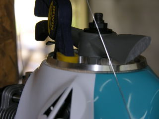

Old 05-30-2007 | 12:39 PM
My Feedback: (19)
Posts: 371
From: Rayne, LA

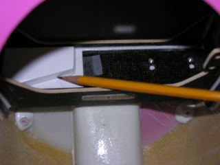

Mounting the engine:
First: hang the fues on a wall.
Second: clamp the engine with the motor mount, back plate and prop to the
nose of the cowl (make sure to to put a 1/16" piece of balsa between the back plate
and the fuse).
ID:	694232   Click image for larger version

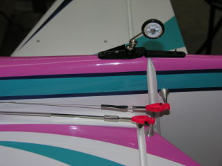

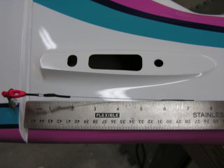

Old 05-31-2007 | 08:06 PM
My Feedback: (19)
Posts: 371
From: Rayne, LA
Rudder pull-pull
ID:	695134   Click image for larger version
ID:	695135   Click image for larger version
