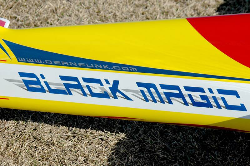

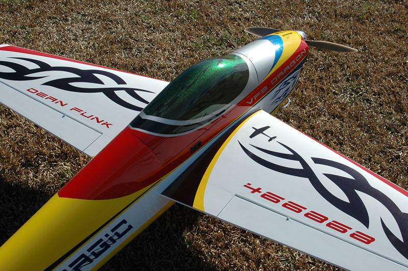

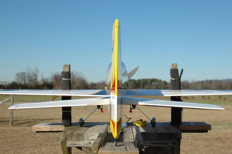

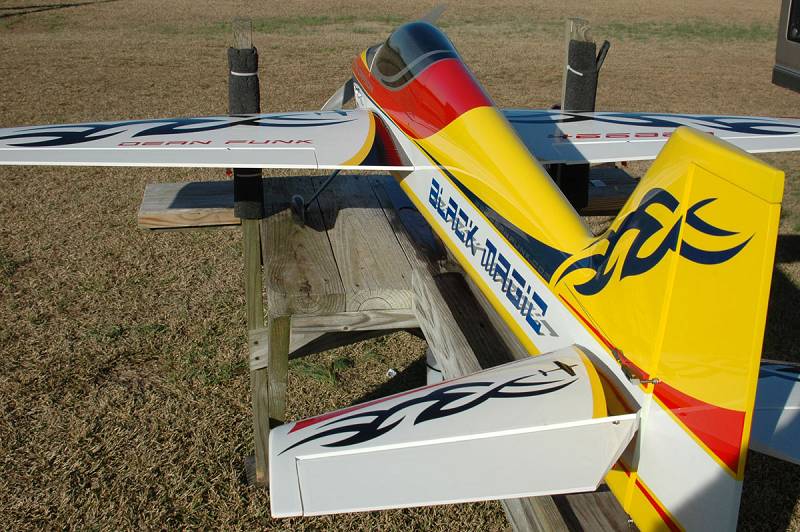

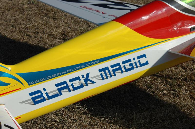

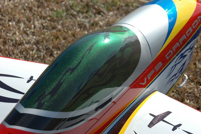

(warning - you are entering the Black Magic Love Fest
BIG DAY!!!!
Well I finally got my own personal VF3 in the AIR !!!! YS 170 and the new anhedral stabs....
I got in 4 flights, required almost no trim right of the board, I am flying it with ZERO mix and no throttle curve. The 170 is amazing, the plane lifts off before you get to half throttle, you feel every click on the throttle stick. The plane has unlimited vertical at half throttle with a 18.1 10w
On right knife the plane is perfect with no belly pull and really locks in - on left knife - the entire length of the field - the plane seems to be as neutral as right. At this point I am not mixing any ele-rud. No tendency to roll out from knife on either rudder. Very little rudder is required to maintain level flight on knife and the plane flies very horizontal with the tail high.
On either knife, I would slowly decrease throttle , the plane would stay perfectly locked in knife edge flight but slowly start sinking, as I would increase throttle the plane would start climbing, the entire time maintain perfectly locked in knifed edge flight wit no roll or pitch out. I have always been impressed with guys like Archie doing 1000 foot long knife edge passes on the deck. He made it look easy with his vf3, and now I know - yea it's super easy....
Rolls - okay this plane is optimized for axial rolling maneuvers - perfectly clean and unless your doing horizon to horizon slow rolls you only need to bump down elevator. The V2 that I have been flying for a couple years rolls great, this plane rolls like it's on a laser beam. Whit no tail wag.
Snaps, okay not a violent as my v2, but the vf3 has a sharp break and a clean exit with little displacement, very user friendly. Spins are easy...
I did a couple rolling loops and a knife edge loop, super easy and fun. Stuff I need to practice but very respectable for the first day out and no practice.
The only mix I am considering in down elevator to idle just to clean up my down lines. maybe 2%.
What really amazed me how "connected" you feel with this set up.
The plane is at 10 3/4 lbs, the CG is at the front of the wing tube, wing incidence is at +.7, stab incidence is about +.2 - on high rate I have about 12 degrees and low rates about 8 degrees of travel on the elevator and ailerons. I've got my rudder at 35 degrees on high and 20 on low. Very little control throw is really needed for in-box flight
All in all it was a great day out at the field, the plane did outstandingly well, a very happy day !!!
enjoy the pics and thanks everybody !!!!

Dean,
Looks great. Mixes and such sound about right with what mine was. Try the 18.1 X 11 prop on it. I have an 18.1 X 12 to try when I get my stuff back in about 10 days hopefully. Plane looks great, now just bring it out ot TX and lets play..

No the VF3's anhedral stabs are an add on that is specifically for the upper classes. The plane has a little more touchy feel to it with the anhedrals than with the straight stabs and the rudder is even more effective. I wouldn't use the anhedrals unless you are flying Masters of especially FAI. There really is no advantage unless you are flying those classes.
Chris,
When I put the anhedrals on my V3. It got rid of all my mix. It had 3% in it when I started and it was gone after the anhedrals, except for the 1% down elevator to throttle mix. The elevator definitely had a touchy feel to it now...which I love, but some others might not. The rudder is also more effective.
Arch

That is beautiful Dean! Makes me want to build one! Is it all paint?
Greg Grigsby

thanks Greg and everybody... !!
the wings and stabs are monokote with vinyl graphics, the fuse is 100% all paint.
Greg, if you decided to build one I could help you by framing up the fuse crutch. once the crutch is completed the rest of the build goes like a snap. My new plane posted here on page 37 of this thread is the same plane pictured in the bones way back on the original post along with my fixture jig. I did all the wing and stab tube alignments and thrust line in my jig.
What was really cool about yesterday, is I did all my set ups on the bench, CG, incidences, and the plane so far has trimmed really well with zero mix. It flew right off the board with no additional trim. Now I am looking forward to a trimming session with Arch but with all indications so far my VF3 will be without any knife edge mix.
I just can't get over how nice the plane rolls.

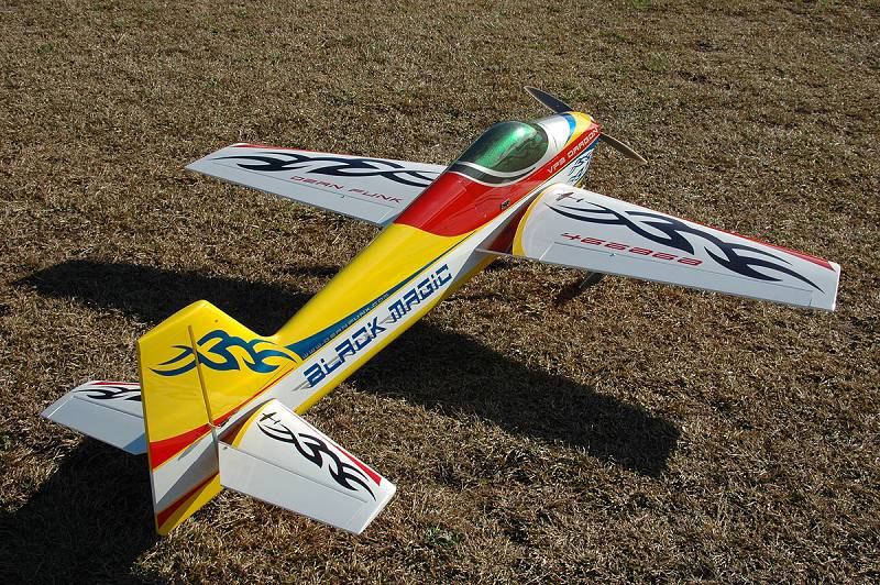

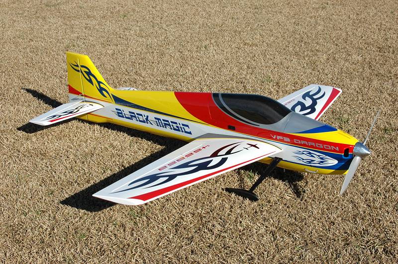

Dean great looking airplane. What landing gear and wheel pants did you go with looks like bolly and did you use the small wheel pants.
Stephen
Old 12-31-2008 | 10:22 AM
  #924
handglider's Avatar
My Feedback: (23)
Joined: Mar 2005
Posts: 1,097
From: ,
Default RE: Black Magic VF3 Build Thread
It's the Bolly large FAI and small bolly wheel pants, right now I am running the rubber 2 1/4" dubro wheels... I'll be able to pull almost 2 oz off the plane later when I switch to the lite foam wheels.

Can the anhedral stabs be retro fit onto an existing V3 or does it need to be originally built with the anhedral stabs?
Woodie
