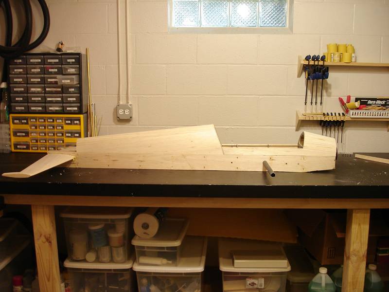

Thanks Dean,......T</p>
The table is a mess again,my wife expessed her dislike for the beer can clutter. So,...I like beer and pepsi one, but not at the same time I can cover the VF3 like a Heineken bottle and then park it next to Chris's Monster VF3,....</p>
</p>
Larry,...the engine mount lenght worked out to around 6-3/8 as you indicated. Going to work on it most of the day friday. Have some engine pulling and re-installing to do, so I can get the cowl, chin cowl and landing gear all sown up. My bud Scott is drooling and wants one now to begin pattern with.</p>
</p>
Let's Gett'em Done!!!!</p>

Ithink you need to put some ice in that "Airplane Stand" to keep those beverages cold.

Oh so that's how you guys are able to "build" so many Black Magics - you have MIKE frame them up! THAT's whatI'm doing wrong! LOL
Looking good Bill - you should have that done pretty soon. Mine are almostat that stage. I probably won't have one done in time to trim it outso that I canfly it at the NATs' though so I'll be there with my V2.2 again.

Hah,............I don't get anything done when it has ice in it,....................hence the beer cans!</p>

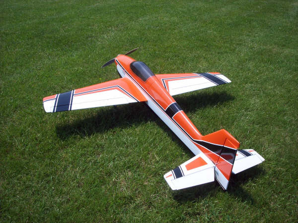

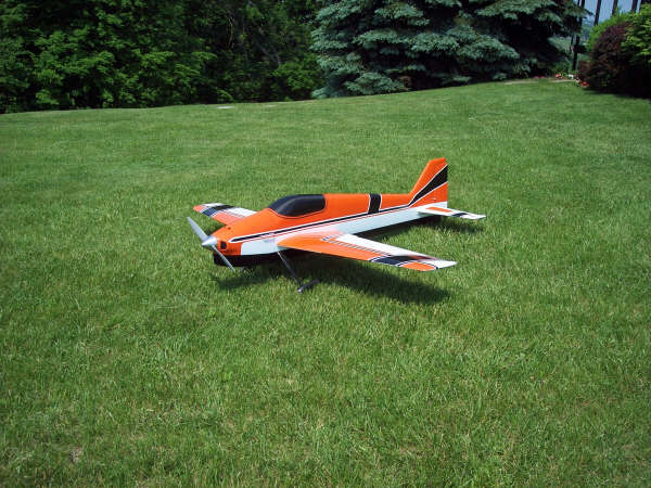

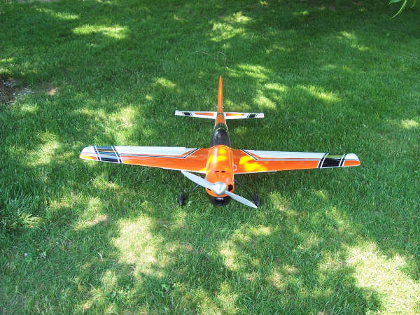

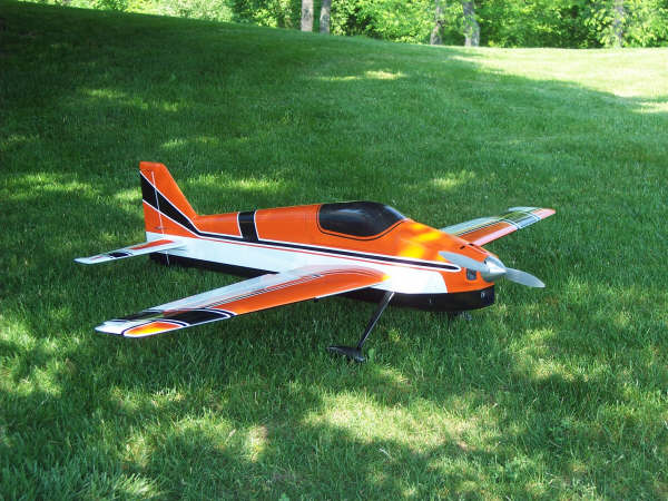

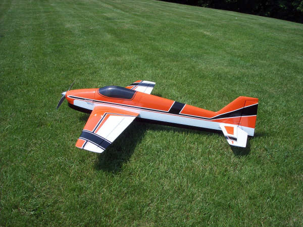

Posting for Rick Cilles. Great job Rick. 10lbs, 13oz with an OS 1.60. Rick can post the specifics, but had problems getting photos to post.

That Airplane looks awesome. It seems to have a Very Clean look to it. which is what I like.</p>
Great Job Rick!!</p>

Thanks for posting the pics Arch! Long and winding road to "giterdone". This was our 1St 2M ship and there were many self imposed tribulations. (SCREW UPS)     Changed horses midstream more than once. Started to go with uv cure primer and water based urethane and ended up  going with "old school" buterate. Nitrate with silkspan was a joy to use and added only 5 oz  to entire airframe wings and all. UV primer was a heavy mistake but we were still able to make weight. Next time I will use nitrate, silkspan, sanding sealer and buterate. I can't back it up yet but I will wager that the total finish from bare balsa to buterate clear can be done adding less than a pound. OS160FX per Jon Lowe with VP 30 and ES pipe. We have had great luck with this set up. JR servos all around. Thanks to all who helped out with advice and support!</p>
                                          Rick </p>

NIIIIIIIIIIIIICCEE!!!!!!!!!!!!!</p>

Yeah Mike another 'Magic covered with silkspan.Isn't it pretty? I hopeI started something.

Nice job Rick, your son is styling for sure.
seems like black magics are popping up everywhere !!!!
very awesome my friend !!!!!

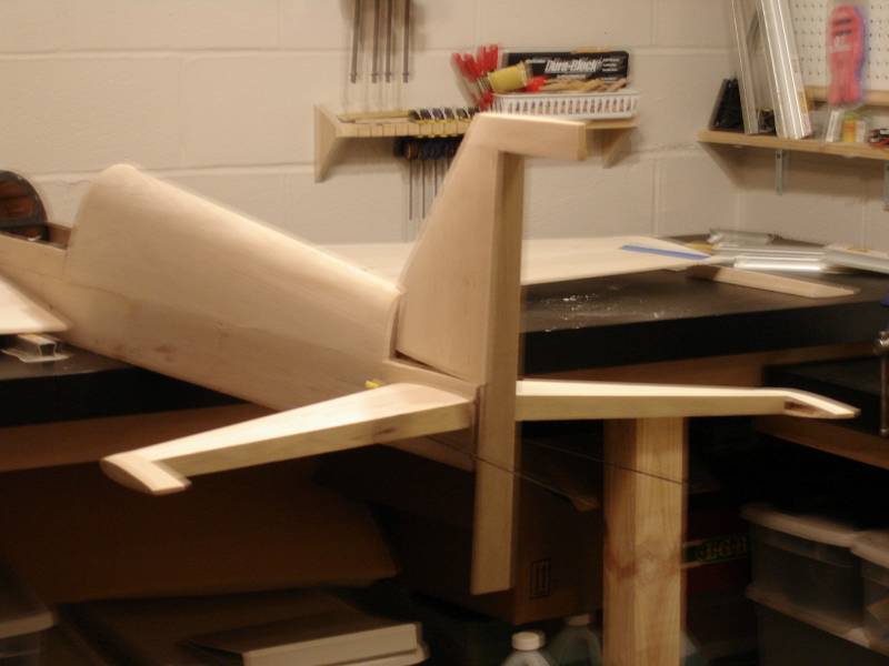

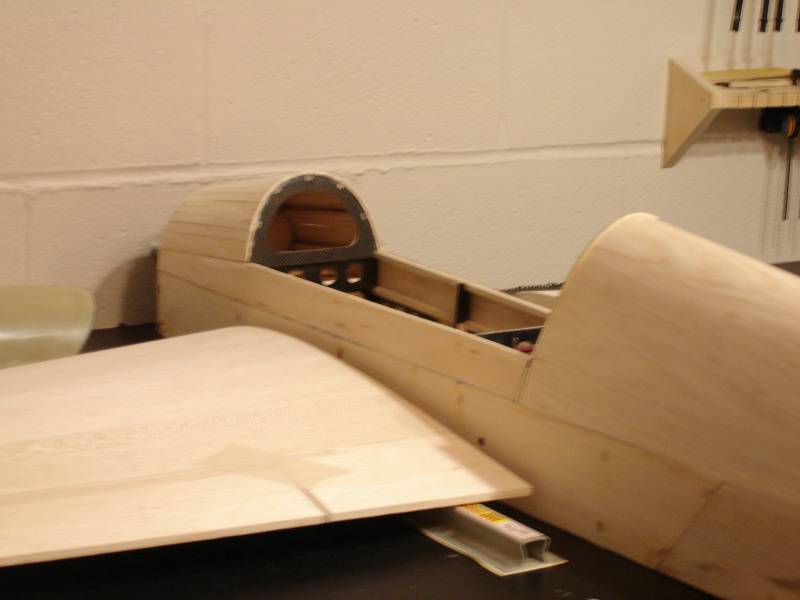

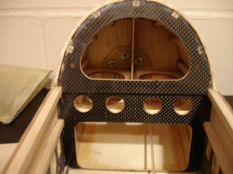

Thanks for the information guys. Ifeel loved! Afew more questions:
1. How do you guys deal with the vacuum created by the wing tube sockets on the wing tube when they're capped off. Its so bad Iput the left wing socket on and the right one nearly shoots off. Iwanted to launch it across the basement but these carbon wing tubes are too hard to come by.
2. Where are you guys locating your spring-loaded hatch latches for the canopy in the fore end of the turtledeck? I want to be able to lift the canopy off in the rear by sliding both right and left adjusters back with my hand. The front of my canopy has two cf pins going into the former in front.
3. The instructions go into detail about sealing the gap in the canopy/fuse joint but I need some help before Iget that far. First, Iwant to put the clear tape on the canopy and the microballons on the fuse so the fuse joint is hardened by the microballons and protected. However, Idont want to get epoxy/microballons all over my carbon fiber. Thoughts?
4. Contact information for Richard at YS. Email preferred.
5. If you take a look at the overhead view of my H.stab the right stab (on your left in the photo) looks like the hinge line is not parallel to the left stab. When fitting the stab roots to the fuse I cut more off the left stab root end and Ithink Ineed to do the same on the right stab so it brings the hinge line parallel...but it might not, since the stab tube is in there holding it where it is. Does it look off, or is it just me?
Thanks again guys!
Oh, enjoy the pictures! At this point everything is just set in place for the photographs. Once Iget the stab and wing sockets glued into the fuse Iwill get everything looking perfect and get this thing ready for glass.
