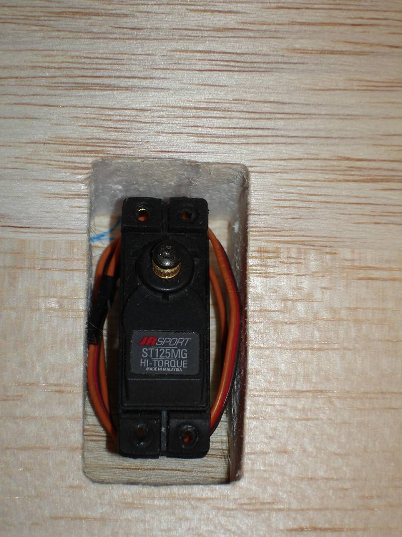

Could someone post detailed pictures of their aileron servo mounting setup? I have the pre-sheeted wings from Mike and the hole put there is much bigger than a servo. I would have done it differently so please show me some of your guy's setups so I can get back on track.
Thanks!

Cut it out, and line it with balsa...then stick the servo in....unless you're using a micro, it's about perfect. 1/16 or 1/8, doesn't matter as long as it's light.
You don't want a tiny servo on this aileron. A JR9411SA is minimum. And it fits with enough room on the side for a wire. If it's too tight, the wire binds and rubs, and that ain't good.
-Mike

Here is a picture of what I am looking at. I would like to keep the weight down but I get the feeling I will need to add more material to have the strength/durablility necessary for a high quality aileron servo setup. By the way. The servo in the picture is NOT the servo I plan to use but only being used during construction as it is the standard size servo like the better one I plan to pull out later.

I don't see the problem with it...
By the time you line the cut-out with balsa it should be a nice fit. No doubt the cut-out allows for the Futaba S9150 style servos which are a little different to standard servos.
Just my $0.02 worth...

When you guys are saying line the opening with balsa I am picturing 1/16" sheeting. Sounds like it will need to be as thick as it needs to be to accomodate the servo of choice.

One would think that lining the servo cut-out with balsa was a standard practice? It certainly stiffens the whole area up. Which is what I think you're after.
I would use 1/16" balsa to line the cut-out and then make a small servo tray out of 1/8" ply. If you wanted to you could then use some balsa on top of the ply plate to fill any gaps for a neat fit around your servo and sand flush with the skin.
Probably many ways to skin the cat and this is probably why Mike has not said too much about it in his manual...

Chris, it isn't that critical...at all. Line it with 1/16 balsa first. Don't worry about strength, that hole could be 4 times that big and still fine.
Next, put 1/4" x1/8" lite ply or basswood or whatever rails in, and check again. On any standard sized servo I have ever used, it's perfect. On some, it's TOO small.
This gives plenty of clearance for the wire exit from the servo without chaffing. if you've had one chafe and go out before, you'll ALWAYS give plenty of clearance in the future. This is cut with the same template that I use on my own wings. it's not an accident.

And yes...you can mount them sideways, use 6 different sizes, aluminum rails (I wouldn't suggest it) and that's exactly why I don't go into a lot of detail about stuff like this. Don't make the mistake of over-thinking it. Keep it simple. Light, and simple. Don't add too much stuff, as the plane will get heavy, and doesn't need it. That is a THICK wing for instance, and it would take a lot to snap one. To date, I have sheeted over 200 VF3 wings alone, forgot how many V2s and before that a zillion more, and have never heard of one snapping, ever.
But if you feel you have to fill it in until the servo is darned near encapsulated, have at it, but don't let the wire bind/rub, and keep it LIGHT.
If there's a pretty open area, as far as not a lot of detail, it's because it probably doesn't matter. Again, don't try and over-think this plane. It's simple, keep it that way.

That looks like all the cores I've gotten from Mike in the past, I've seen the templates Mike uses to cut servo wells, hard points, honeycombing, etc into the cores.
Chris I know it looks like it's big, I usually use 3/32 wood to sheet the servo box and make rails out of 1/8" lie ply.
I am running a JR 9411SA and it's the servo we have been flying, it fits well..
What I do is mount the servo flush and seal the entire opening with vinyl. here is the setup on my new plane. it's clean, but underneath it's just the basic box with servo rails. use 5 min epoxy and a brush on the sheeting wood and 5 min to glue in the mounting rails.

Plastic servo arms with ball joints are not a good idea. The ball joint puts a tangential load on the servo arm since it's mounted on top of the arm. This causes it to twist and eventually break. Either use a metal arm or a wheel. Clevis' transfer the control surface load force directly in line with the servo arm but a ball-joint does not. There - you were warned. LOL
cmoore806: You don't want the servo to fit snug in the hole. This will transfer vibration to the servo, even if you're running an electric motor. This should be avoided. That's why servos have rubber grommets. Allow them to work. Just line the hole with 1/16" balsa (orientate the grain vertically) and mount the servo with lite ply or hardwood rails. If you really want to make it bulletproof and neat, make a lite-ply rectangular servo "tray" that fits snugly into the servo cutout while maintaining at least 1/32" clearance to the servo on all 4 sides. Glue this into the servo cutout. Done.
