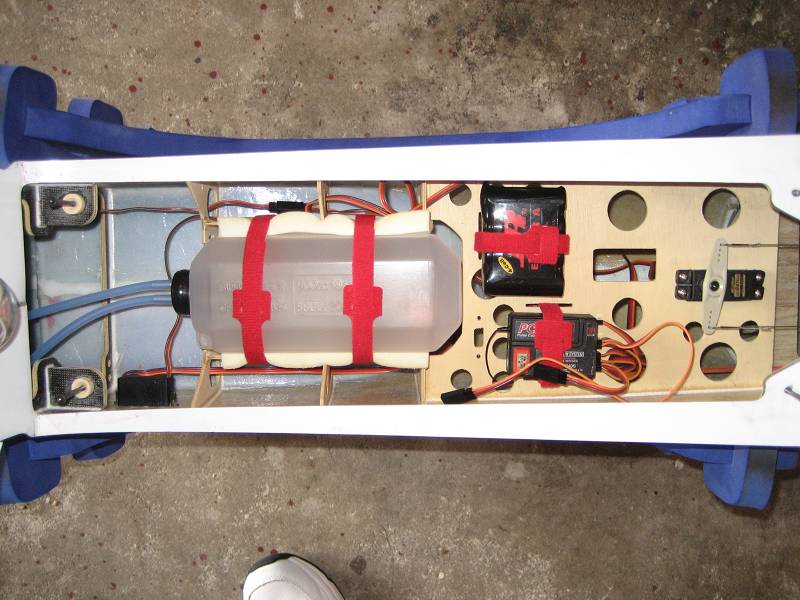

Hey Joe,
If you reroute your vent line (a lot of people use aluminum tubing to save weight) back behind the fuel tank and then to the front of the plane I think it should get rid of your dripping problem.
The plane is gorgeous though, congrats. Looks like you really put it together nicely.
-Brett

Joe,
Just pop a check valve on your vent line.
Greg Grigsby

Ahhh - Excellent idea! thanks Brett. I'll try that this weekend. I am also installing the remote glow ignition. I had a minor backfire on start-up that was less than kind to the belly pan...
For the air line, does it matter if the line is higher/lower than the tank?

The check valve works well but complicates the fueling system. The same valve that doesn't let fuel escape while flying won't let air escape while fueling. Somehow you have to vent the tank to the outside, a tee in the vent line with a plug or similar setup will work.

That's true, you do need a T-valve for the over fill. I've been using it for a couple of years and haven't had any issues so farrrrr?

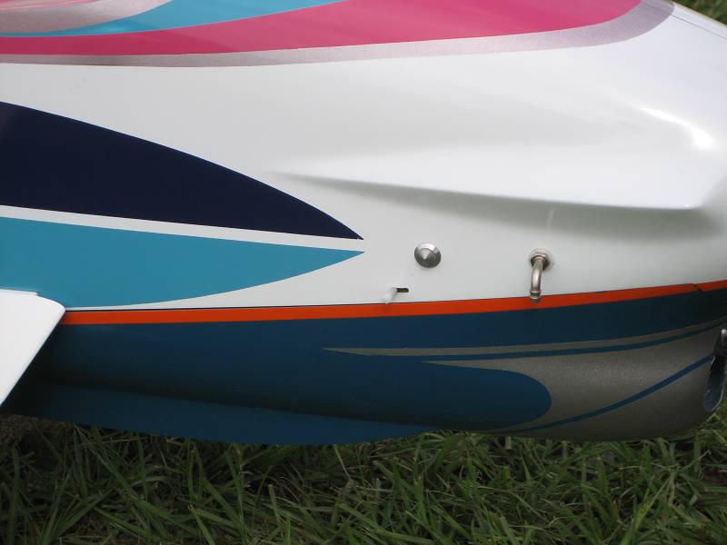

Where is the drawing at?
Old 09-10-2007 | 10:13 PM
  #88
Joined: Feb 2004
Posts: 796
From: Oakland, CA
Default RE: Extreme composite Pro-Line
Joe,
I'm attaching some pictures for you...
picture 1 shows the check valve
picture 2 shows the vent line coming from the tank to a T - one line goes to the check valve and the other to the outside and a fuel plug
picture 3 is up close and personal and you can really see the DIRT and T [8D]
picture 4 is vent line to the outside and the fuel plug
BTW, I see you mounted your servos in the stab... can you take some pictures of that install?
Thanks!

Actually Riot, it's not tail heavy at all. I debated on several ways to set up the elevator and decided on the servos in the tail because it looked a little nicer. The servo tray is already installed from the factory for a push rod set up. I don't like long push rods at all, so it was between twin servos or cables. The only thing that ruled the cable out was I didn't like the way the servo looked hovering over the rudder servo. Cheesey reason, but I suppose that's my perogative.
My comments with regard to the nose weight earlier were actually counter intuitive. The flight characteristics would have suggested moving the CG further back towards the tail by conventional wisdom (yours, actually), but I was experimenting with the nose weight based on converstaions with Bryan Hebert and Ryan M. It worked. Moving the CG further forward improved everything I hoped it would. Less mixing, better spins and snaps.
Derek,
Thanks for the pics! I like that set up. You'll notice on mine that I didn't even bother with the needle adjustment. I played with it a little with the belly pan off and have just tweaked it a bit from time to time. No need for a big ole nasty hole in the side of the plane!
I'll snap some more pictures of the stab set up and post them for ya. basically, I set it up just like my Impact (which was just like Jason Shulman's Impact). The base of the servo pokes into the fuse.
Joe W.
Excellent Joe. What servos are you using in the stab?
I did use remote glow on the Astral XX initially but I had trouble finding a product where the attachment stayed on the glow plug. I tried several different products and then at the Nats last year I finally gave up and went to a hole in the belly pan instead. The issues I had with the remote attachments were that they tended to loosen up over time and came off. With the head lock type they were difficult to get on/off when one used the short type (the long one didn't work because of the wrap around header. See the picture below with the short head lock version.

From: West Australia, DC, AUSTRALIA
H Joe
Thats very informative to read...well done! Looks like you have got a good setup their...I have only one question though...what happens to the air in the tank when the time comes to re-fuel? where does that pressure go?
As far as i see it the vent needs to be able to flow airpressure both ways ie. vent pressure for re-fuelling & to releive the vaccum created during flight!
And in a perfect world needs to not leak fuel.
How does one acheive that?...i would love to know
Regards Scot
Old 09-12-2007 | 06:00 AM
  #100
Mastertech's Avatar
My Feedback: (31)
Joined: Nov 2004
Posts: 1,411
From: Dalzell, SC
There's a fuel dot between the tank and the check valve. This is the vent. The check valve allows air in during flight and the dot allows air out during fuelng. I'm assuming you know what a fuel dot is. It's nothing more than a plug in a fuel line. This system requires a Tee fitting between the tank and check valve or a 3rd line from the tank.
