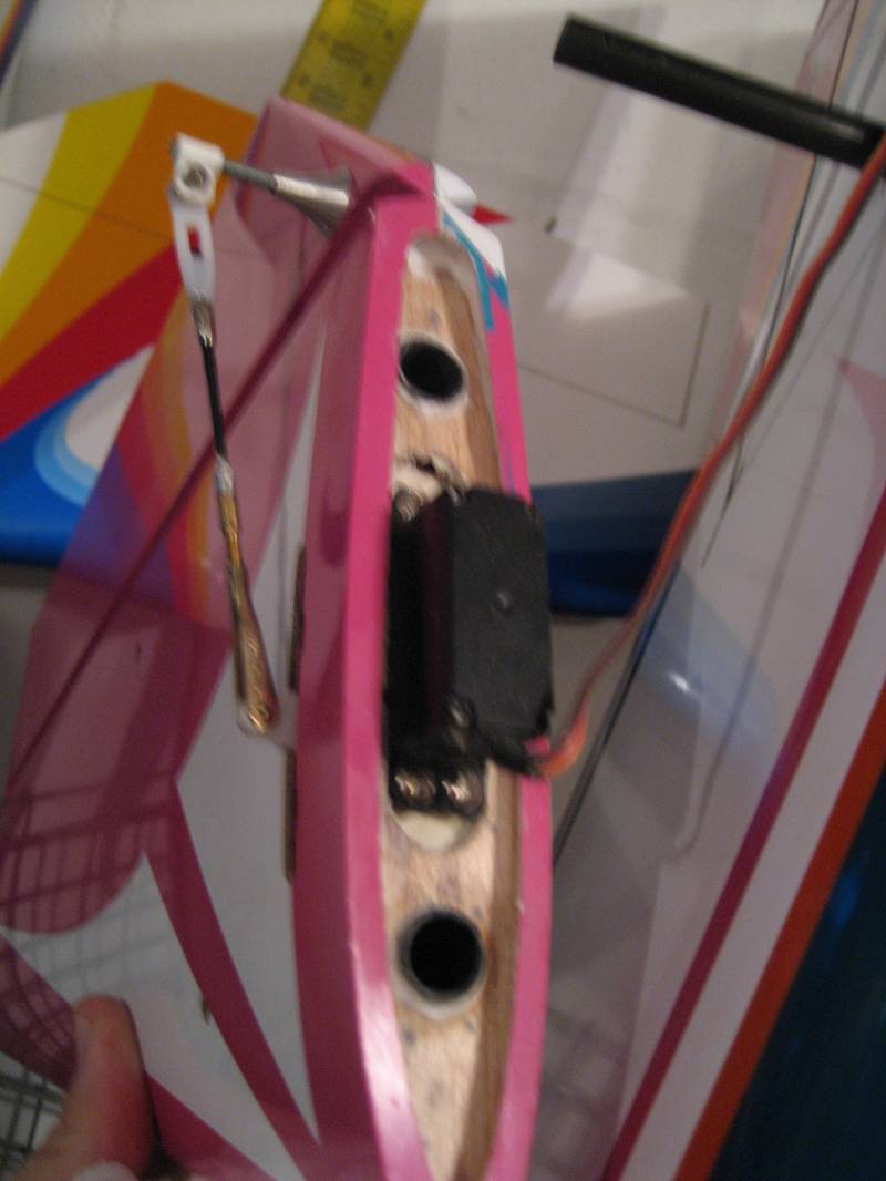

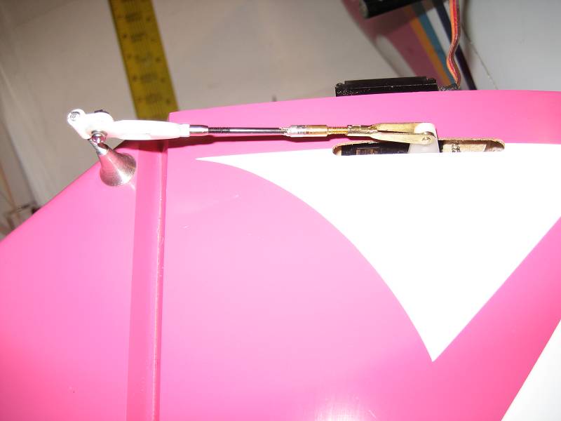

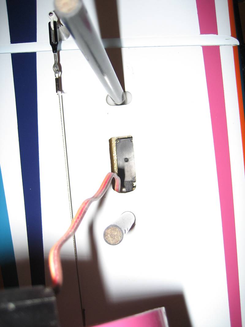

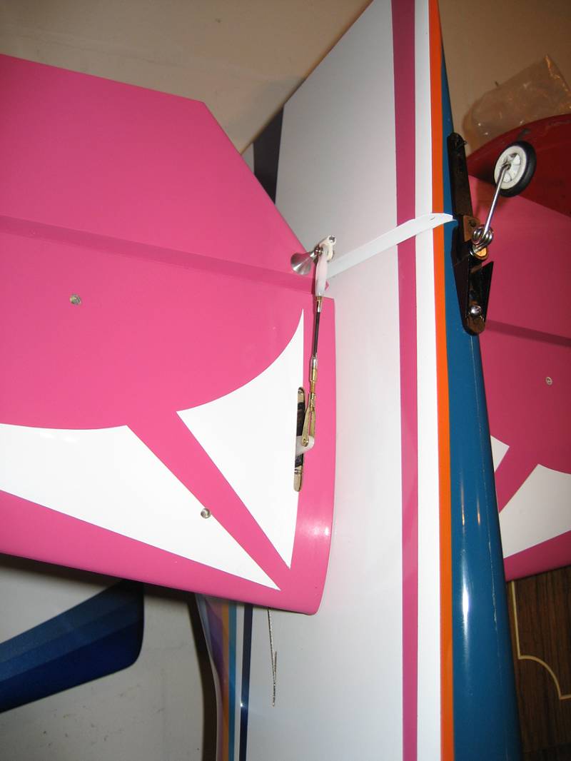

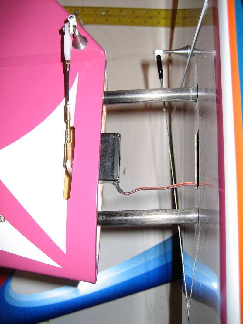

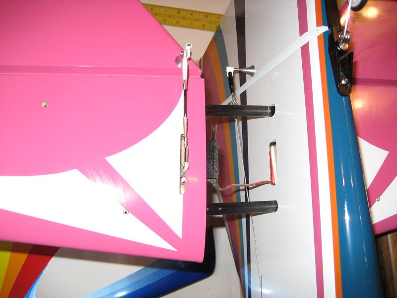

Stab pictures attached...
Joe W

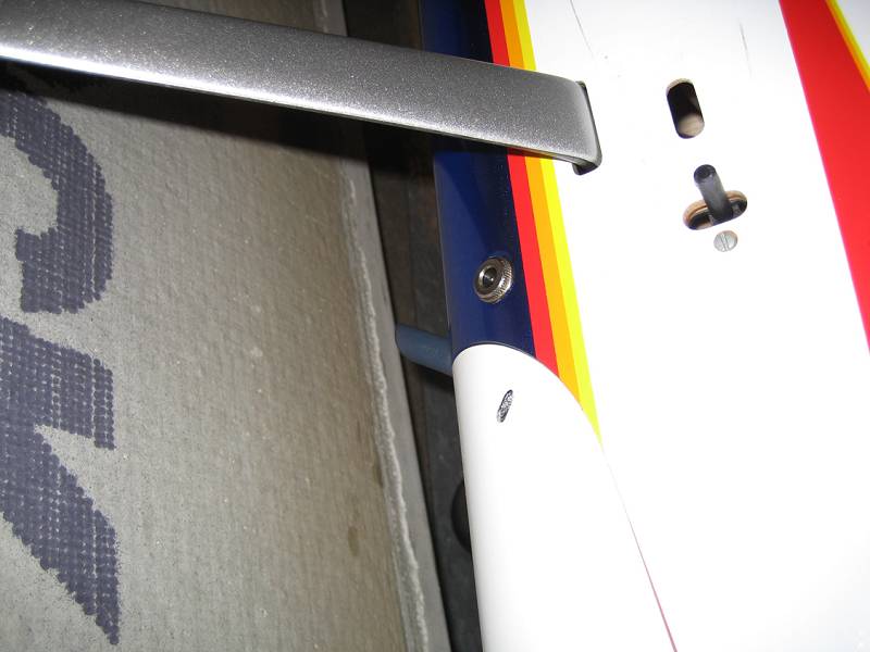

And a couple more...

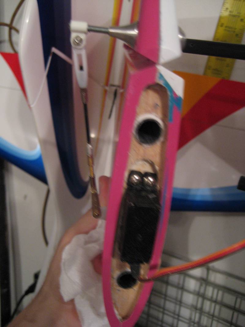

And more!

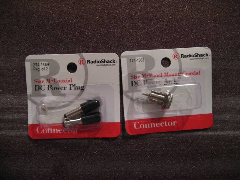

Some of the supplies for the remote glow driver. From Radio Shack no less!
Joe W.

Hi Joe
Just sitting here wondering why you mounted the servo's with them buried into the fuse rather than into the stab? Probably doesn't matter either way. I'm sitting in my hotel room after 5 days of walking around the amusement parks here in Orlando. I get to drive home tomorrow.

Thanks for the pics, Joe. Looks good and simple.
Last night I mounted my rudder servo and did most of the cabling - just need to fasten them at the servo end. I've installed the gear and I'm now working on the wheel pants. I'm also getting ready to install the throttle servo but I need to wait until I get the engine mount/engine installed. I'll have the elevator done by tonight as well. I'll post pics later...

Just curious. I have thought of using the same control horns and ball link set-up you have shown, but was concerned that over time the forces could cause the fitting at the top of the horn to turn. I would expect that this could cause frustrating trim changes in flight.
Has anyone experienced that?
Comp-ARF say NOT to use ball links as it causes a twisting action on their phenolic horns [X(]

Thanks for the pics of some of your remote glow driver accessories, I have placed an order to Altronics ( Australian equivelent ) for some very similar parts. I have purchased a Venom glow driver unit for the +ve attachment to the plug ( $4.00 AU ) so i guess i`ll see how i go with it.

The thoughts are the ball links are certainly valid. The first weekend I flew it, they loosened up a bit and the trim was all over the place! So I zapped them in place. If they keep moving over time, I'll replace them... I had them new in the package and nothing else on hand at the time ;-)

It's a lot easier to install them with the body of the servo in the fuse. You don't have to cut a big hatch in your stab and the 3421's just slide right in the slot already cut for you. It took me about 30 minutes to install both sides. ok, maybe closer to an hour, but it was easy!

I've been using ball links for years on all my planes and I've never had an issue with the plastic fitting that goes on the threaded rod to twist or turn.

The reason Comp-ARF say not to use ball links on their phenloic horns is due to the fact that a ball link has to be fitted to one SIDE on the arm. This means that, when under loads, the phenolic arm is open to a twisting load. Most composite materials are much better at absorbing loads in particular directions and it is the same with these horns. The material used is extraordinarily strong when handling straight on loads that would be induced by a clevis but not as strong absorbing a twisting load hence the warning of not using ball links.

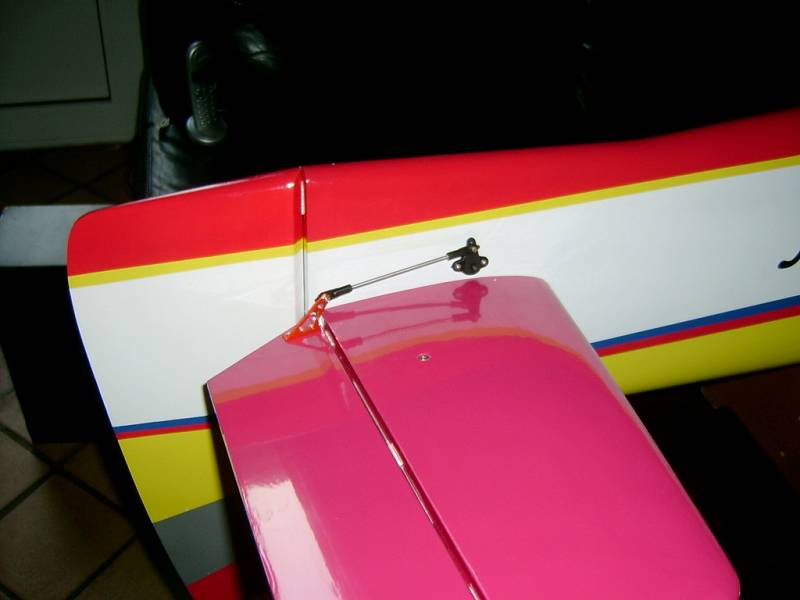

Hi Vellum 2
Just my opinion, but I think linkage of elevator is weak (see first pics).
I already had problem with that kind of linkage. Weld is a weak point.
Screws threads on each tip is more solid (second pics).
