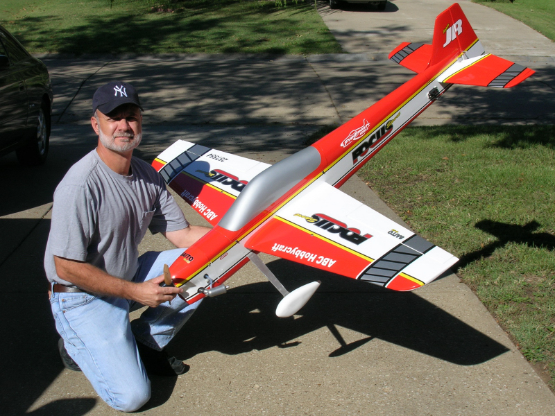

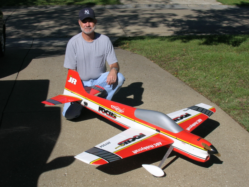

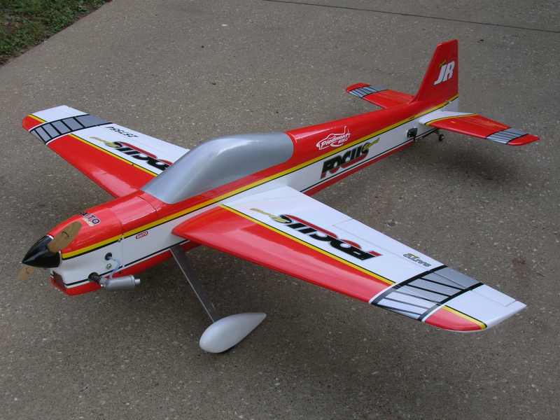

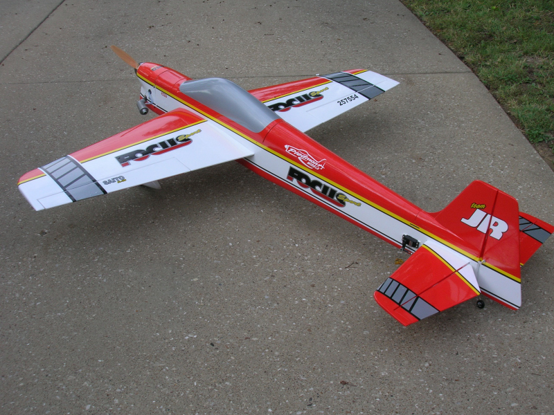

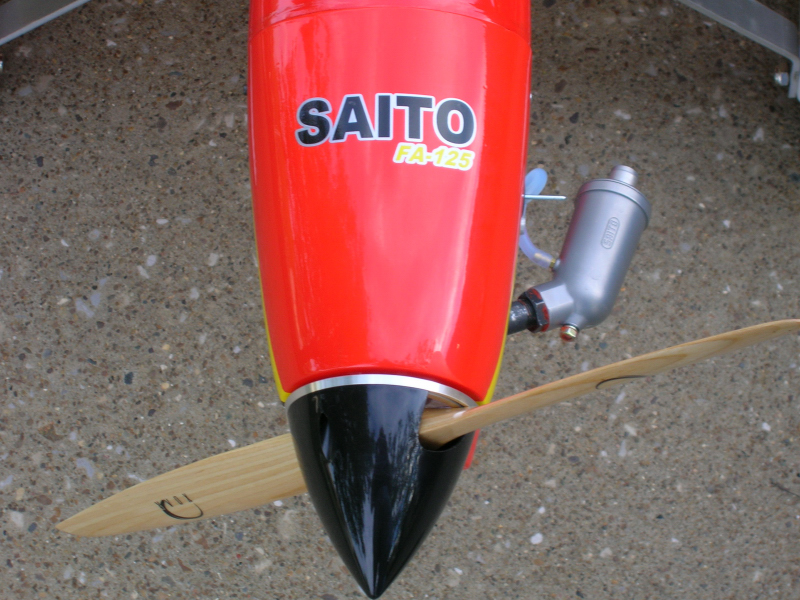

Here are some pics of my Focus Sport at about 95% complete. I still need to add the rudder cables, set the CG, and add the remaining graphics from Bad Brad Graphics. Hopefully I can put the mainden flight on it in a week or so.

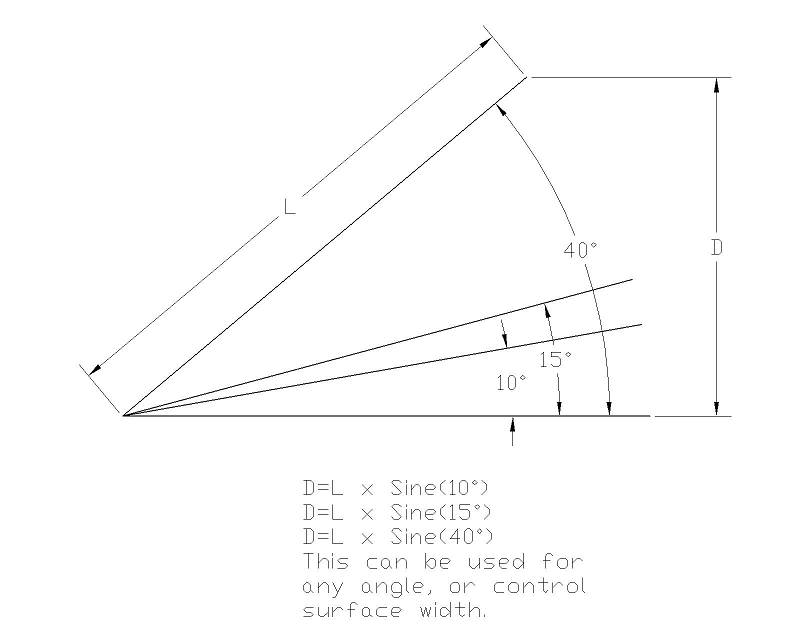

The contol throws on the Focus Sport are in degree. Can someone convert these for me?
Elevator = 10 degree
Ailerons = 15 degree
Rudder = 40 degree
I was using .017" per 1 degree but it seems so little on the throws.

Angle sine
2.5- 0.0436
5.0- 0.0872
7.5- 0.1305
10.0- 0.1736
12.5- 0.2164
15.0- 0.2588
17.5- 0.3007
20.0- 0.3420
22.5- 0.3827
25.0- 0.4226
27.5- 0.4617
30.0- 0.5000
32.5- 0.5373
35.0- 0.5736
37.5- 0.6088
40.0- 0.6428
42.5- 0.6756
45.0- 0.7071

dreadnaut,
Thanks for the info. My Aeroworks YAK 54 had the throws in degree and inches so I also got a starting point from there. My Focus Sport is finished and the AUW on my bathroom scales looks to be about 9 1/2 - 9 3/4 lbs. 8 oz of that weight is lead in the nose to get the CG spot on. I was looking to get the mainden flight in tomorrow but I still need to set the throws and get some fuel through the engine before it sees any air time. The wing span on my plane measured 63" and the fuse is 70". A lot less than advertised so the wing area of 780 sq in. is not going to be correct so the wing loading is headed up. I hope it doesn't fly as heavy as it turned out.
