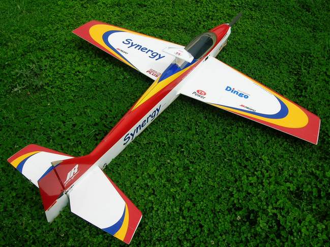

Hello to all
I have completed my ZN Synergy Line. My first engine I had planned was a YS 140 Dingo. Now, some time later, I built in a Pletti 30-10 Evo. The perfect engine for F3A. With the Oxalys has come also the T-Canalizer. About Synergy there is nothing more to say. Simply a perfect model aircraft. About the T-Canalizer has also been much written. I would like all sceptics say try it out. Try it. I say only insanity, super. Even more perfect. I use the orig. T-Canalizer of ZN-Line. More pictures on my website. http://members.aon.at/crazyf3a/Synergy.htm Sorry it is only in German. But pictures are international.
The T-Canalizer is perfect for the Synergy.

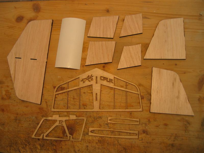

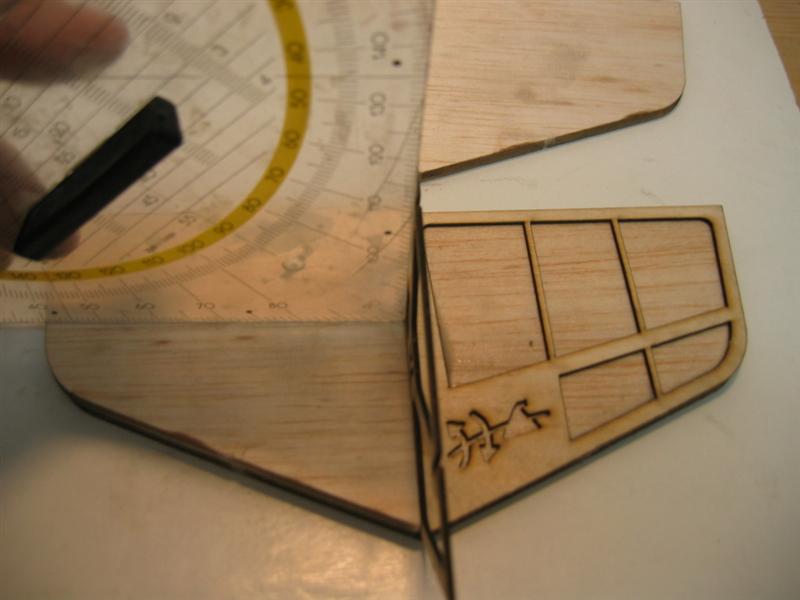

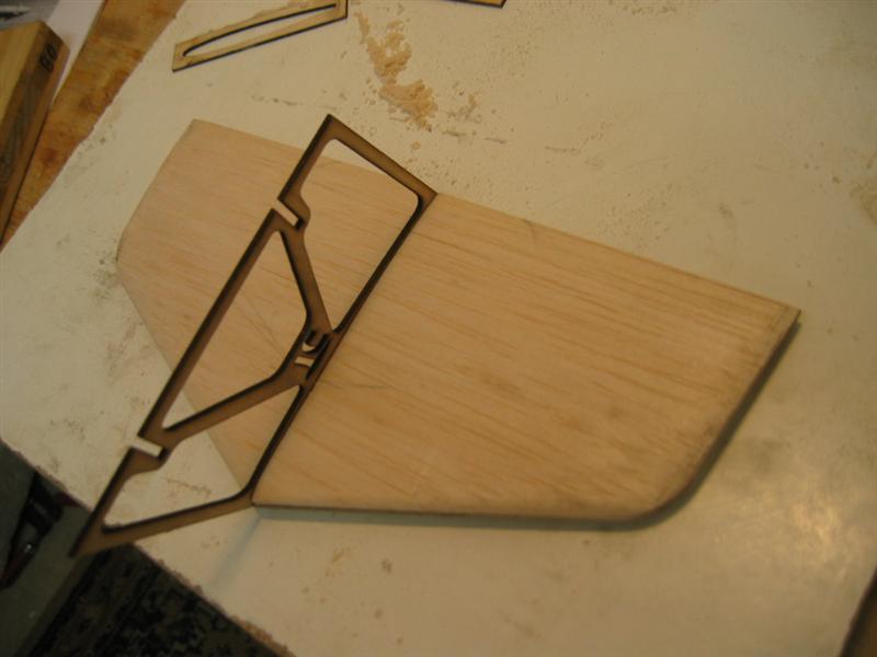

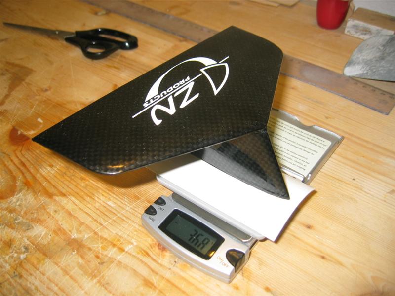

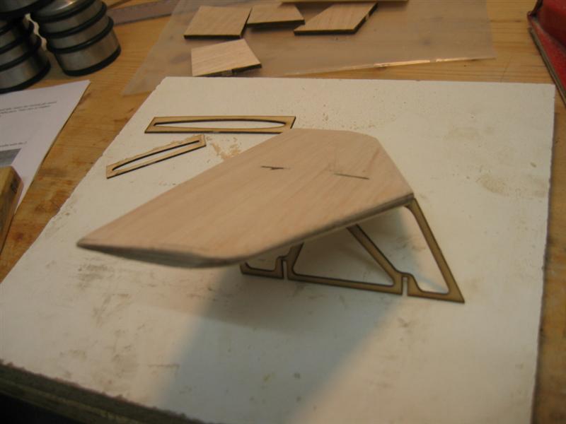

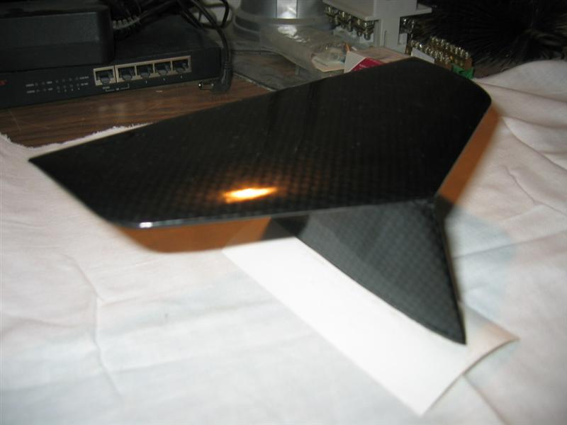

I use the T-Canalizer kit from ZN-Line. (Balsa) Some details can be seen on my Web site. The angle should be 0.5 degrees to the elevator negative.
Messure the Elevator to 0 degrees and the T. Canalizer must be 0.5 degrees down. So the theory. You can read this on every thread. I think this is OK.
That measure is not easy. I have reviewed it and it did fit. I have flown my Synergy until this without the T-C. I open my mouth and I was told to me Wau is this great.
How I build my T-Canalizer.
In Canalizer are two long slits. In this I have glued two M3 Alu-Nuts. On top of the Fuselage ( Overside). I have glued a balsa wood with two holes for the M3 Nuts. And two half pants. CFK/Herex pasted into. The whole thing is screwed and disassembly. The canalizer is then bolted. Sorry I don't have more photos about building.
I am totally impressed by the T-Canalizer. And you certainly.

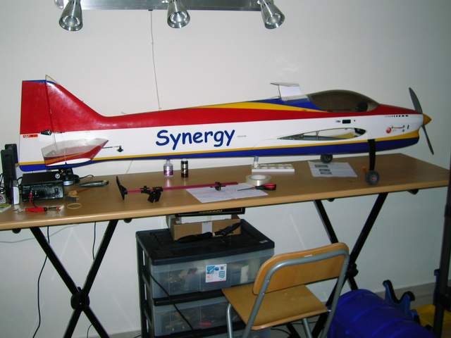

Thanks for the answer. Have you coated the T-Can with Solarfilm covering in carbon scheme?
After building, sanding anc covering the T-Can, I plan to glue it with epoxy and cotton to the upper surface of the curved fiberglass base. I plan to sand the base before that. I don't think I will use M3 screws. Then the base will be installed behind the deck with clear tape. Do you think that will be ok?
Also here are some pics of my Synergy, powered by a YS 160 DZ. It flies well but don't have many flights . The rudder is a bit enlarged, also have the original one and will give it a try after installing the T-Can.

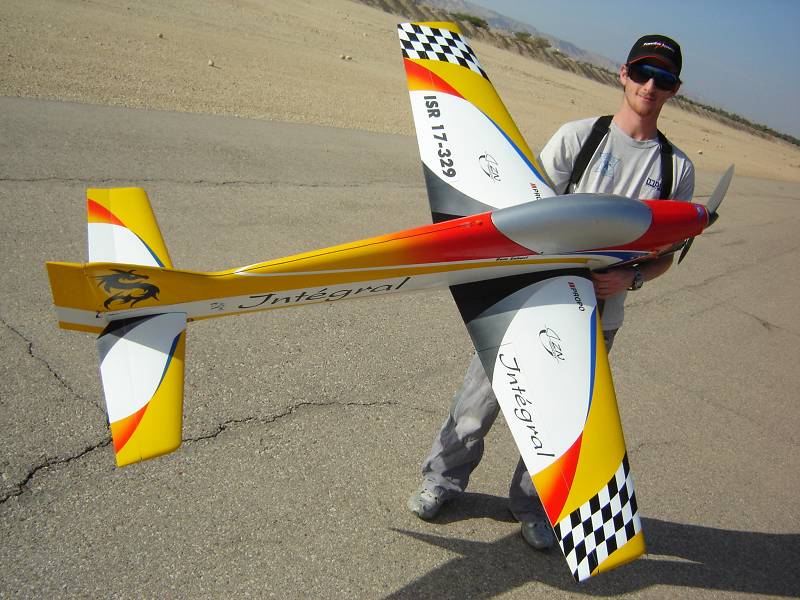

Hi Nickolas.
Both of my models fly's with 160DZ and APC 18.1X10
The Synergy is a very good model but in comparison to the integral it is much faster on vertical and also on down lines.
The rolling performance of the Integral are great both in high and low speed (Low speed requires low amount of rudder (.
Snaps are great!
About the integrated maneuvers, the Integral is also better!
Bottom line
The Integral is slower model and better performance then the Synergy.
Few month ago MR. Chip Hyde him self tested my model and he said "it fly's well!" his word is better then my word for sure
If you have any more question pleas ask!

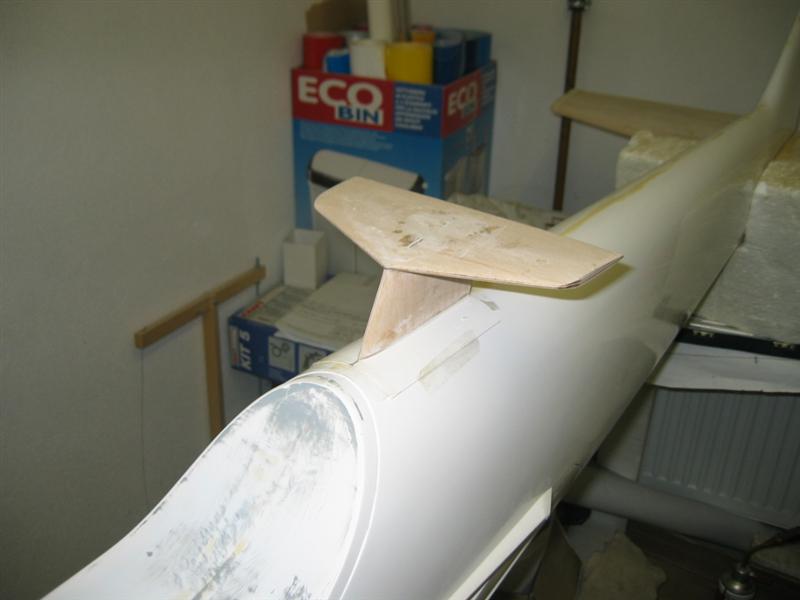

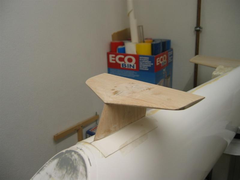

Old 04-07-2008 | 03:08 AM
Nickolas's Avatar
Joined: Jun 2004
Posts: 917
From: Athens, GREECE
Default RE: ZN Synergy with T-Canalizer
Hi,

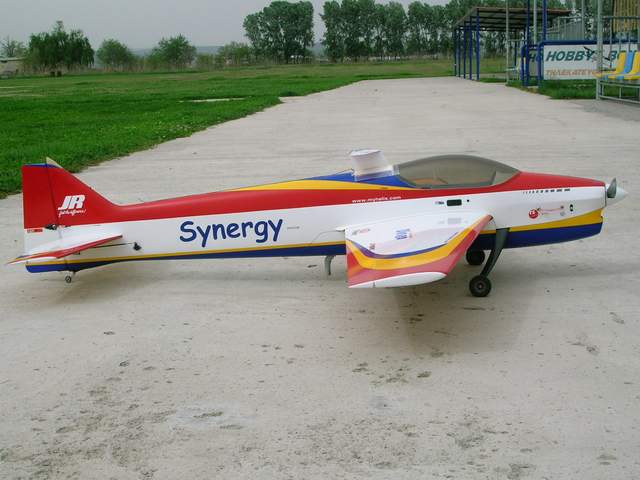

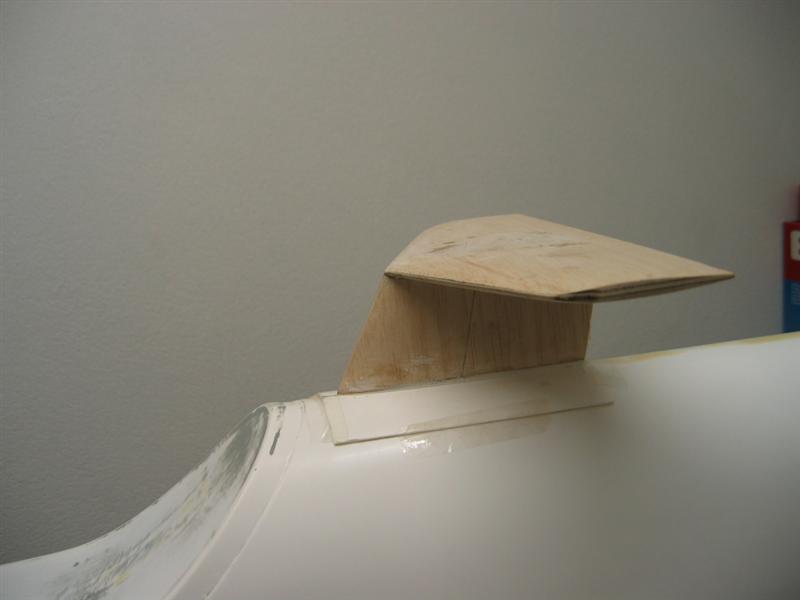

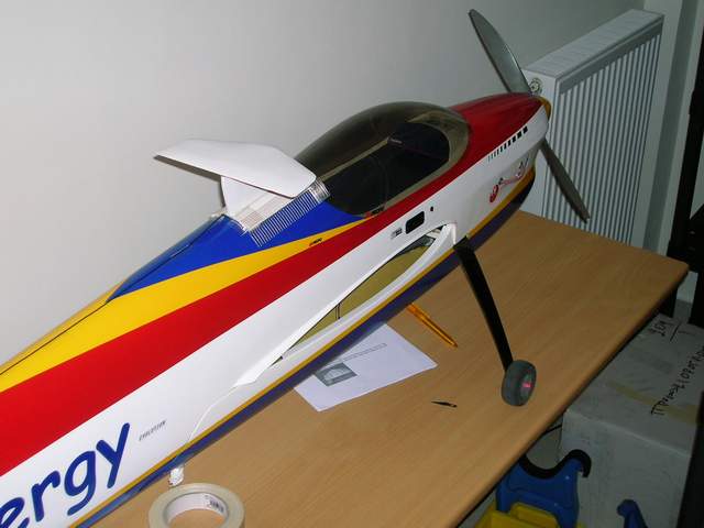

Here are some pics of the T-Can installed on my Synergy.
Regards,
Nikos

Old 04-15-2008 | 05:00 AM
Nickolas's Avatar
Joined: Jun 2004
Posts: 917
Synergy was recently tested with the new T-Can setup. Pitch coupling in left KE was not elminated still have about 15% mix but now rolls better and slower. My CG currently is at 260mm from TE.
The T-Can base was fitted on the fuselage deck with 3M fibre tape. It was flown with pretty strong winds 4-5 bft and proved to be really solid.
Regards,
