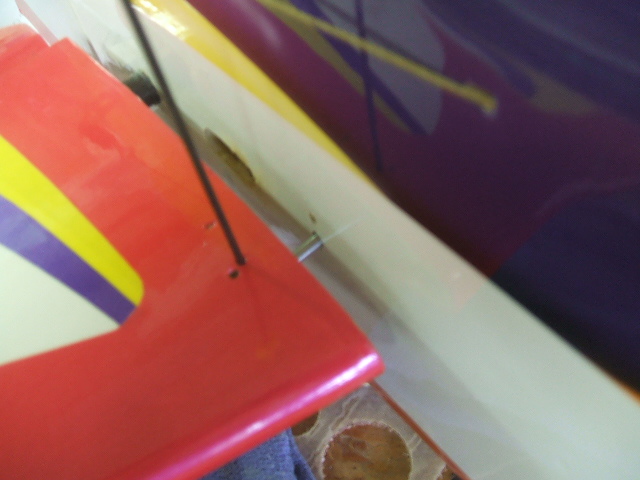

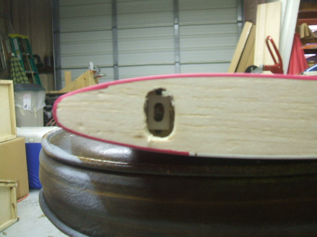

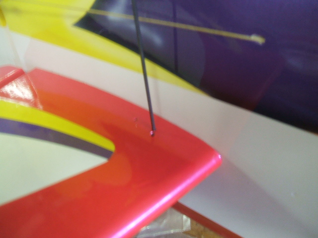

Here are some pic's on how we hold the stab on. Like Chip said the stab adjuster has a screw on top and bottom. Once the stab is set we tighten down the screws onto the front rod that goes through the fuse and your done.

Based on Chip's explanation, I had pretty good ideas how it might work, but the pictures sure makes it even easier to comprehend the attachment method and it looks like a very clever idea for sure.
Thank you,
