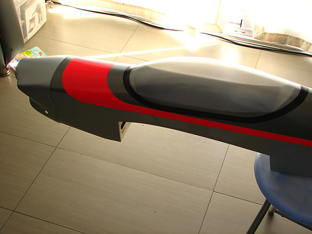

Yes Martinoto, dbacque apparently had the same problem that I had... I realize about the softness of the balsa wood not as early as I would like [:@]
Anyway, I managed to mask those sections...
These pics shows the cockpit paint effect... not as good as tint, but it gives a good look when exposed to sunlight:

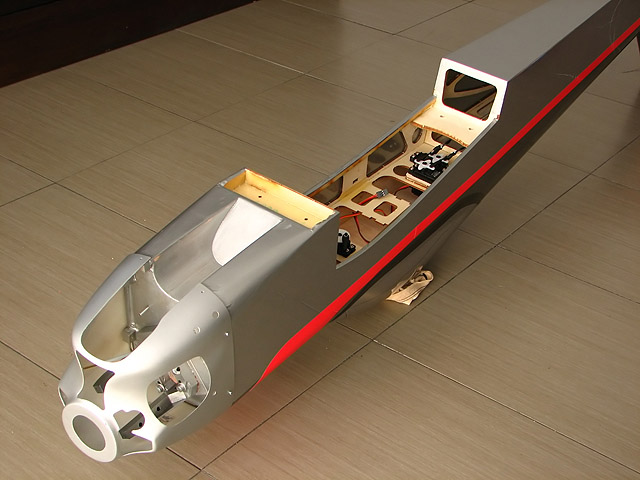

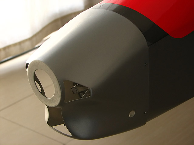

Here are some other pics, showing the mounted cowl already painted. You can also see part of the belly and the painted muffler tunnel. I'm thinking about giving it a finishing clear coat to ensure its impermeability.
I started to work on the landing gear today. I think it will be not so nice as I want. We'll see.
Here are the pics:
