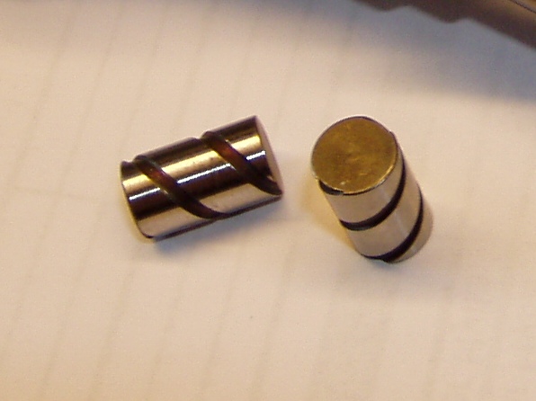

Just to inform you all about the design of the "Low Smoke" Crankshaft and Cam Followers for the 170cdi I have attached some pictures here.
As you can see the Crankshaft differs from the "new-old" design of the ordinary DZ170.
/Bernt
/Bernt

In your first picture, is the hole in the end of the crank pin plugged, or is that an optical illusion?
In my newest 1.70, I appear to have the new crankshaft with the small hole in the end of the crankpin, but the old, non-grooved followers. They must have been making running changes in the production line.

Yes, the hole in the Crank Pin is plugged.
The Con Rod is being lubricated thru the Crankcase (you can see the hole on the second picture).
