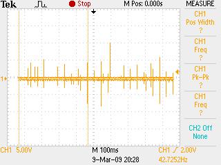

Gents,
my concern about connecting the CDI directly to the receiver (or for that matter, the receivers battery, makes no difference), was not only from a point of "RF interference" view, it's logical that the problem of RF interference would be (potentially) worse on 72 and 35 MHz than on 2.4 GHz, what I'm more concerned about is the "beefy" positive AND negative spikes on the supply wires (which the receiver also sees).
IF your setup passes the ground range checks (which they might do without problems), there could be a chance that the receiver eventually will be "killed" by the severe spikes on the power supply wires.
I bet that if you ask the producer of the receiver you use if it is ok that there are +/- 20V (and more) spikes on the supply wire, they will yell at you: "NO WAY!"
It very well might be that the setup works ok for xx number of flights (and range testes ok), but that the receiver eventually "gives up" on the spikes, and dies (together with your nice plane....)
So, please be carefull !
The picture below is a snapshot of the supplywires at the receiver, this was shot when engine was not at full RPM, the spikes grew to approx +/- 20V when running full throttle (didn't save the picture then...), I didn't grab a picture of where you can see the width of the spikes (it got dark

Carsten,
Did you perform your test with the engine on a test stand or in an airplane?
It would be very educational to look at the voltage of the rx with servos idle, servos all moving as in during a snap and the voltage taken when the servos have vibration applied to them as they are during normal flight. (with and without ignition)
This information would very helpful, that being said, hundreds of flights have been flown with the CDI pluged directly into a Futaba Fasst RX 6014, never a hold or glitch, three different airframes and three different igntion modules.
No doubt that the safest would be a separate battery and switch.
Bill
Bill
#293
Bill, good point!
The test was done on a test stand as Torben wanted to be sure before mounting anything in his planes.
You are correct that there also can be an effect from the servos, I will try and repeat the measurement in a seperate plane without the CDI (I'll test it in one of my jets), and see if the servos can mimic the measurements already done

The spikes look like noise induced by the test set-up. If you are not probing directly you'll need to keep the wires to the scope probe down to a minimum...no more than an inch or two.
Colin.
Colin.
#296
My Feedback: (17)
Joined: Sep 2003
Posts: 366
From: New Milford,
CT
Yes remove the ground lead from the scope probe and use a very short piece of wire attached to the ground ring on the probe and tied directly to the ground plane. Ideally, it shoud be soldered to it.
John Pavlick
