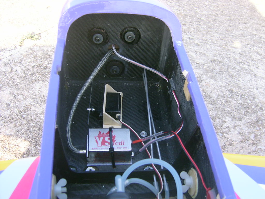

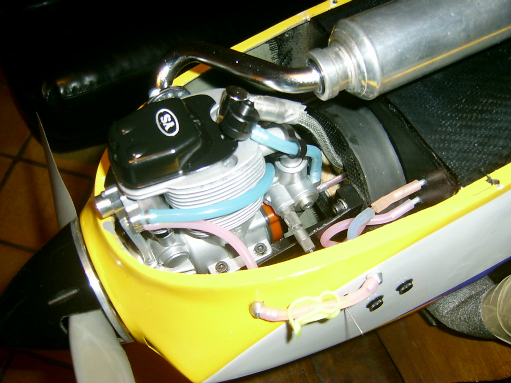

Hi
Pics of installation of YS CDI in my plane Harmonie
Thanks to Ryan to have put pics of installation of his Partner equiped with CDI. Theses pics helped me to install mine.

#407
Hello Papaone,
Very nice plane!!!
Please, let me suggest the following, secure the ignition spark plug cable to the cylinder intake tube with a ty-rap, and prevent the ignition cable to touch the carbon fiber ring on the inner hole of your mount.
The first will damage the spark plug connector, the second if the braid is chaffed or broken it might emit RF noise.
Happy flights.
Alejandro

#409
Hi Alejandro and Arch
Thanks for yours advices. I did modifications. In the box of CDI, there were plastic cordons for wrapping wires, so I used them for that and I put a tie-rap to fix socket plug.
I did 3 flights next week end with APC 18,1x11, fuel with 10 % oil and 20 % nitro for break in.
For the others flights I'll use fuel with 6 % oil and 20 % nitro. Very easy to start, I just set up by turning speed needle valve.
http://www.yspower.co.jp/en/data/pdf/DZ170cdi.pdf
Regards
