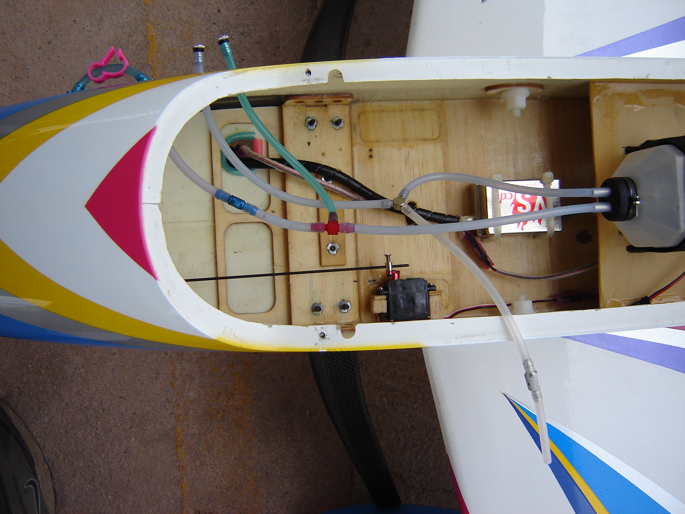

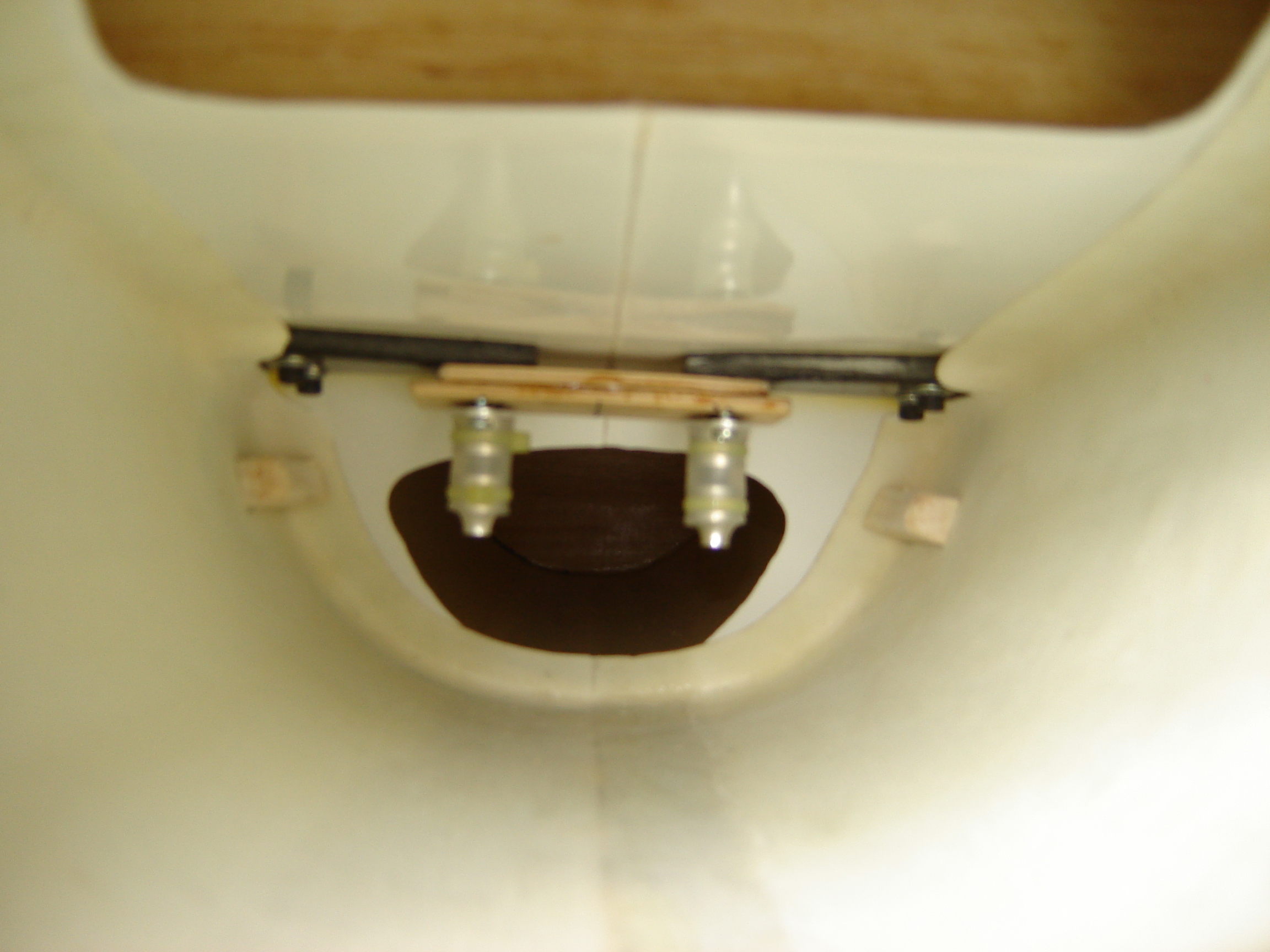

Like Adrian said, your engine is way too rich, set the needle valve at 1-1/4 turns, run the engine, accelerate and bring it back to idle, when at idle, listen at the engine, if the RPM goes up then richen the pump if they go down lean the pump, adjust the pump from whenever it is right now at 1mm interval.
Also, are you using 19x11?? if so, you should not use that prop until the engine is broken in, at least 30 flights minimum, better at 40 flights, 17x13 will be the one to use, the engine can't handle that big prop very well when it's new.
Also, the spark plug cap should be close to the intake tube, correct that and put a ty-rap to hold it together, it will brake if you don't do that.
The video is a good idea, but your camera shutter is too fast, I can't evaluated the smoke.
Good luck and let us know how it goes.

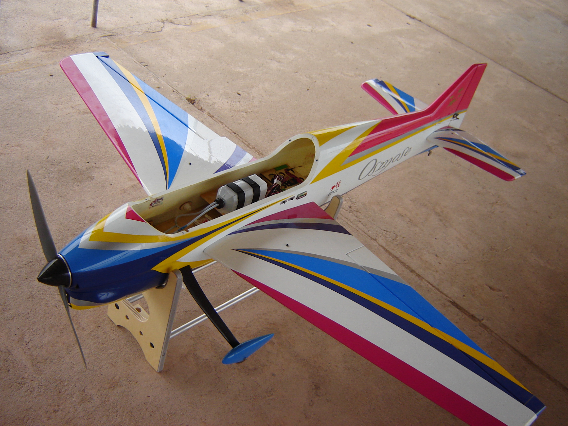

Good morning,
bwick:
Thanks for the secury advices and I use a LRI 85 Hyde mount;
apereira:
I´m using a 19x11 apc, I will change the propto the mentioned;
Do you have a picture with the spark plug with the ty-rap?
Plase send the picture of the improve air exit from the osmose evo.
atul
I have bad news (to me of course)...
I touch in the regulator, needle and sub needle valve (desesperate mode active lol) and I don´t know the original turns os this screws.
So, is better I send my engine to factory in Japan?
thanks and follow pictures of my plane (I´m novice that you see, this is my first real plane and my first real building)
Douglas
bwick:
apereira:
atul
Douglas

Before sending it back to Japan, and also getting confused by all of our recommendations, I suggest you look for someone at your club that has experience on YS. Not necessarily needs to be cdi proficient, but with general knowledge on how the DZ system works. Have him take a crack on your engine, and explain the ins & outs of the engine to you. If he knows how the basic DZ system works, the cdi is just an additional element that is not that though to figure out.
You will not be benefiting from anything by sending the engine back to Japan, unless the engine indeed needs repair.

I'll post the pictures in a little while.
