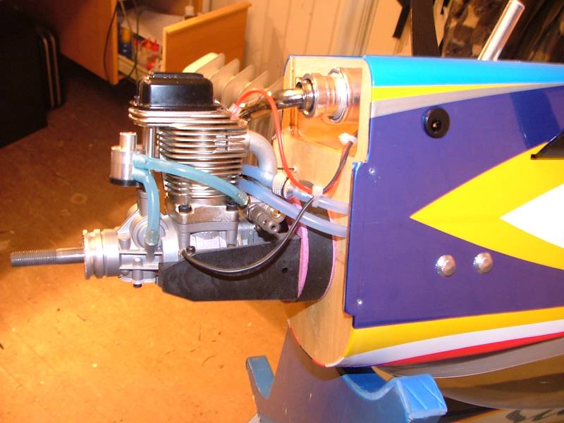

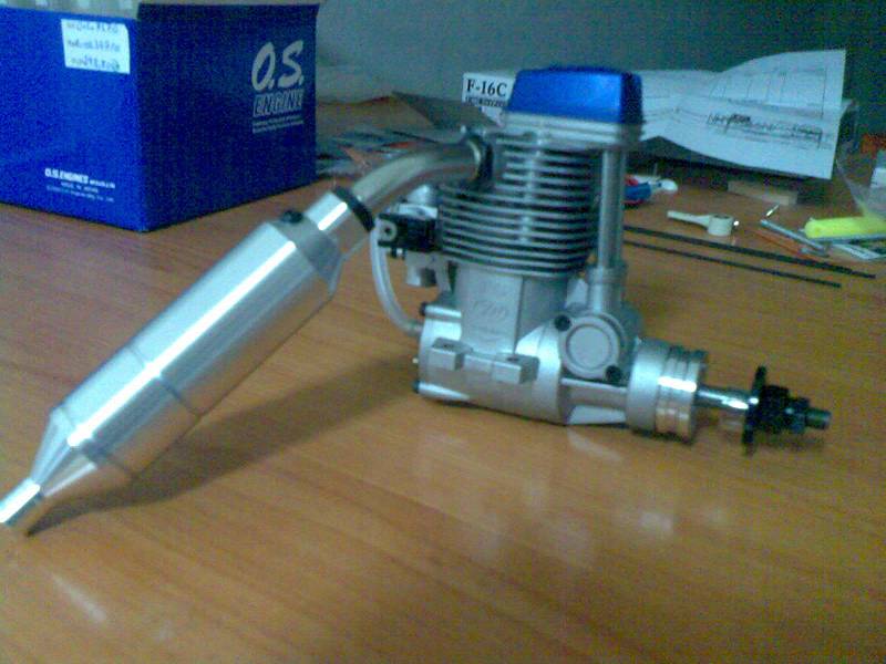

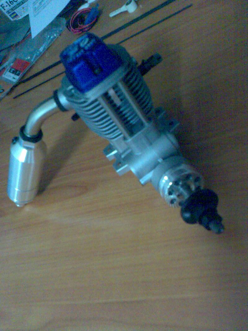

ORIGINAL: gpang788
Hi Nigel, have some questions for you..
1) Did you have any problems with the OS55AX running inverted?
2) Did u use a pump or regulator to ensure smooth running?
3) What glow plugs did u use??
4) Standard OS Muffler being used?
I have always wanted a pattern plane to go with my 55AX too but held back cos I was afraid of potential inverted running problems.
Care to share how you avoided these problems?
Gpang788:
I had the 55AX on my previous pattern trainer, a TM Shadow. It was an inverted assembly with rubber engine mount, nose ring, Karl Müeller manifold and Asano pipe. Exellent running engine. Absolutely no problems running the engine inverted. I've heard the stock muffler is very noisy, but have not tried it myselff.
I used the standard Os#8 glow plug, 15/15 Aerosave fuel and a 12x6 APC prop. The planes' weight was ~2,4kg, and had unlimited vertical.
The attached photo shows the engine configuration.
As for the Osmose built, I have not had as much as a minute in the building room for a couple of weeks... (hence the heading "SLOW.."). I'm hoping to spend a couple of hours building in the end of the week or over the weekend.

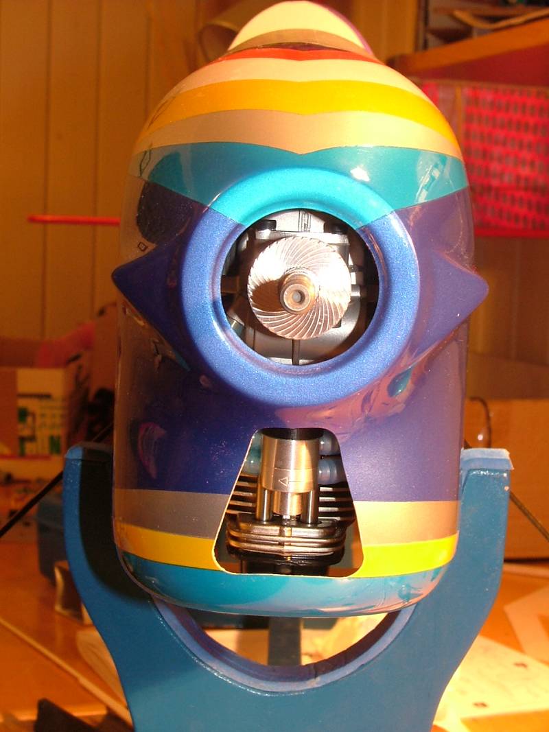

Thinn
What ideas or considerations have you giving the cowling to cool off the YS .63 and exhaust system? Are you going to stay with the tiny forward slotting and really open up the bottom of the cowl, or are you going to open up the front of the cowl a little more?

Brickhead,
I might just open the cowl just in front of the cylinder. As long as this hole is big enough to "cover" most of the cylinder I'm guessing it'll be OK. The opening in the back of the cowling (the pipe "tunnel" ) should be more than twice the size of the opening in front, so I don't think it will be an issue.
A rule of thumb to get the air flowing nicely through the cowling is that the outlet must be minimum twice the size of the intake. Also, the airflow must be directed through the cooling fins of the engine. If the inlet opening is too large, stators (or restrictors..) should be used to direct the airflow tightly around the engine.

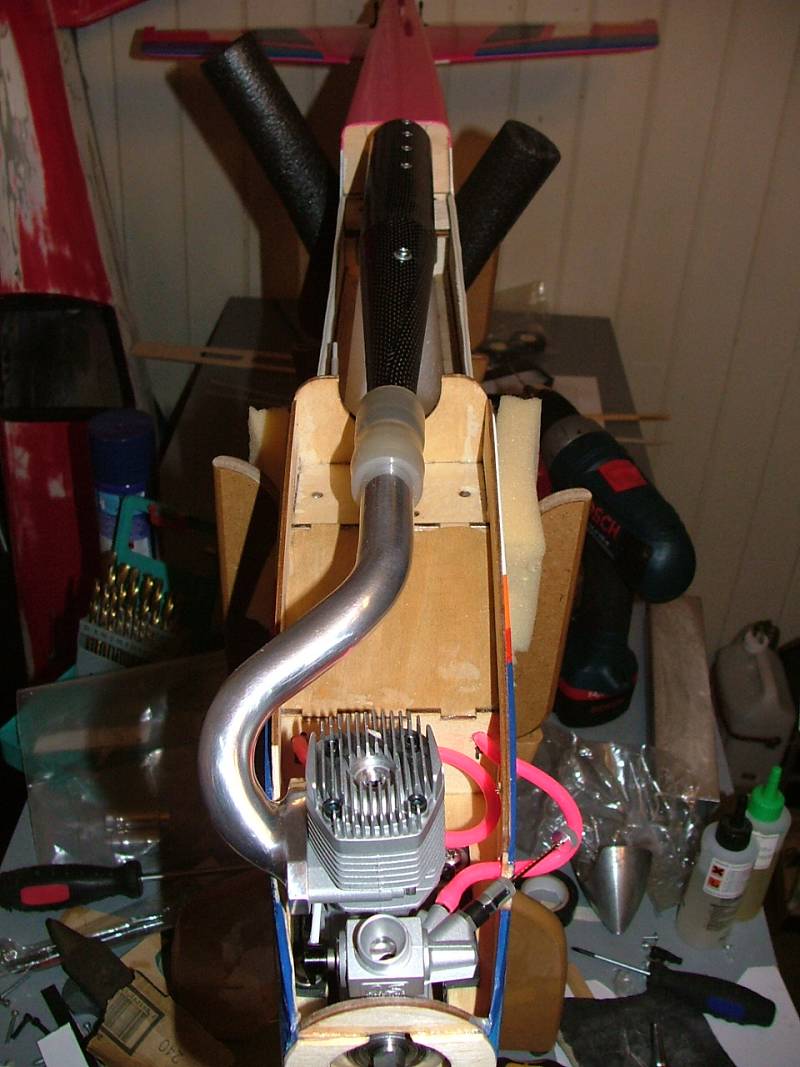

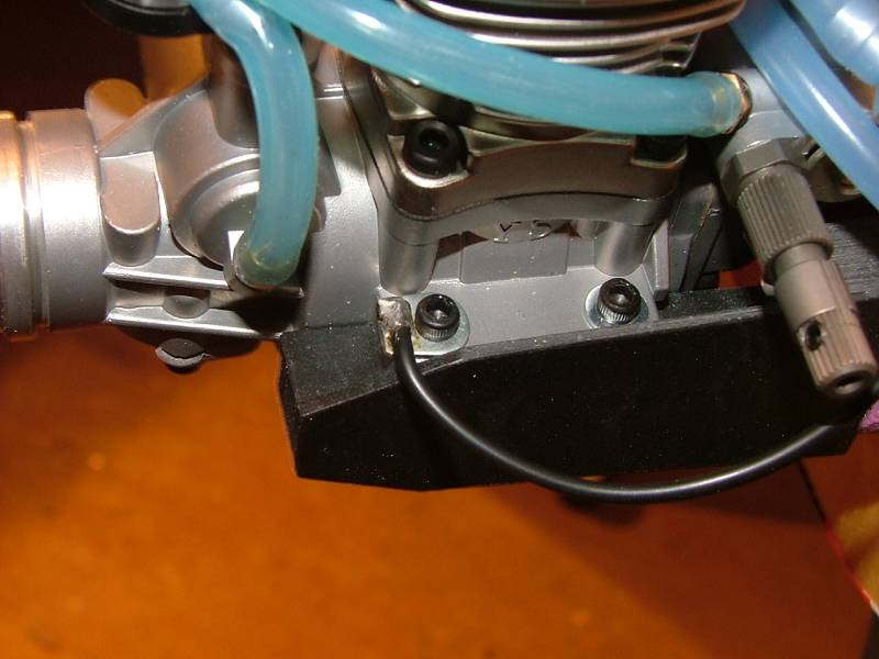

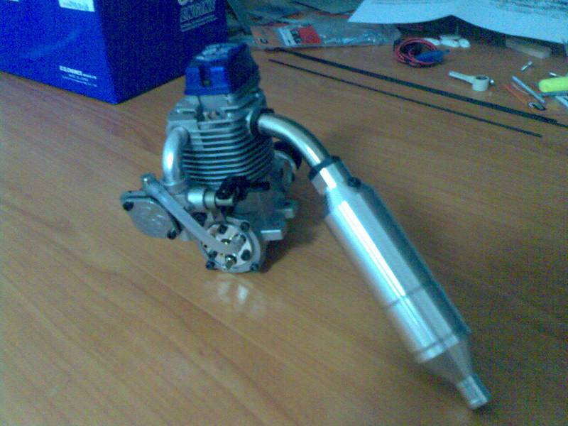

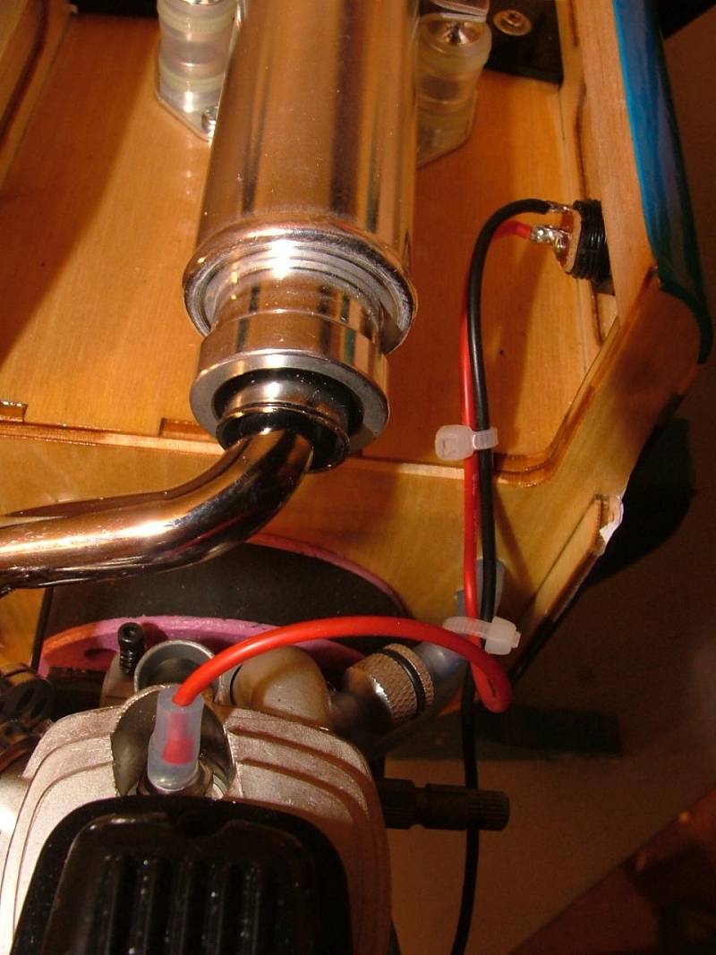

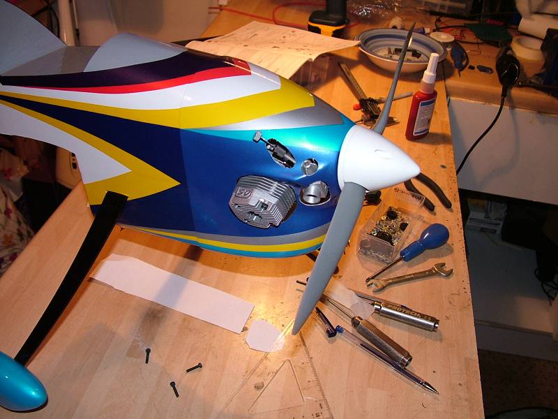

I'm back... -Time for an update.
I've spent a couple of nights building now, and I'm close to completion. All that's stopping me now is the lack of 2 ball-links for my ailerons! But I'm guessing I'll get hold of these in due time.
So far, the following has been done:
- Carbon pushrod for the elevators (never liked the heavy hardwood stuff..)
- MK control horns fitted on elevators and ailerons
- Re-arrangement of servo positions (thanks to earlier posts..)
- Wheel pants assembly
- Cowling adjustments, cutouts and assembly
No major concerns or mind blowing problems. Pretty straight forward actually! Way to go Kyosho...
I'll throw in some photos that tell the tale far better than I can describe.
Things to do..:
- Finish aileron controls
- Fit an external plug for the glow plug
- Re-think and fix a less hazzle way to mount the wing bolts (it's a real pain!!)
- Check if throttle servo mount is adequate
- Add battery and reciever
- Run in engine
- Maiden...

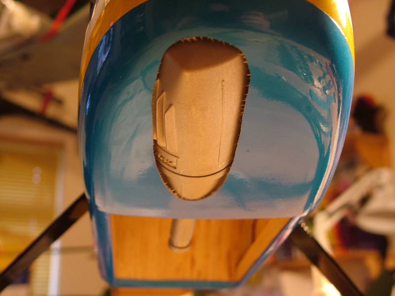

Some more photos (cowling prep).
Cannot upload more than 3 at the time due to "fast" internet connection....

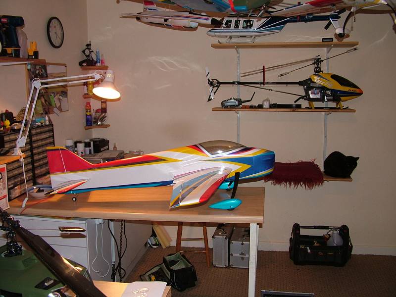

Finally, a test mock-up to get a perspective on what I'm working on!

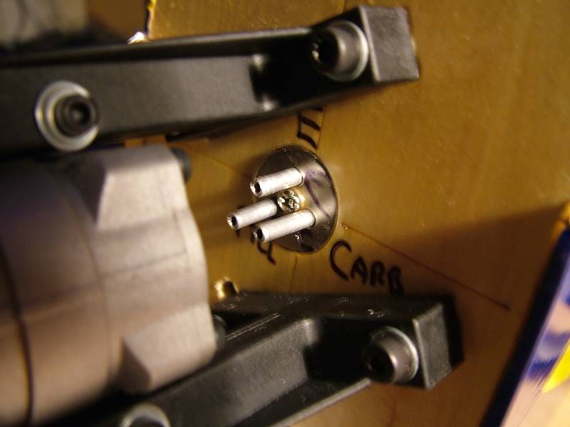

Finally, I completely finished the model.... (Maybe mayden this weekend??)
I made a new battery pack (4cell Sanyo NiCd1100mAh), put in the reciever and set up all servos etc. I just copied the program from my Oxalys, so setup should be a bit quicker than normal (hopefully...).
Here are som engine pictures. Note the simple, light plug connection... Fuel tubing is an undervalued tool!
And the elongation of the needle....well.. amazing what you can use those T-end building pins for!
