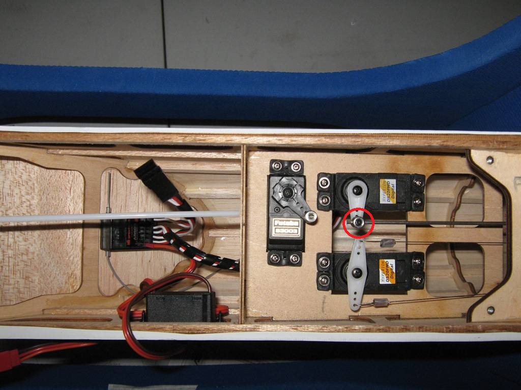

Hey lojik..Congrats on your new plane and hope you enjoy it!!
I've hesitated to say this but I noticed something in one of your photos that concerns me a little...I personally would not use that barrell/screw connector which I see on your elevator servo arm (circled in red in the photo below)
Maybe you (and others) have used them in the past with good results?? Maybe it will be just fine and is common practice on smaller planes?? Maybe it will work well on the Osmose?? But it just looks a little too sketchy too me...I feel the use of that connector on a *control surface* for this category airplane may be a bad idea because the loads are too high...Using it on the throttle should be just fine as the loads are not very high and do not ever really change....But a control surface is a totally different situation in my opinion...
Now maybe you've ground a notch in the wire for the screw "to lock into" and there is no possibility of slipping?? That would be a different story and I could live with that plus a little lock-tite on the screw...But otherwise I would not trust the screw holding the wire and have noticed them slip in the past...You can't really tighten those things very well when using a 2/56 wire or larger either...
I'm not trying to offend you!! I just happened to notice that and it scares me a little so I thought I'd mention it....
Maybe that is what the manual tells you to do?? Maybe your 110% comfortable with it and have used that method in the past with success?? Then it's all Good...
Enjoy your plane!!

Thank you for the warning Atlanta, I am more than happy to take advice from anyone on here, personally I have used the connector with no problems on my scale models in the past and yes I do notch the rod with my dremel and lock tight the screw in place. I will keep a close eye on it and see how it fairs. I may melt a copper cover onto the end to ensure it does not slip or if it does it wont go far.

I've been using the same type of connectors for more than 20 years in various sizes of planes.
It is a whole lot better than Z-bend on easiness.
Never had one coming loose. I do check them occasionally.
I do use them on pattern planes if I don't use ballbearing clevis/adjuster.
Kyosho and several other manufacturers' ARFs come with those most of the times. It is much better than those Dubro/GP ones that use steel/plastic washer on the back.
World model has two different sizes (height and wire diameter).
Just make sure to put a little locktite on the nut. If there is a flat washer, make sure to use it.
Drilling the servo horn for correct size make it work really good.

Dear Atlanta; Good advise on the "barrel connector". Im just about finished with my Osmose and thought I would check the forum to see how other planes like mine were looking. I personally would never use that connector on any control service. Sure there are those who will claim that they have used this connector succesfully for hundreds of flight with no problems, but it is very "sketchy". There are too many other viable alternatives, the barrel connector being the worst. I'd much rather see the end of the rod bent at a 90 degree angle with a plastic "keeper" at the bare minimum.
