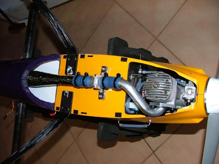

Old 09-22-2008 | 06:43 AM
Jeff Boyd 2's Avatar
Joined: Mar 2005
Posts: 732
From: Adelaide, AUSTRALIA
Default RE: Which Tuned Pipe? OS 160
ORIGINAL: frequent flyer
Hey, do any of you guys know the dimensions of the Aeroslave pipe? I was looking at the chart on the website for tunning it . But it didn't give the pipes dimensions.
I use athe Aeroslave on both the OS160FX, and OS140RX. The setup they recommend on the website is spot on! Set it there and just fly.
It's a great pipe . . quiet with a mellow tone and makes awesome power . . especially with the 160. I highly recommend it.
Attached is the 140 setup in my Impact, and the 160 setup in my Integral.
The pipe fits easily in any plane designed to run a pipe . . but if there is a particular dimension you are concerned about, I'll check it for you . .
Cheers, JB
