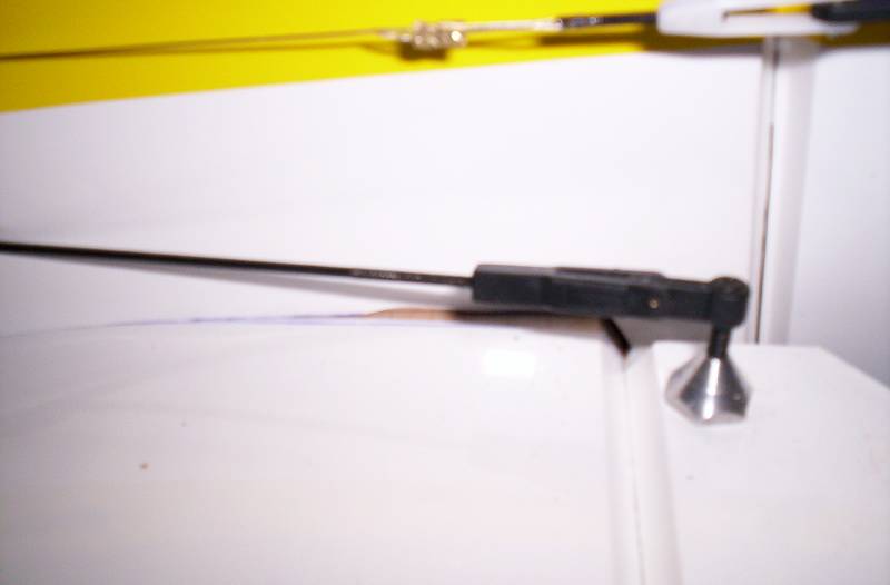

well I had to readjust my elevator pushrod by about a 1/2 inch
every things works good so far it is on center line
I also had to change the elevator servo around
The rudder servo sits behind it perfectly now all I got to do is hook up the pull pull system I need to get a bigger 6/32 bolt 3 inches long
I will do that later tonite

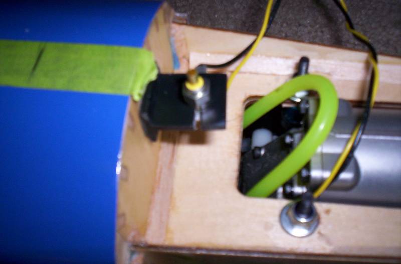

Working on the pull pull system on the rudder almost finshed just have to make minor adjustments

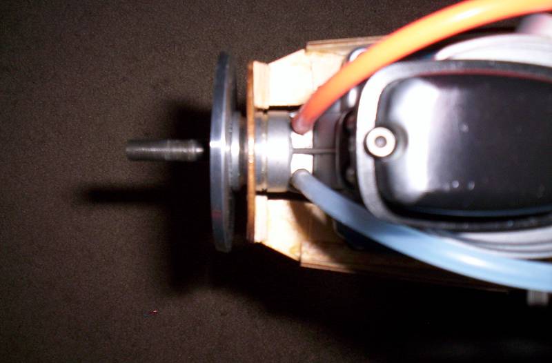

worked on the engine line up also it is taken care of
Just have to figure out were to put the switch and charge jack assembly at [&o]

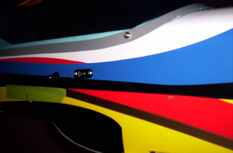

I just finished mounting the horizontal stab
I also glued the hinges on the moveable and fixed parts
got all the controls centered up and tight
I didn't like there tail wheel bracket, I will probally replace it later
only small things left to do like mount the canopy
velcro in fuel tank
put a remote glow ignitor
still trying to find a good place for the switch assembly
last but not least the header and pipe system

I have been working on the tunnel cut out for engine cooling
I have the place for the reciever to be mounted just have to secure it now
reworked some of the servos wires
mounted the switch and charge jack assembly

Yes, the plane came with the motor mount brackets installed. and a nose ring that helps support the cowling also you can really see the thrust angles when you put a spinner back plate on when you do the first fit up of your motor [8D]
It is scarey to think and to trust the manufacture, when they put the amount of down thrust and side thrust in already
these things are built in a jig assembly so they are set up pretty damn close for the first flight or two
they also have pieces of triangle stock on the sides for reinforcement. [&o]
You have to cut out some of this triangle mount pieces to line up the motor in the center of the nose ring
they used their own style of vibration damping mount
Now if you try to change this motor mount system to a another mount system it is going to take some work on your part
you will have to cut off their mount system the brackets are tied back threw the fuse leave the inside parts alone [sm=47_47.gif]

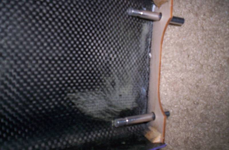

This is the way they would have you set it up
I was using tape to look at the setup
After looking at the rear tunnel area again, there is somewhat of a problem
the pins are only glued in the former
I am thinking another brace to be glued in for better support
#43
I was working on the rear of the tunnel pin area
I put an extra former in the area to make a straighter pin aligment
I used a piece of triangle stock for an extra support and glue base
now I just have to fuel proof the wooden pieces

#45
I was working on the canopy today it is blue shade with silver outline trim
I trimed the the plastic to the mold line
than I sanded it to make it look good
after about 5 trial fit I got it in the spot that I wanted, so I drilled the holes
The drawing only shows 4 screws but they give you 6 of them
The screws have these little rubber style washers you drill the hole for the screw than you drill the canopy for the washer on the screw

I was working on the head lock remote extended glow plug connector Sullivan
I found the spot to put it after seeing it on a friends airplane
It was a nice day it was cold, clear and there was more than a few flyers out the field today
My buddy Brickhead test flew his Zen 30 today it flew good of course
I don't know if he was shaking because it was cold or he was that nervous
One thing I found was you have to supply the angle bracket it was not supplied they didn't tell you that either
they didn't tell you to put a small cut from the edge to the hole so a wire can slip threw it
I used green tape for the layout lines
Now all I have to do is put the hold down screws in place and clean up the wire tie it down secure it something

#49
I found a place to run the remote glow plug wires
I drilled a hole in the other servo throttle mount area
I used a small plastic wire mount bracket to hold the wires down
I will put a piece of covering around the wires to seal up the hole
than I fished the wires threw the firewall area where the fuel lines come out
than I drilled the mount for the remote glow plug extender
I also put tape around the fiber glass tape around the fuel tank for pressure purpose
