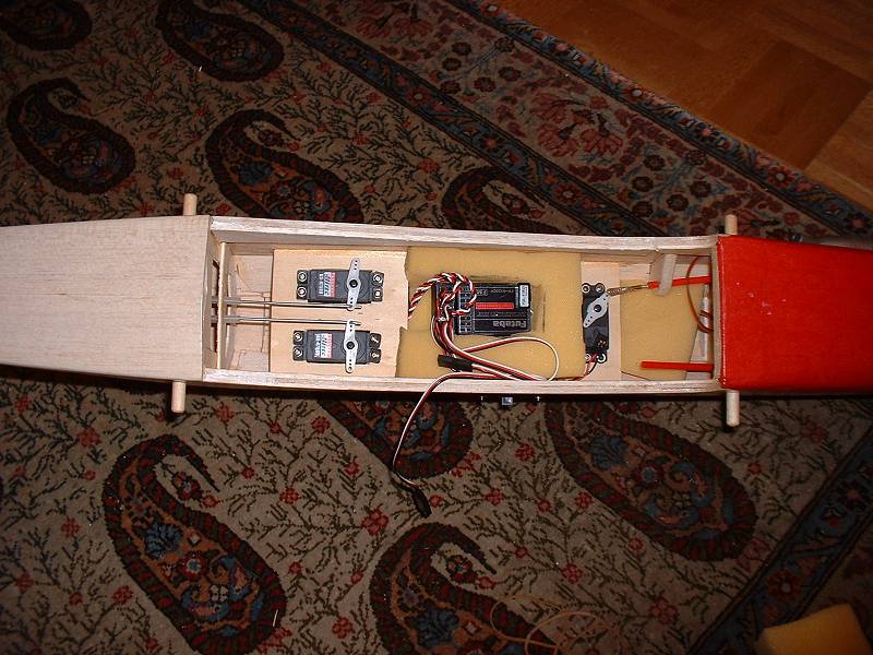

The majority of Leo's I see on the competition circuit when they where popular had two metal geared high touque mini servo's mounted at the rear, pic shows my Swallow that I converted in that way, much better linkage with no slop, and additionally helps with the weight of a four stroke up front.
Mike
