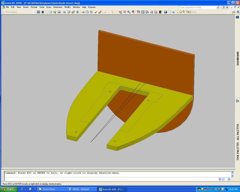

I need some help with my Element.
I want to use a hyde monut on this model. Does anybody has use Hyde mount and would like to share some pictures of the installation?
I have some ideas but, I am not sure if this will work.

Here is my idea before and after

Why not just grind out the horseshoe? Your mount will rotate some when the motor is running, not to mention the extra weight of the horseshoe. From what I've seen, it seems as though 6mm is the typical thickness for those, so you're adding a bunch of weight. I think you're overthinking and overcomplicating the problem.
Just food for thought.

I agree with Ryan,..I suggested this to another Element(wood arf version) owner. Just don't take all of it out,..you will still need the nose strenght for the sides.

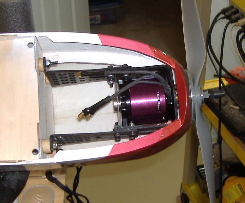

Bill's right. Here's a picture showing how much I cut out of mine to mount a Hacker. You can do this much without losing strength and have no problem mounting a radial soft mount in it.
