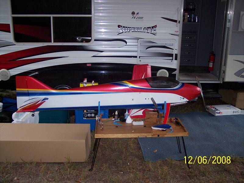

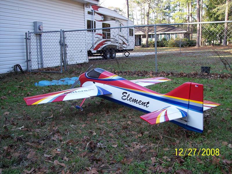

As promised photos, set-up and repairs.
I will continue to add more infromation,...flight reports,etc.
Best Regards,
Bill Holsten
Fliton Team Pilot

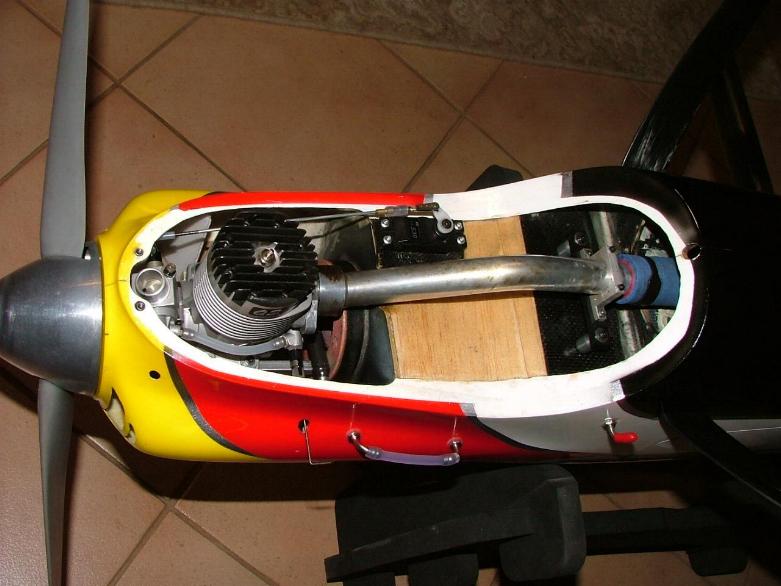

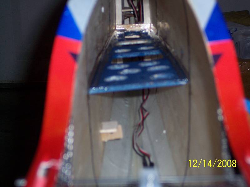

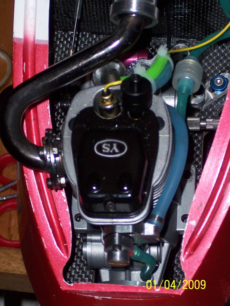

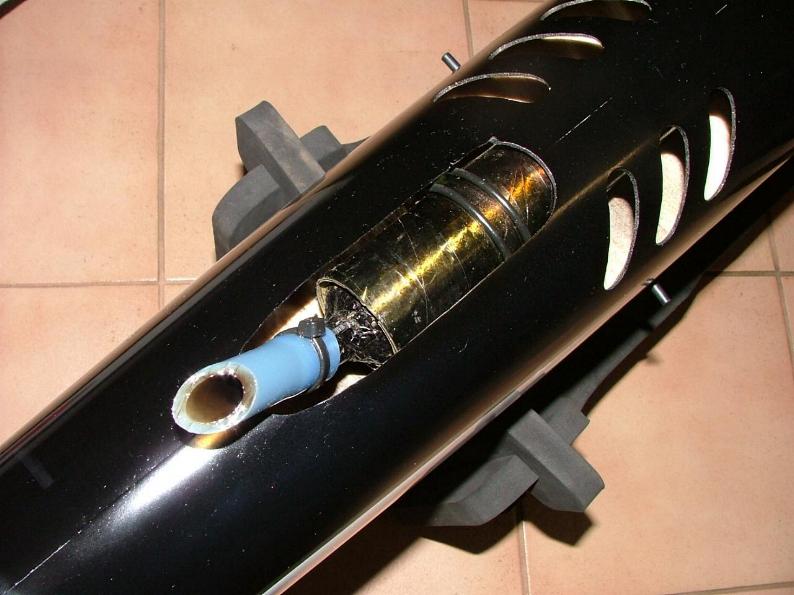

Here are some photos of the internal equipment set-up and placements.
Regards,
Bill Holsten
Team Fliton

Looks great Bill. Wish I could afford one of the composite Elements.. Lets see the inside now..
Chris

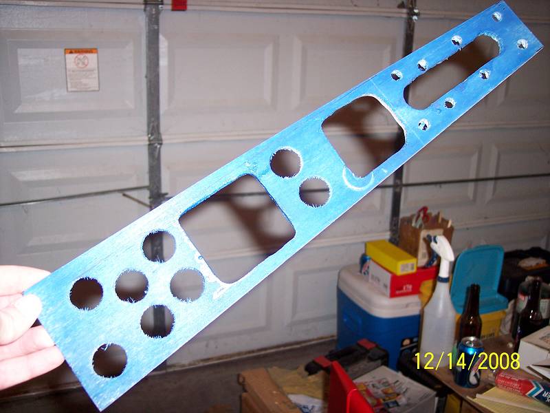

Here are some additions I made,..along with some repairs and new paint.
Regards,
Bill Holsten

The equipment,...............
Fliton Element composite 170:
Engine: YS-170DZ
Mount: YS super mount
Prop: APC 18.1x10W
Spinner: Great Planes 3 inch
Pipe&Header: Hatori 821 and 822
Servos:
Rudder: Futaba 9350
Wings: Futaba 9154's
Stabs: Futaba 9650's
Throttle: Futaba 3004
Transmitter: Futaba 9Z-WC2
Reciever: Futaba 149DP
Battery: TP-1100 Lipo
Futaba switch for digitals
Overall weight ready to fly:
10lbs 12 oz,..plenty of room to get lighter (battery, throttle servo, use the factory carbon gear).
Incidence:
Wings= 0
Stab=0
Engine=0
CG:
6.4 inches from the leading edge,...a slightly nose heavy start.
My apologies on the crutch I installed,...I was wearing a sweater and as I was tacking it in place with CA,..it was moved. The crutch was made out of 3/32 balsa, cross grained and lightened. The weight was less than half and ounce on the scale.
Flight report:
WOW! With room to improve and more comments to follow,.......
Best Regards,
Bill Holsten
Fliton Team Pilot

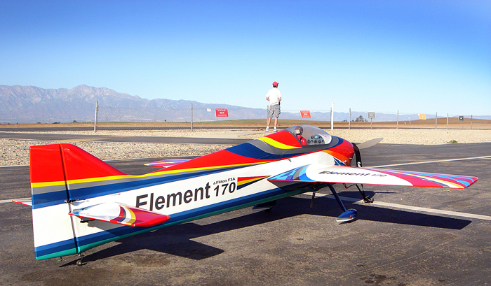

Hey, Bill
Where did you get the Plane Stand,is it theone that on RCU, under New Stand ?
The picture's were taking at the Pardo flying site in Chino, Ca, the Guy holding the Comp 170
is Tak, and I'm the one that's been flying Alex's plane.
We are putting together 2ea ARC that will be glassed and painted.
The fuse will have a DEP's system, no servo's in the stab.

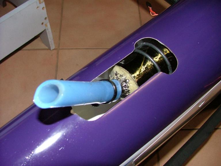

Hi Bill . .
Why couldn't a pipe tunnel floor be fitted, as in my Integral and Impact pics below ?? Wouldn't be too bigger jub I wouldn't think . .
The header would need clearance at the side of the fuse . . same as the YS but higher. Would probably need a clearance hole cut across the fuse and the chin cowl join, but no big deal (again, like my Integral).

Hey Jeff,
I is possible,..but I think with the AFR composite it would be alot of work in removing the servo tray, etc or adding a pipe tunnel floor. The other thing is,..where the chin cowl mates to the fuse is very narrow,..again,..not impossible. I would recommend the composite ARC, as nothing but the firewall/rail mount system is mount,..I believe? For the do it yourselfers out there that have the time, the ARC is a great option. These planes have many custom options upon request,...personalized color schemes, etc. The composites are special order only and built upon request,..these are not mass produced.
Hope that helped?

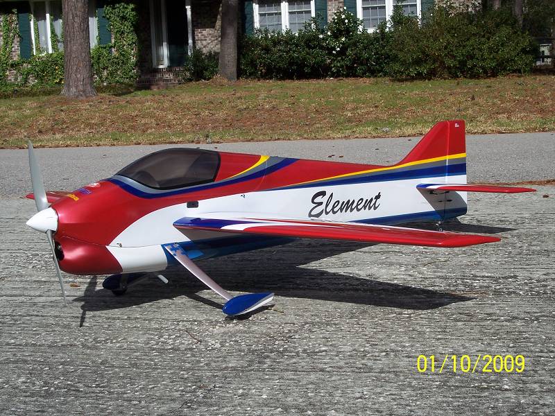

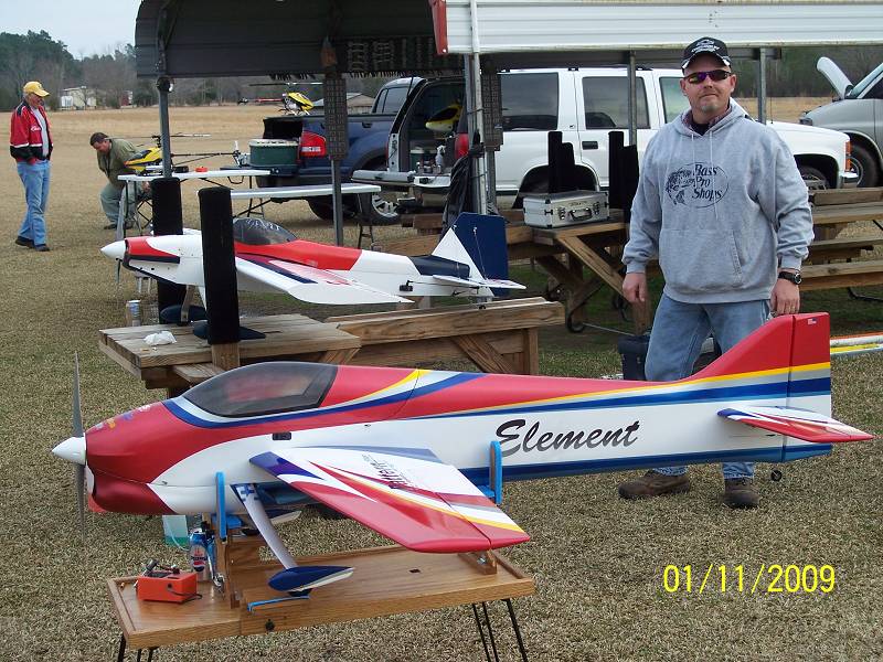

Some more photos
Regards,
Bill Holsten
Team Fliton
